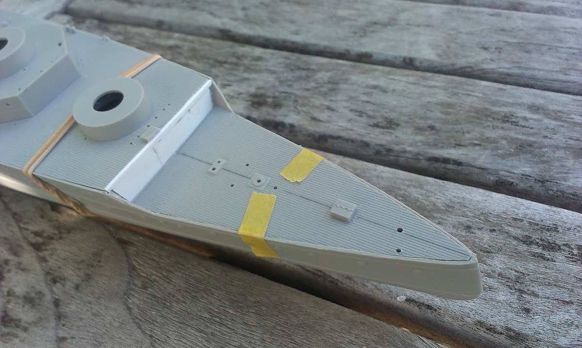

Since last weekend I have the kit too, and my objective is to turn it into HMS Suffolk. So here are my first results at the conversion.
The quarterdeck cut down was carried out much as I had envisaged before. The main hurdle is, after you have cut away the portions of the hull, to graft in a new rim to receive the modified quarterdeck. This is a tedious task, with knife, chisel and file, and must be carried out with care to have a good sit of the deck.
