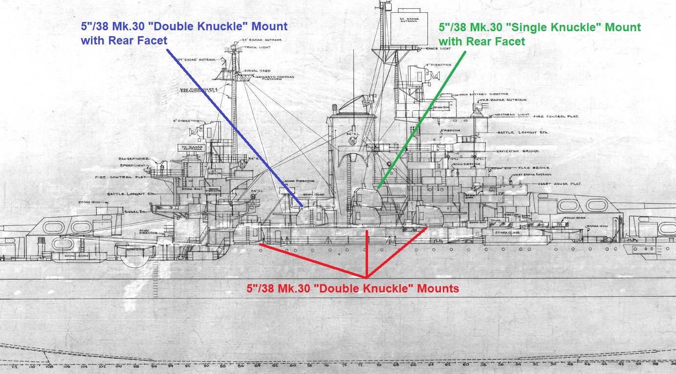

The Idaho's 45 refit, were the 5"/38 mk 30's single or double knuckle?
PostPosted: Tue Oct 12, 2021 11:14 pm
Joined: Sun Jun 26, 2016 12:10 pm
Posts: 160
Any height differences between the two? I'm comtemplating on getting the Idaho kit from iron shipwrights. Might be a while before info, though.
PostPosted: Wed Oct 13, 2021 9:01 am
Posts: 4038
Photos and plans indicate that three different types of 5"/38 mounts were installed, as David pointed out, a mix of double knuckle and single knuckle mounts. Notice that the gunhouses of 4 of them had the upper rear facet, similar to the kind of facets of mounts fit to destroyer escorts.
RG19AlphaIdaho208700-A_a_Levelled 5in38 Mount identification (2).jpg [ 431.79 KiB | Viewed 2509 times ]

What exactly is the upper rear facets? Is it the rectangular extensions on top of the turrets? Because I see them on all the secondary turrets.
PostPosted: Wed Oct 13, 2021 4:26 pm
Joined: Mon Jan 10, 2005 6:54 pm
Posts: 266
Location: Milwaukie, OR
Instead of the roof of the turret running straight to the back of the turret, there is another knuckle at the rear.
PostPosted: Wed Oct 13, 2021 6:07 pm
Posts: 1974
The back of the gunhouse roof has been beveled off to provide clearance for some obstruction. The upper mount was probably for clearing the back of the bridge, and the lower mount was beveled to clear the adjacent quad 40MM tub. On the DE's, the forward mount was beveled to allow the hedgehog to have sufficient clearance to fire directly forward over the mount, and the after one was beveled for standardization to speed construction. On the Idaho, as on the DD's, the "double knuckle" on the lower mounts was to provide extra strength to withstand the blast effect from the higher, superfiring mount.
PostPosted: Wed Oct 13, 2021 6:31 pm
Posts: 4038
The rectangular extension you see on the tops of the 5" mounts is the gun captain's blast hood. Below is a photo of a blast hood on a museum ship.
