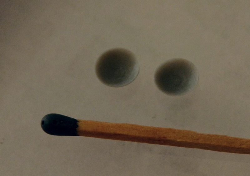

Anyway, the buttoms have much more interest than this. For these to be perfect, you will have to heat only the very tip of the rod, and the buttom will come by itself. Then, while it is hot, press against a hard surface, and you will have wheels, handles or flat bases for whatever you may need. Or wait until it cools off completely, and sand gently. You will get the very same thing.
You can also have lamps :
All kind of handles and supports :
Whip aerials are simply pieces of stretched sprue with a buttom at the base, one single piece each:
I use this technique en masse, as these are the easiest pieces to produce, and when painted and completely finished, the results can be surprisingly good. Have a look at a OHP/Santa Maria class frigate, Lee 1/300 :
Actually much better than PE, because PE lacks volume.
I hope this has been of some help too, and again best regards from Spain,
Willie.[/size]
