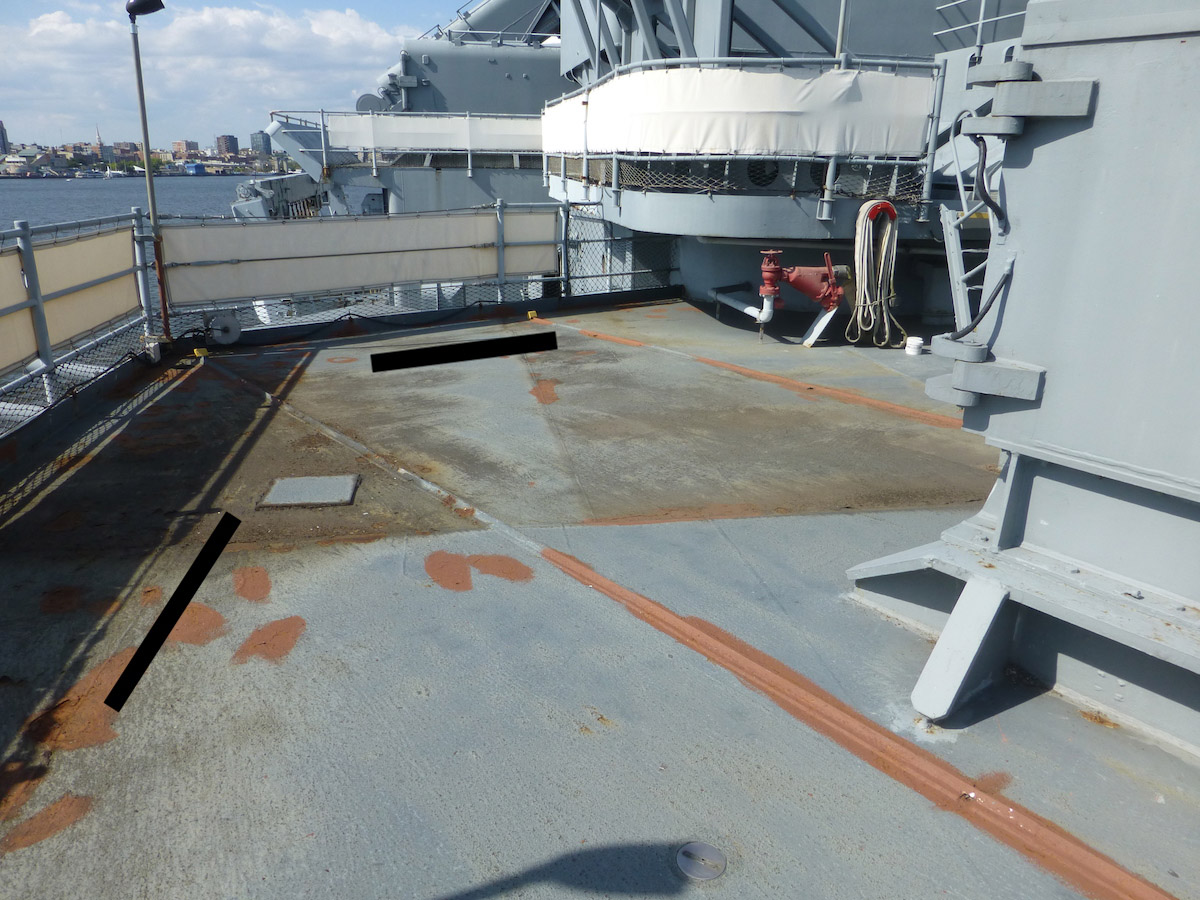

A discovery that may be of interest to modelers:
The aft missile platform at the 03 level was enlarged around 1985 add tracks for a gantry to load tomahawks into the ABLs. When recommissioned, the 03 platform extended to the width of the superstructure below. It overhangs the aft diagonal, Now the 02 platform extends beyond the superstructure and there are angled stanchions to support it.
I found a picture that shows the change. Unfortunately, at the file sizes permitted here it's more difficult to see. I have placed black bars inside the weld seams of the original deck. The side one is not hard to make out The forward seams is hard at this resolution.

Yes, as to the 03 overhang, this is correct, my scratch built 1:192 Missouri incorporates this as I built it mostly from the many hundreds of photos I took of the ship in Honolulu. The deck jogs outboard at this point. I was unaware of the earlier configuration.

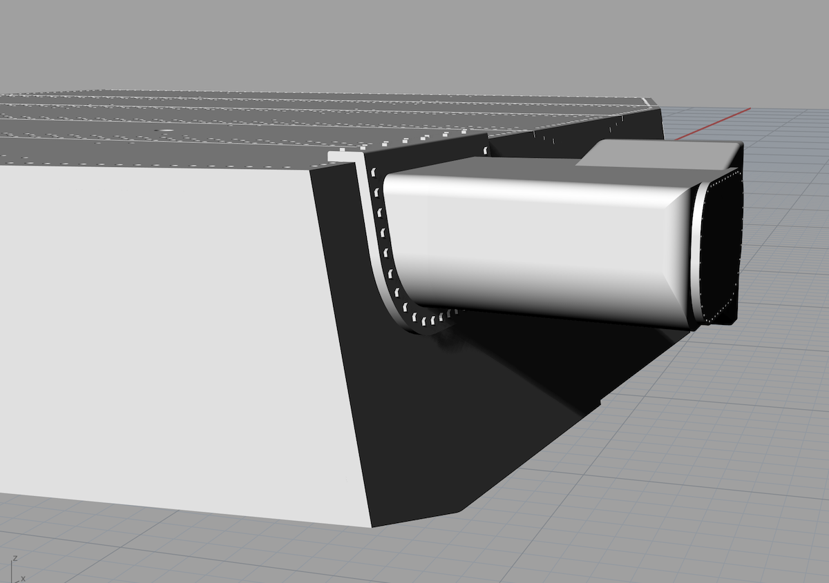

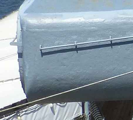

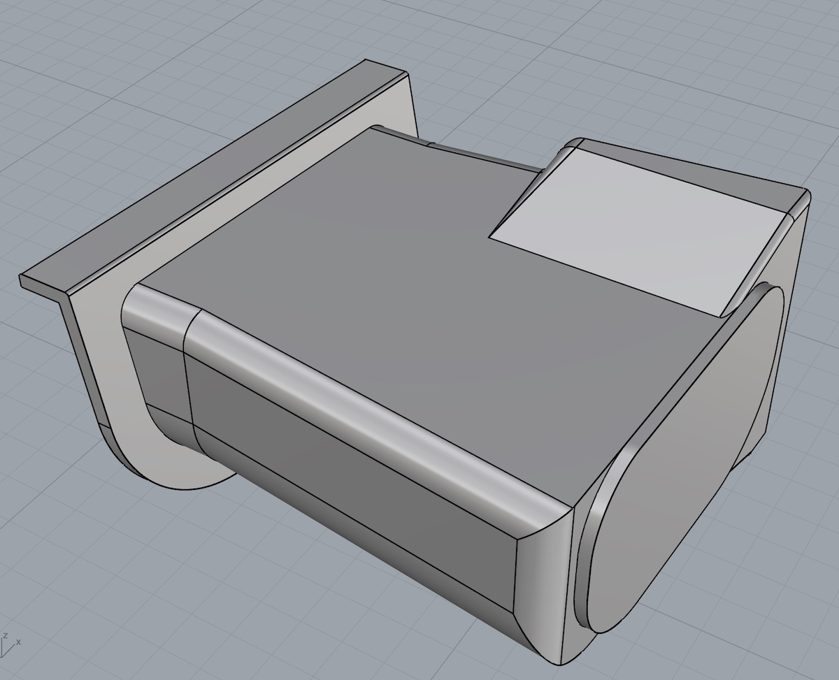

Turret Hoods
I thought I'd share a detail that I have seen wrong in most documentation; that is the turret hoods. I think one of the reasons is a lack of sources. The turret hoods are buried in the BuOrd plans; not BuShips.
Another issue is that the hoods were cast and look like the were cast in sand. The surfaces are rough and vary from the idealized design lines. Where the computer gives a crisp line the casting gives a more rounded seam.
This is a top view of an idealized version. All of the openings in the sides of the turret were cut normal to the centerline (ie not normal to the faces). The hood has to become normal to the centerline to fit into the opening.
The hood sticks into the opening (this model does not have the hood hollowed out):
The edges were designed with odd fillets. The fillet have different radii making it impossible for them to blend together smoothly. Instead, the fillets run into each other to create corners. Some of these corners are visible on hoods such as here. However, the casting process blurs the edges corners that you get in an idealized computer version.
I'll add one more image. Note that even in the rendering the back of the hood appears straight.

I would like to thank Jim Slade for his last post - one that's overdue in the Big Picture of Military Modeling. Let me explain:
In regards to certain implements of war, such as battleships, cruisers, battle tanks, etc. not everything is "satin smooth" and perfect as most industry model manufacturers would have us believe. Photos don't show it, artists haven't a clue, and unless you've personally been involved with these types of weapons (systems), you probably don't realize it either.
I can attest to the crude surface features of various items on battleships, tanks, and possibly even cruisers. These are the turret faces, sides, top, and rear surfaces, as well as the rangefinder hoods as Jim has pointed out. Also, the cast sections of the main barbette is a rough surfaced object which is welded into a solid unit but its texture is far from smooth. Tank turrets are also cast items and have the same surface features as I've described. Actually, if you think about it, there is no need for the expense of smoothing these surfaces as their size, weight, and density are what's important, not their surface finish.
So, how do you mold this into a modeling part? I guess most model manufacturers have never given this a thought, but the innovative modeler HAS...or perhaps should. When I was working on my NEW JERSEY project I several times toyed with the idea of actually covering the turret sides with a moderate to rough grit sand paper to give the turret surfaces the proper exterior finish that they should have. Actually, they each have about a 4"-6" smooth surface along each edge and then the metal becomes rough surfaced - even after coats of primer and paint, they feel and look pitted and coarse. This again, is true of the range finder hoods that Jim has described. In some cases I've seen these surfaces ground into almost parallel grooves and this is the way the part was assembled in its final configuration. Some WWII German battle tank turrets come to mind. Even the old Sherman Tank - its turret was a rough cast metal object, not a machined or ground smooth item.
If manufacturers were accurate in their representations of parts (esp. on the larger scale models - 1:48, 1:96, 1:125, even 1:144) I believe that they could with today's technology produce molds and dies that would reproduce these surface features that are currently missing from their final product. I don't know how a 3D printer would be able to handle this sort of mottled surface, but one can only guess.
Just one modeler's opinion...

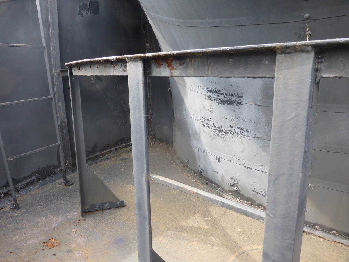

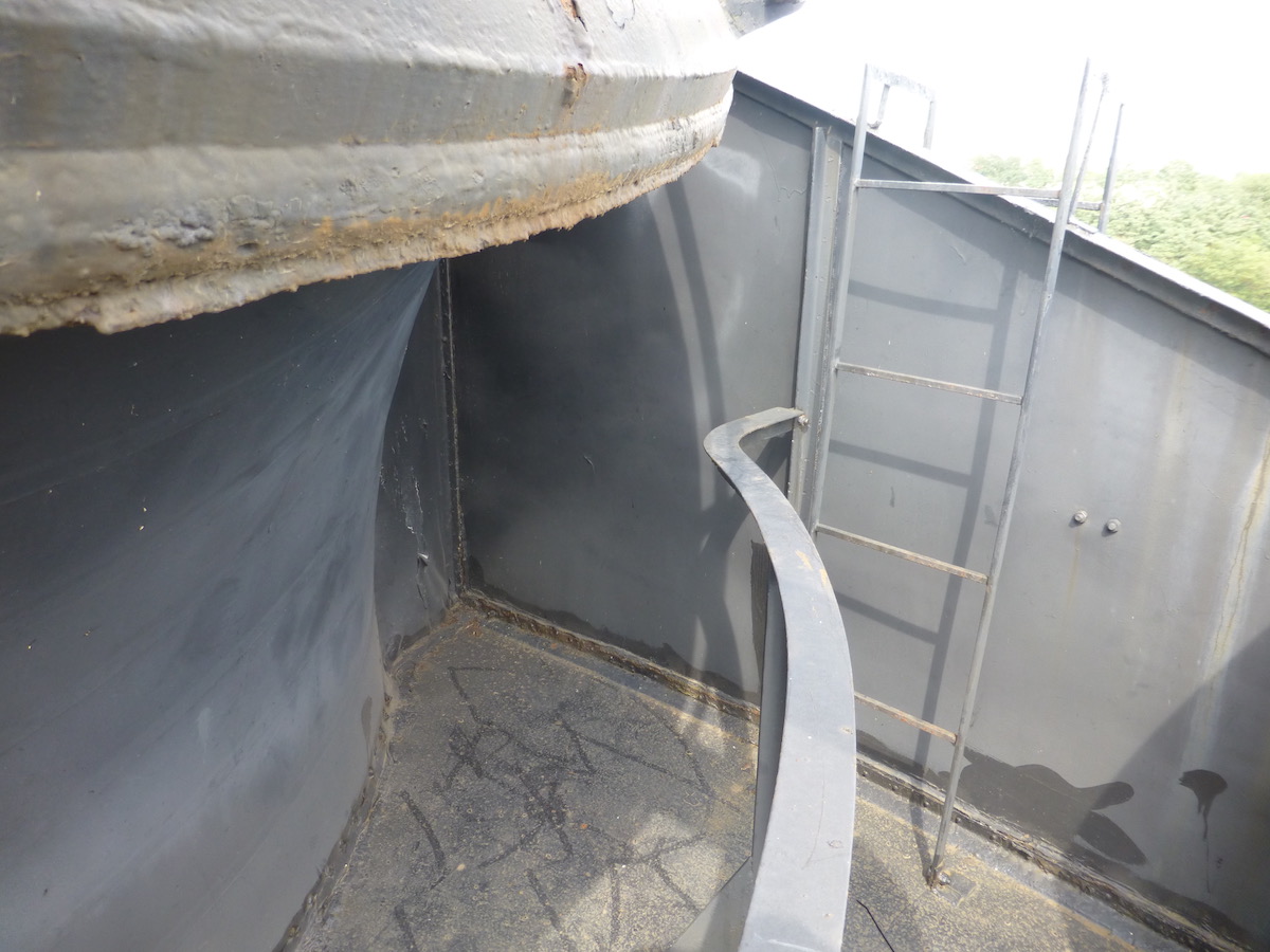

Funnel
Here's another detail where kits usually deviate. This is the top of the funnel. Notice the funnel slopes back, rather than going vertically. The rail apparently is to keep crewmen from accidentally touching the hot pipe. It's hard to get shots here because of the limited space.
