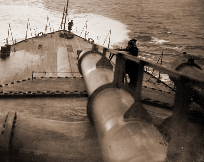

As for the mast itself, the tops of both masts were indeed retractable. As I recall, from talking to veterans, this was of course, to allow clearance under the Forth Bridge (and possibly others). I also seem to recall that the masts were generally left down (or somewhat lowered) when not at sea. When at sea, they were raised to increase range, etc. I also remember reading that the topmost yard was repositionable during her earliest years (That's just a vague recollection and I could be wrong. I really need to go back through my references on that one!).
Speaking of 1920, remember to align her rudder plate fore and aft (it wasn't angled until much later)...see the photo. Also in said photo is some detail for the barrel-mounted flying-off platform support struts (I recall you were looking for this earlier).

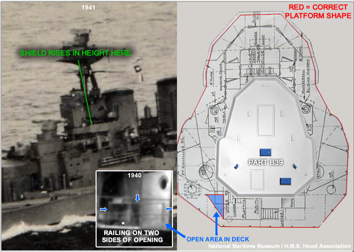

2. New "Find" - Apparently, there was a triangular opening in the port/rear area of Hood's Admirals Bridge platform in 1940/41. This was literally an area where there was no deck inboard the platform. To starboard it bordered against the port bulkhead of the Upper Tactical Plotting Room. Its two other edges were lined with short segments of guardrails. We see it in the 1940 bridge plans as well as in at least one photo from 1940. There's no indication that it was removed in her 1941 refit. As for what the opening was for...no clue. I only know that it was there.
Admittedly, this is pretty tiny on a smaller scale kit. So much so that most people can easily opt to ignore it. Its a little more noticeable in larger scales though, so detail-minded folks may wish to consider it. One could always cut out the opening and line it with photoetch rails. Alternatively, one could simulate the opening by painting a black triangle on deck and lining it with photoetch. Of course, one can also simply choose to ignore it entirely. I guess it all depends on the modeler's wishes and/or how far along they are into their builds.
We have updated our 1/350 and 1/200 Trumpeter articles accordingly: http://www.hmshood.com/hoodtoday/models ... ter350.htm & http://www.hmshood.com/hoodtoday/models ... ter200.htm
For those of you who don't want to wait, here is an updated photo link:

PostPosted: Wed Nov 27, 2019 3:31 pm
SovereignHobbies
SovereignHobbies
Posts: 1191
Interesting. It's "hidden in plain sight" on the plans:
Looking at the platforms above and below I'm also none the wiser why it was there. There's a 500 gallon fire water tank below it. Or was.

PostPosted: Wed Nov 27, 2019 6:57 pm
Joined: Thu Aug 04, 2005 2:50 pm
Posts: 342
Yes indeed… It’s been right there in front of our noses all along. I’d noticed that the platform was not entirely symmetrical but had missed that open bit. Of course, that’s the way it is with a lot of little details on Hood! They’re right there in our faces, but we don’t notice some of them until a new picture is found or someone new takes a fresh look, etc.
Anyway, I compared and contrasted the ‘40 plans with the ‘31 plans and see that that particular area was originally the rear edge of the platform. The earlier plan shows stanchions and a scuttle in the area. Interestingly a comparison of the two also shows something missing from the ‘40 plans: the door to the UTPR… It’s on the starboard side between the aft ladder and the porthole. Apparently the draughtsman forgot it.

PostPosted: Thu Nov 28, 2019 11:17 pm
Posts: 3383
Why leave a gaping hole in the middle of a platform?

PostPosted: Sun Dec 08, 2019 12:01 pm
Posts: 342
We don’t know, but we see evidence not only in the official plans but in at least one photo...so sensible or not, it was there. It’s not the only odd feature on Hood.
