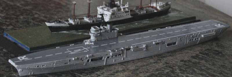

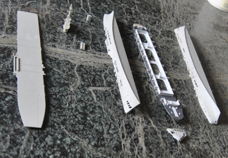

As we suddenly have an up-to-date injection molded Colossus kit around I think it is time to re activate the 'yard. I have run into serious trouble with my L'Arsenal Glory so I have ordered IHP's new Colossus as well as a 2 level enclosed bridge by Digital Sprue. The kit and the shapeways bridge arrived in a few days. First impressions are really positive. The raised hull detail is excellent and is a good reason to do her almost straight from the box at least once as the plastic surgery for the modernized ships will probably destroy all that detail. The main parts can be assembled without glue or filler though I may be using some of it later.

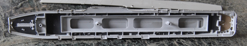

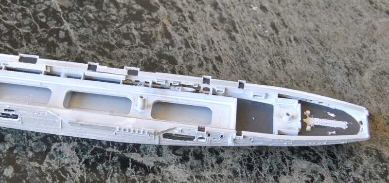

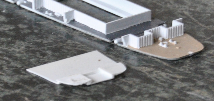

I have built and painted the gallery deck straight from the box. I did deviate from the instructions by choosing a lighter grey (1:2 vallejo light grey - vallejo white) for the vertical surfaces and 'planking' the quarterdeck in buff.
The gallery deck will need some styrene roofs and some vertical styrene sheet in order to make sure one does not look through the ships.

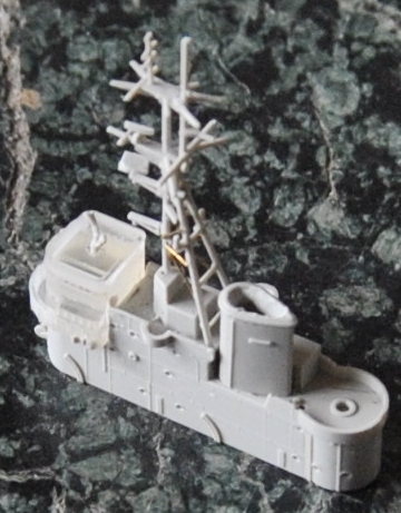

For my korean war HMS Glory the main changes will be to the island. I have glued in the very nice bridge from shapeways to the island structure and I have built the mast and platforms. This mast has some excellent engineering. It is much easier to do than Flyhawk tripod masts and had the carpet monster not taken the all important part C88 this would have been a quick build indeed. As it was I had to replace that part in .3mm brass. I also redid one of the platforms as it had a different radar in 1952.
Conclusion after about three days' work: very nice kit. Accurate according to my drawings of Colossus and Venerable. In terms of buildability it is closer to Bandai than to Flyhawk. I like that.

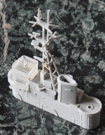

The island has its first paint on.

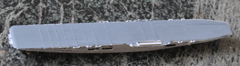

Some progress. I noticed that the flight deck on Korean was Colossus class carriers was much lighter than the other decks and that these flight decks were incredibly dirty. There is some nice color footage on youtube that can illustrate what I mean. I think they started out from the dockyards in the color scheme Mike gives us and they quickly bleached out. Note that the deck markings were carefully maintained, unlike the rest of the flight deck. So as a start I have painted the flight deck in tamiya XF-53.
The hull is has now been spray painted in gloss varnish so the decals can be put on. I will be painting, decalling and weathering the flight deck before I add any sponsons or any other detail to the hull. This will keep the carpet monster away as long as possible. I have also picked out the windows on the island by drybrushing. Will need some tweaking later but it is getting there.

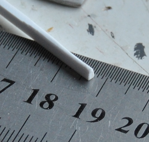

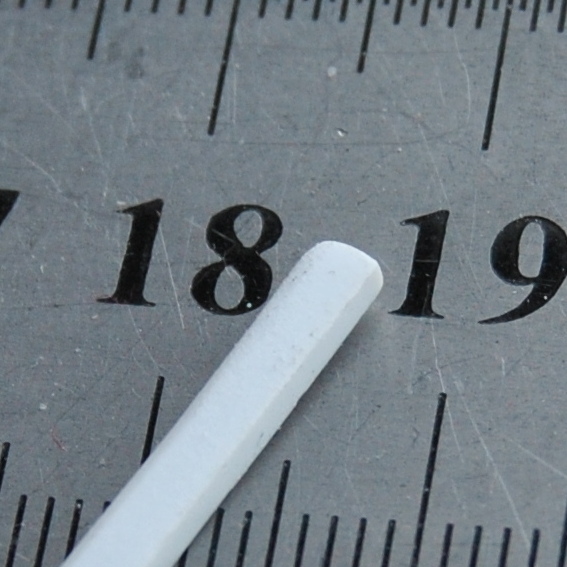

And now the fun part for the day. The youtube videos of HMS Glory mentioned earlier show some really nice footage of small streamlined deck tractors re-spotting airplanes. While I will not be doing that specific scene the deck does need some tractors. Some internet research came up with 'Clarkat B's with broadened wheel bases'. L'Arsenal gives you some tractors which are the right size (2.5mm in length) but not streamlined at all. So I decided to scratchbuild a few. I first sanded a strip of evergreen 8610 into a half-oval shape.
Using a small file I opened the 'driver seat'.
The tractor was removed from the strip using a micro saw.
And back wheels were added using.5mm brass. The front wheels are hidden under the front of the tractor.
So these are my prototypes. I think the right one came out best. I will be doing more of these.

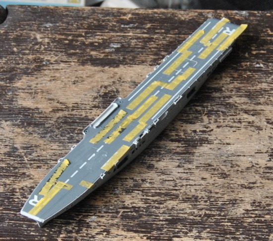

The yard has been smelling of paint lateley. Glory now has its decals on. As some of my old L'Arsenal decals broke apart when applying them you are looking at a combination of IHP, L'Arsenal and Aoshima decals.
Typical of Korean War era British carriers flight decks is the way they weathered. It looks like a combinations of multiple slightly different colored panels. The effect is most unlike the weathered stained wood of US carriers of the period.
In order to 'get' this effect I started with masking off panels on the deck while looking a pictures in order to get the pattern right.
These panels were brush painted in tamiya neutral grey with some drops of white added to it.
