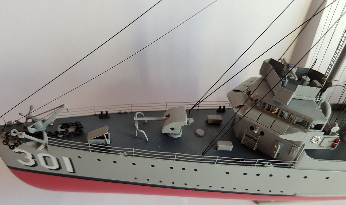

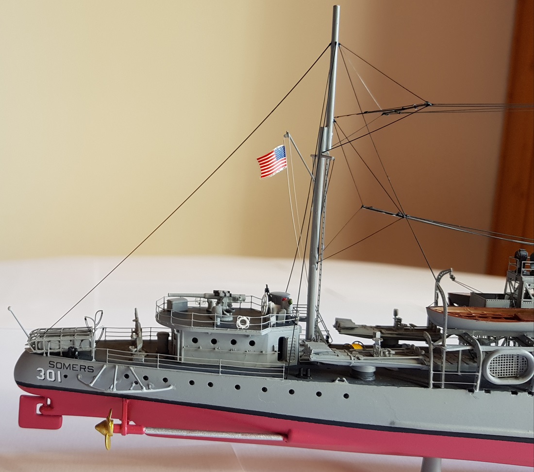

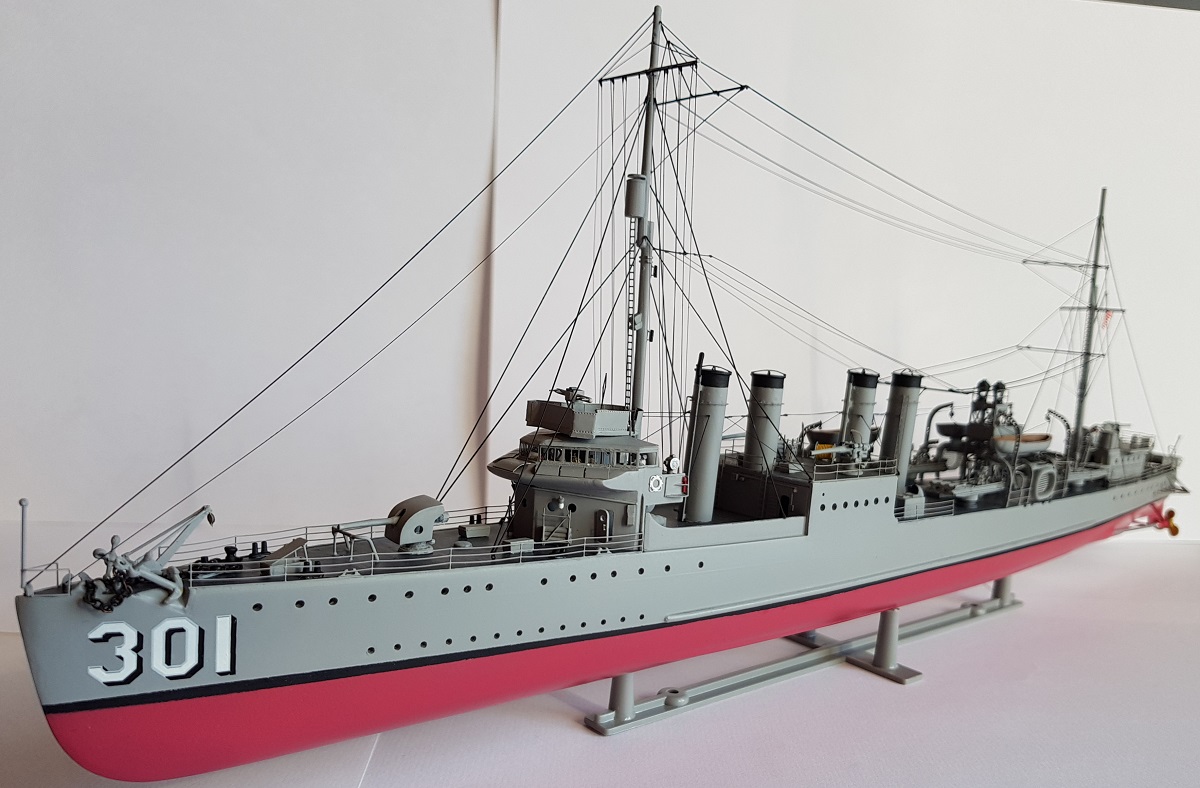

My revel 1/240 USS SOMERS is finished...thought it good to put pictures here...if you wanna see full build...
viewtopic.php?f=59&t=207229
For info as USS SOMERS was scraped 1930 I had to modify according my Campbeltown... I suppose it give a realistic view of the Clemson class between 1920 and 1930

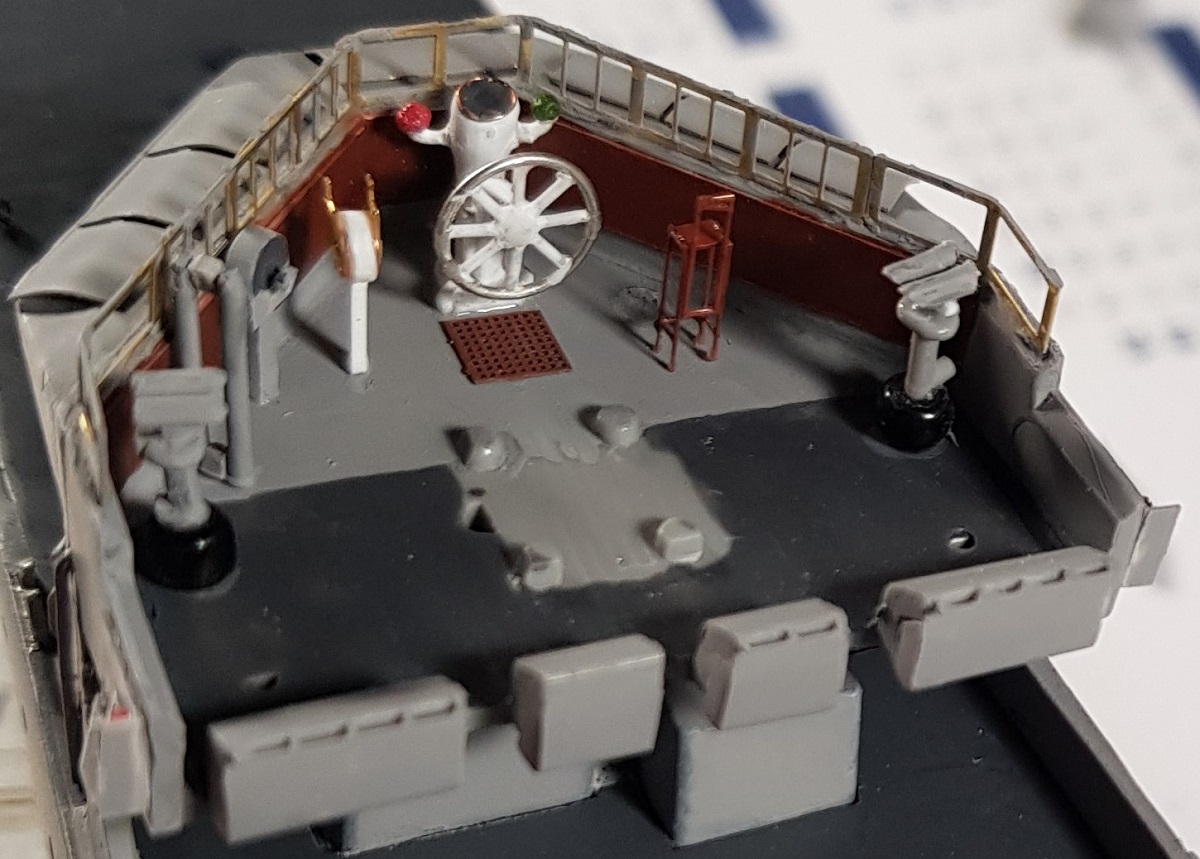

and a few more

That is certainly excellent work. Old tincan men would appreciate it, I'm sure.

2) On the nice bridge interior details: I think there was a blackboard attached to the bulkhead (port side, IIRC) showing basics like speed, course, etc.

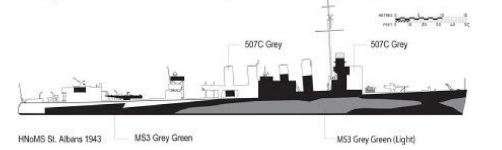

Looking for some help please, I intend to build the Mirage HMS St Albans as she was in 1943 when she was returned to the RN. The pictures in the two links from the IWM and U-boat net, look to be about the same time period. Compared to the kit the single gun tubs are in different locations and the anchor crane looks to have been removed also there is a boat on the portside, any information or best guess welcome. The two pictures that I found on the internet show a similar pattern to the kit instructions but the colours are much different, does anyone know what MS3 light would be, maybe a mix of white and MS3. Any help appreciated thank you Al.
https://www.iwm.org.uk/collections/item ... /205120692 , https://uboat.net/allies/warships/ship/5886.html

MS3 light is a figment of someone's imagination. The coloured illustration of the 1943 camouflage on St Albans and the book it came from is best ignored.
St Albans� 1943 camouflage design comes from CAFO 679/42 Plate 28. It appears that St Albans wore it first on emerging from her Falmouth refit in October 1942. It is obviously an Admiralty Dark Medium Type as per CAFO 2146/42. If applied by the book this would mean the paint colours at that time should have been 507A, B5 and MS4 as marked up on this photo:
