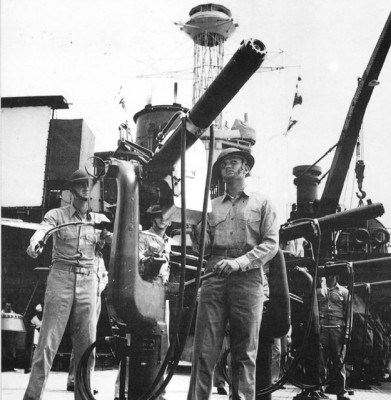

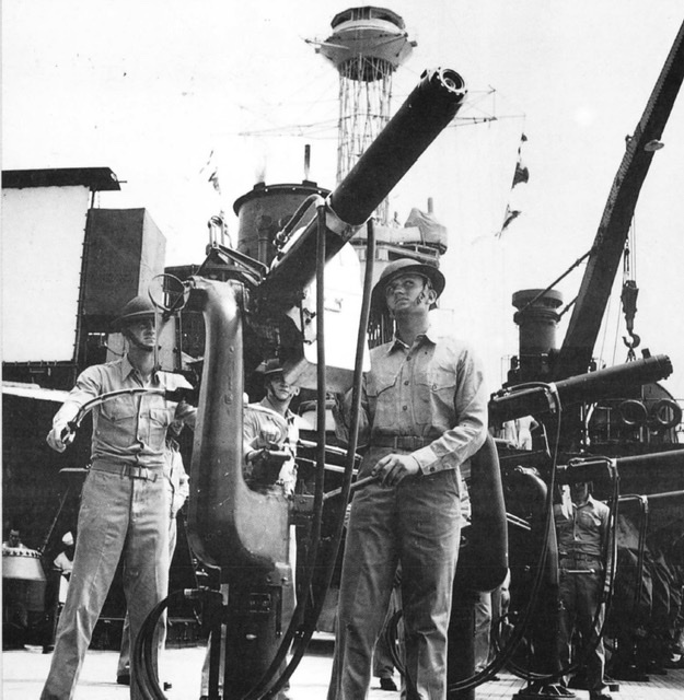

While I was looking at the above color photo, does it appear the forward superstructure is not on center line but to port?

I'm pretty sure the superstructure is centered. I think there are two things that make it look otherwise, and both can be confirmed in the subsequent black-and-white overhead shot:
The main thing is that up high you're seeing the crane that's only on the port side - its bulk blends in with the superstructure and makes it look lopsided to port. You're also seeing a splinter shield and extended platform at the midship deck level for open 5" mounts on the port side, whereas the starboard has enclosed mounts and open railings. Though the extra platform should make the port side look broader, I think the angle of the photo causes the darkness of shield and guns to look "bunched up" close to the tower, whereas the starboard side's openness and long continuity of clear wooden decking makes it look more open and spacious.
Now, there may also be some true asymmetrical features up in the tower, with directors and related platforms relevant to particular AA mounts. Again. look at Martin's overhead shot. Wyoming had quite the asymmetrical AA gun layout, and I'd expect training sailors on all those different types of weapons included the guys operating the directors and maintaining & calibrating them, and not just the gunners and loaders (Could be wrong... is classroom and simulator training adequate for AA director operators and maintenance crewmen?)
