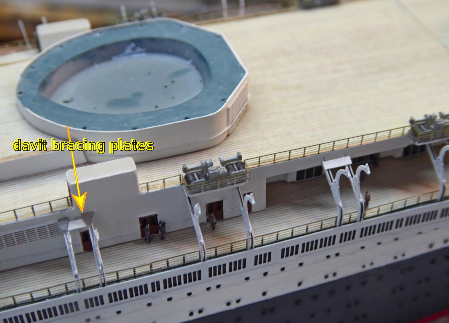

in the meantime - all of the Port-side davits have now been completed and installed--more or less satisfactorily... :cool_2:
All the winches have been installed now to the empty winch platforms
the winches differed slightly in design ( and size) from aft to fwd --so they were cut and re-joined to suit
The three aftermost winches had a platform over the drums - which I will probably cut of paper.
Frustratingly-- the plans that ostensibly speaketh the truth.....--are in parts an amalgam of pre and post refit (!)
and have some notable omissions-- a few I only noticed later of course..!
herewith an example:
The real thing....
The plan....
The model...
as such--and after closer re-re examination of photos versus plans I added the pair of plates fwd as well!!!

This image " clearly " shows the fwd portion of the aft dummy funnel deck to be a dark colour- probably dark grey/ black
another 'confirmatory' image thereof--
this angled view ( I guess confirm ?!) what on the plans...(?!! ) but darker fwd-
(though the image had been lightened and colourised)
which also shows the need to add the diagonal bracing inside the funnel
so the fwd skylights--based on the plans dimensions
made from generic perforated beam PE I had from another model..)( Northstar )
I used thinned matt varnish on a sliver of black paper to
practise aligning the bits of PE- I had quite a few attempts-- tricky!
Once painted and inside the funnel ( a few short hours later....!!! )
It all started to look a bit better--
interesting to note how different t looks with differing light levels
meanwhile the other two funnels had the small gaps
( in scale --quite huge actually !! )
' twixt uptake and PE filled with white glue
ah well !
more soon
JIM B
