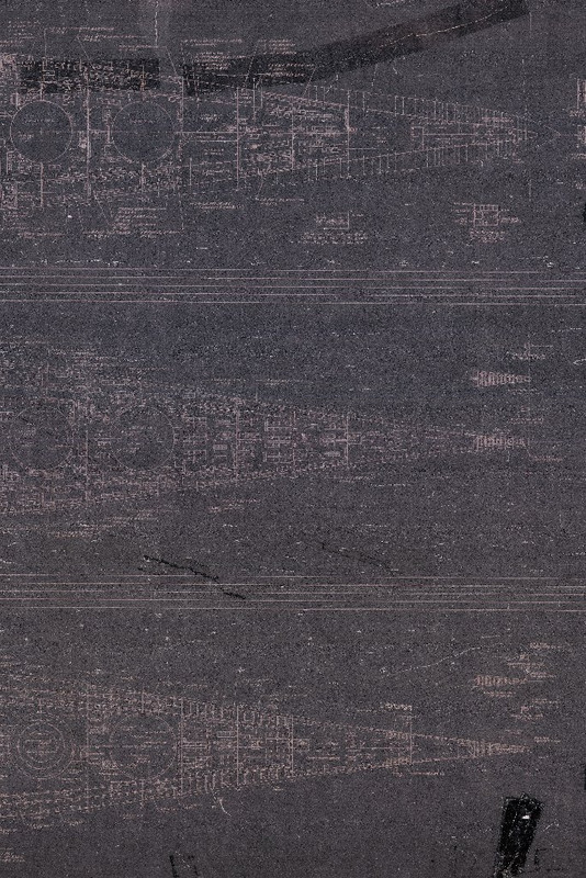

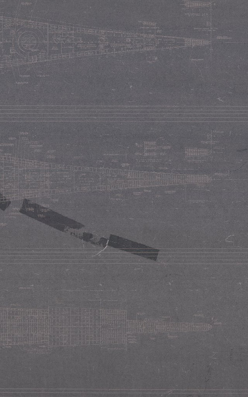

Ok, now I am confused... :eyes_spinning:
. Now, some folks reference the Floating Drydock's Plans as including a bow extension for the CB-2 Guam. I unfortunatley do not own a set of these drawings to see what that looks like. I was however going through my archive and discovered this in there, I didn't even realize I had this till I was going back through my files. It looks like the Culprit for all of this confusion-
Cropped-
This clearly shows the unusual stem shape, and it lists it for both CB-1 and 2
Now, Alaska did not have this feature at her launch and the blueprints dated 1946 do not show this feature. It is possible it was not installed as even though it's purpose is not stated anywhere, it would seem like a lot of work to remove just a couple of years later. Then that brings us to this-
The same data sheet for the Hawaii, which clearly shows it not being there but the rake of the stem seem to now incorporate it.

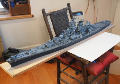

Current progress on Alaska. Mainly replacement with improved bits and pieces since I have gotten into 3D printing. Replaced commercial parts with my own: Mk37 directors and Radar, twin 5" mounts, MK 51& 52 directors, all superstructure rails, 36" searchlights and platforms, various ready boxes, vertical ladders and details other items I have forgotten.

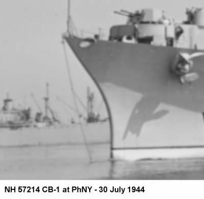

Going back to the "stem extension" topic:
Photos of ALASKA as commissioned (and during the first shakedown cruise) show the original stem (without extension) -- the profile of this stem is what I would argue is the "classic" profile we all
associate with these ships.
Original: https://www.history.navy.mil/content/hi ... 57214.html

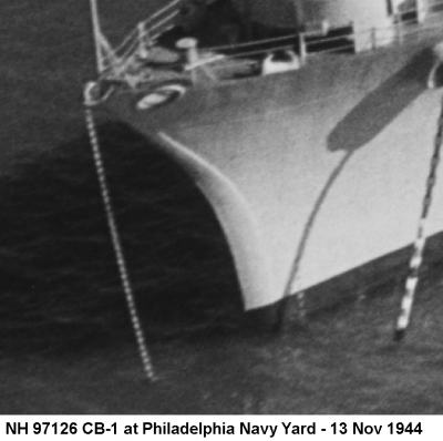

However, the photos taken after the October/November refit at the Philadelphia Navy Yard clearly show alterations to the ship's stem that line up with the plans previously found. Photo NH 97126 (a fantastic and sharp overhead view) shows the stem extension very clearly with the seams between the shell plating visible because of the unique lighting angle of the shot:
Original: https://www.history.navy.mil/content/hi ... 97126.html

It seems to me like GUAM launched with the stem extension and ALASKA received the stem extension at the Philadelphia Navy Yard during the fall 1944 refit. Unfortunately I have not been able to locate any drydock photos of either of these ships to confirm firsthand.
Obviously, none of this answers the rather perplexing question of "why" a stem extension was required, but hopefully this sheds some light on the questions earlier in the thread. :)
