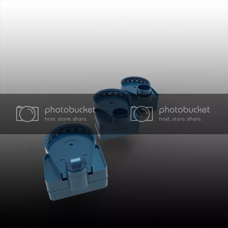

Tu11iy
Posts: 17
Joined: Tue Jul 14, 2020 12:42 pm
Post by Tu11iy »
Hello to all you comrades Fletcher-class fans.
I am a modeller from Russia. My best friend is currently building a model of USS Black DD-666. He is in desperate need of good pictures of this ship's rear Bofors shelter.
If you have it and can share, my friend and I would be most grateful. Info in text form is also welcome.
Essentially, the question is which type out of the three in the picture was on USS Black as of late war and before modernization and are there any additional things attached on the outside.
Thanks in advance.
Posts: 3880
Post by Rick E Davis »
USS BLACK (DD-666) was a Federal-Built unit. She was updated to the five twin 40-mm mounts configuration in mid-1943 and stayed in that basic configuration throughout WWII. Her last wartime overhaul was completed in February 1945.
The first three images below show her configuration in September 1943, February 1945, and in 1951 as she was recommissioned for the Korean War. When she was initially recommissioned, she was in the exact same configuration as she decommissioned at the end of WWII after her February 1945 overhaul, with only a few changes made. I selected these three images because two provide aerial views of this area and the third shows her configuration in February 1945 as her overhaul completed. Many other images of USS BLACK are profile views and are difficult to see the aft twin 40-mm mount configuration.
Of your three "options" for the aft twin 40-mm mount configuration, USS BLACK wasn't equipped with the Mk 49 director as seen in the closest image and of the other two images, they are basically the same except for a surround for the Mk 51 director. From the images I have posted, you can see that she has a surround for the Mk 51 in September 1943 which would have been the same to the end of 1944 prior to her overhaul. See the first image. When USS BLACK finished her February 1945 overhaul, she had an elevated platform for the aft Mk 51 director, with a pipe railing surround that may or may not have been canvas covered. See the second image. However, after her February 1945 overhaul, she had a bulwark surround installed around the Mk 51 director, plus an extension added on the portside only for additional controls. The extension is an "L-shaped" bulwark open at the aft end with controls mounted on the inside (in 1/700 or 1/350 scale this would be minor details). I wish I had a dead overhead view of this area to show the shape and arrangement better, but I don't. This mod was done on only a few FLETCHERS in the early 1945 timeframe, in the forward areas. See the third image.
I have another image of a similarly modified sister, this destroyer has an additional panel higher than on USS BLACK, ID isn't certain, but likely is USS STEMBEL (DD-644). See the fourth image.
Depending on when you want to model USS BLACK, would determine which configuration you would build your model to.
