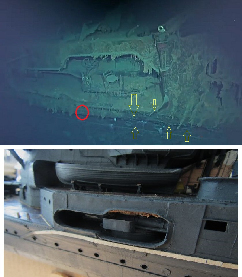

SilverGhost wrote:
Mutsuo Sasaki wrote:
1) I think you gentlemen are probably forgetting about the blast impact of torpdedoes on the starboard side hull by Fujjinami.Will the degausssing cable remain then? I shouldn´t think so.
If cable ripped off from starboard as the result of blast impact of torpdedoes (on the starboard side hull by Fujjinami). Why cable ripped off from portside?
The torpedoes hit only to starboard. Or not?
I bet destroyer Fujinami sent several torpedoes to scuttle Chokai, was the starboard only, to make sure she sinks to the bottom quickly.
We can see Chokai received a bomg or a shell hit,too at the portside stern. Highly probably both the cable and the cover got blown off by this. It would be difficult for the cable to withstand enormous water pressure by it around this section.
Can also see some coiled wires are ripped open at the portside,and remaining. Battle damage under the air raid will be the cause or what else.
I came across probably a misleading image of R/V Petrel when released last year.
My first impression was that the shape of bow did not look like that of Takao class.
Ofc the tip of the bow is stuck into the sand bottom.The degaussing cable is also in the sand.
cheers,
I think, here may be 2 variants at Maya:
1. The degaussing cable is also in the sand
2. The degaussing cable were removed during modernization
For example, if the cable was located at Maya's bow like Chokai and Atago, then we would see the remains of cable on the Maya's bow at the photo from the sea depth.
But I don't know how really cable was located at Takao's bow.
There is a possibility that on the bow of the sisterships there were 2 options for the location of the cable (Like 2 options of pattern of linoleum deck stripes (Maya&Takao vs Atago&Chokai)). This is just my guess and so far they have no reliable arguments. Skulsky drew a cable on Takao's bow in his drawings at Anatomy and Kagero 3D, not like in the photo of Chokai.
Andrew
Some elements of importance were taken into considerations yesterday night.
Hiragana letters of the ship name are 50 cm below the deck. Size of the letters are : 60cm tall.
The wedge line of the outer hull plate is 150cm below the deck.
The streak circled with orange color is a natural phenomenon? or artificially made?
The cable with cover might have been layed here, and it conincides with the line of this white streak.
Maya´s degaussing cable will be like this;therefore it is impossible to see the cable in the photo of the midter section of the hull. I should think that the cable ´s not being visible does not follow that there´s no cable attached to the hull.
cheers,
I think the streak circled with orange color is the top edge of outer plate.
I agree with you, that Maya's cable was located in middle lower than at Chokai. This is noticeable at the photo after the damage in January 1943.
hi again.'
The wedge line of the outer plate is 1,5 meter from the upper deck level. The whitish streak lies ca. 1,2meter from the upper deck leve. That´s 30 cm too high as it´s wedge line, is my view.
The cable of 9 coiled wire being 25 cm wide, then comes thickness of the cover material + margins. Fyi,the diagram from cruiser Tone,1940.
mucho
mucho,
The close bomb rupture on the port side of the stern explains jamming of the rudders and possibly a breakdown of the cable from the portside near sterm.
hi again.'
mucho
If look at other wedge lines at hull - they looks like that whitish streak at stern.
sludge that settles on all horizontal and protruding surfaces makes them light or white
These 4 cruisers were made by 4 different shipyards. So they can have some differences. I would not be surprised if the hull theory, the size of the sheathing sheets could vary depending on the shipyard
For example - Takao had another shape of anchor hawse unlike other ships - Maya, Chokai, Atago.

The show must go on; ;D If one can spot tiny biss holes of the cable stoppers,it accounts for the presence of the cable before it gets blown off at the time of the air raid and the scuttling by Fujinami´s torpedoes(Chokai) And the mystery will be solved.
cheers,
mucho,

A surviving crew´s story has it that IJN changed numbers of bisses of degaussing cable holders from 2 to 4, since the cable +cover was vulnerable to ocean wave esp at high sea. They had to install anew after a voyage.
Chokai will not be an exception.
cheers,
mucho

hi,
Am about to revise my thoughts about Chokai. As a matter of fact the so-called the top wedge-line of the patches of steel is hiden behind the cable cover, and quite invisible. It will be the cable cover itself.
Another decisive thing is ,the 9x coiled wires are seen ruptured and epxposed. (the nr.1 torpedoe area) Fom this it is understood that the cover keeps it´s form partially at the portside here.
The top wedge line of the patches becomes invisible on the model,too. Can´t do it otherwise.
Obviously IJN changed the cover material to another one, as compared with the year 1942 period.
cheers,
mucho,

And as to how to circumvent the catapult supporting trunk will be probably like this. Probably.
mucho

The very last, maybei
This may fit in with each other: I should think this is the very cable with the cover, but not the wedge of the steel patch. It is behind of the cable,therefore unseen.
When the above will follow, Fujinami must have sent torpedoes to the hull of the bow section where the deg. cable is now gone.
Don´t fancy doing this to the area where "souls" of the fallen crews still dwell in,and for good.
Battle report of the scuttling order of Chokai by Fujinami says about the action only, not mentioning how many torps were used to sink Chokai.
cheers,
mucho
