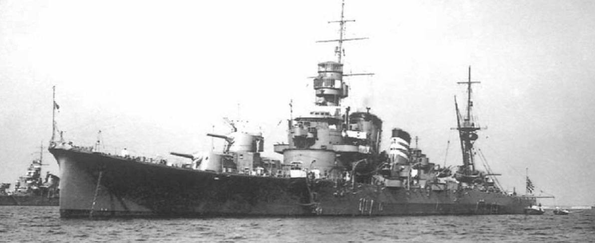

These are two of my favorite pictures of the Kako and Furutaka in their original configuration.
