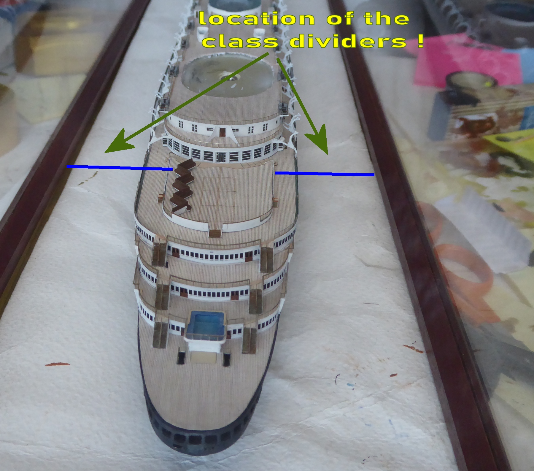

Meanwhile; On the Nomandie there was strict segregation of access for first and second class....(!)
as such various areas of the outer decks had wooden barriers -or dividers --these inhibited both access and view
In this view can be detected that the panels in the window sections may have been removable
or could be rotated around a vertical central pivot

To gain solidity and relief for the panel outlines I used white glue to ' fill' the apertures :cool_2:
The position of the dividers can only be found once the zig zag seating is in place .... !

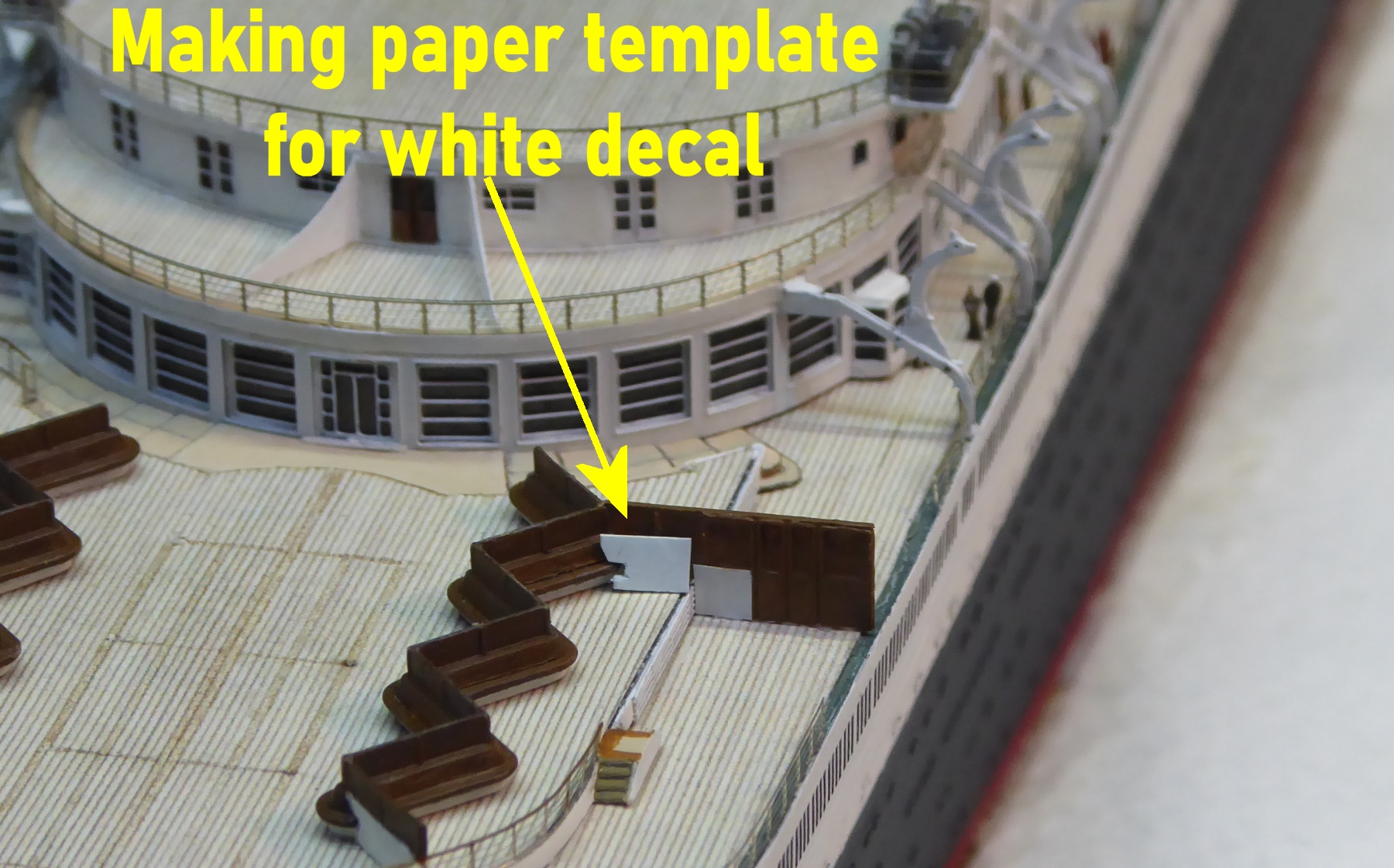

what however is noteworthy is that the PE class-divider-screens were not quite perfect,
being a bit too short when the seats were installed in the correct position
hence renewed cutting and adjustments in situ !!
so as to get sharper demarcation between wood and white on this tiny panelling
I used white Decal sheet for the white portions
==> but first had to make some templates in paper

meanwhile-- I had previously noted that the aftermost 3 x winch platforms were different from the remaining fwd ones,
having a grating platform over the drums
from above
and from the side ( I will add the-still-missing side hand rails to the edge of the grating much later in the build-very exposed and vulnerable! )
the arrowed cut away railings gave me a few heart stopping moments--as I needed to cut away the railings- in situ..!
but in the end it was OK ....
I made the platforms of old1/700 PE WEM Askold Torpedo net shelving
cut and painted- 12 needed--but cut lost extra -with numerous spares
these were placed on the drums using matt varnish as the adhesive
The sloping steps from the first class section ahead of the zig zag steps
had a curved, gently sloping handrail,==> to replicate this gentle incline was tricky
usual stairways are around 45 deg ,-- these are nearer 10 deg
Dedicated PE would have been the way ahead ( I should have planned for this as well I reckon...! :Mad_6: )
The real thing had 3 horizontals, I was unable to successfully drag the delicate PE rail out without distotion or destruction,
suffering non-stop endless repeated failures in my attempts to do so....
made me resort to using some matching railing with 2 horizontals to try and get an effect
( and this was hard enough!!! )
With the bottom rail cut away to leave just the naked stanchions,
this was gently curved to follow the curvature of teh steps
Alas the ( un-natural ) metal distortions can be readily seen in close-up !!!
and yet -- despite all the above--- once installed on the model it looks acceptable I think
Lastly for this up-date --to make me feel that "we " are moving forward towards completion of this behemoth build!
--I installed the last missing sections of the boat deck railing
and added the triangular gussets ( just visible in some images )
-- The class divider barriers acted much like a Barn-door at 30 knots, the air resistance must have been considerable !
So they required some supportive bracing--on the aft face only
more soon--
