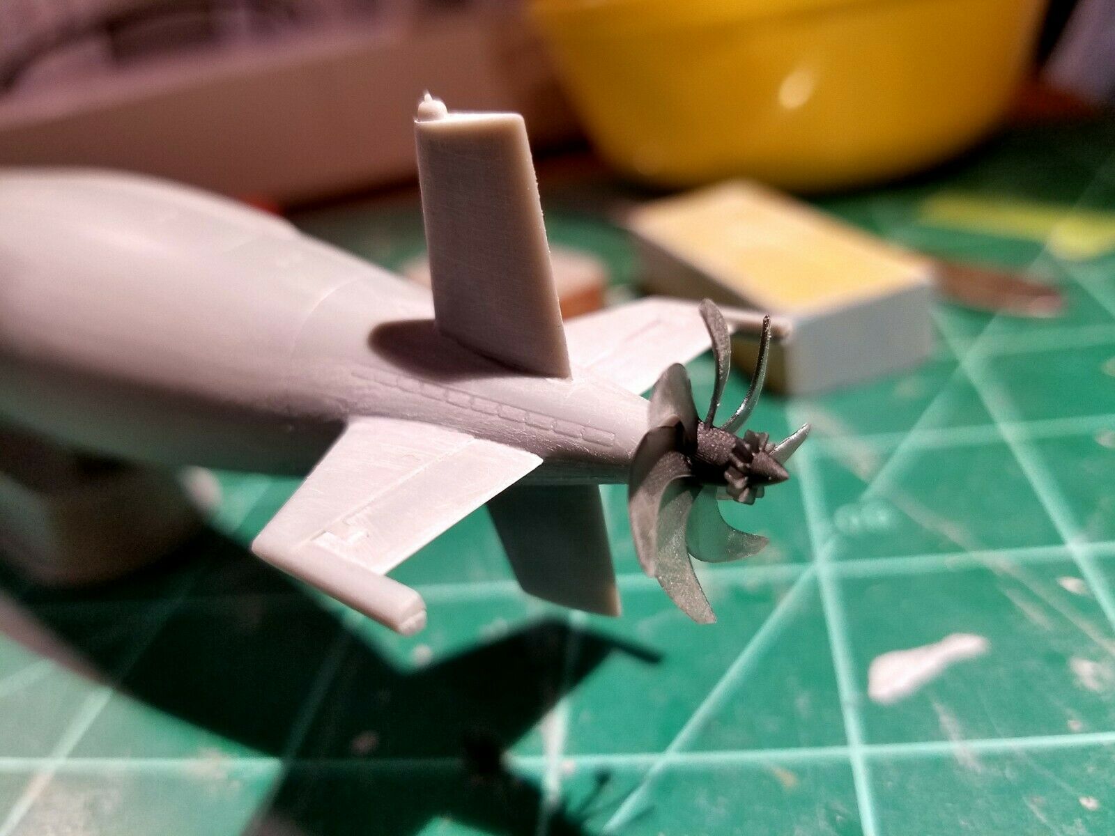

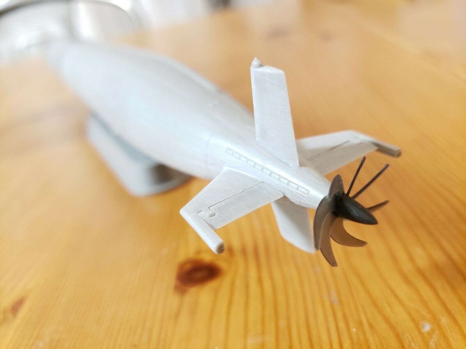

Can anyone identify which screw configuration is correct for USS Minneapolis-St Paul SSN-708?
I'd like to model her. There are some very nice 3D-printed screws available in 1/350 scale for 688I boats (and others) from vendor "mulsannemike" (photos below). He offers:
- 7-bladed scythe screw with vortex attenuator
- 7-bladed scythe screw, early (no vortex attentuator)
- 7-bladed screw with annular ring
I'd like to choose the most correct screw for M-SP, if available.
TIA.
Disclaimer: I have no relationship with mulsannemike.

Hi Steve,
I cannot tell which configuration would be correct for the 708 Minneapolis/St. Paul. But the three examples you show are lacking one important feature: the 'scythe' blades lack the twist from root to tip. At first glance I even thought these were flat PE blades. Disappointing, as the dome and the noise attenuators look very nice.
For exactly this reason I created resin LA screws several years ago, avaialable now from Naval Models. These definitely have the blade twist (but not the super nice noise attenuators, I must admit that!) So if you need 'perfect' screws I think you could best combine them.
(Note: 'scythe' blades is a clear laymans description, but the technical term is 'skewback'. EJ Foeth pointed that out to me and I trust him, he earns his professional money in these matters...)

Here are the 688 propellers and which submarines they can be used on:
I3B - SSN 688-720
I3M - SSN 688-725, 750-765, 767-770
LAH - SSN 751-765, 767-770
IPMP/MOD25 - SSN 766, 771-773
The I3B and I3M are your classic skewed propellers (skewback is an ok term, but I think still slightly colloquial). The I3B is the original 688 propeller, and the I3M is quite similar. I suspect the difference is either that the I3M has improved blade tip geometry or it can mount the hub vortex diffuser.
The LAH and IPMP propellers are both "hybrids" (i.e. ringed or annular propellers; designed for acoustic reasons, not for ice protection) and the difference is probably in the different shaft size of the IPMP boats (SSN 766, 771-773) and possibly different max shaft RPM because those boats had different propulsion machinery than all other 688s.
If you are modeling the 708 nearer to when she was commissioned, I would use a propeller with a plain boss. If you are modeling her nearer to when she was decommissioned, I would use a propeller with the hub vortex diffuser. Hope this helps!

Thanks very much, fellas. That helps a lot!
