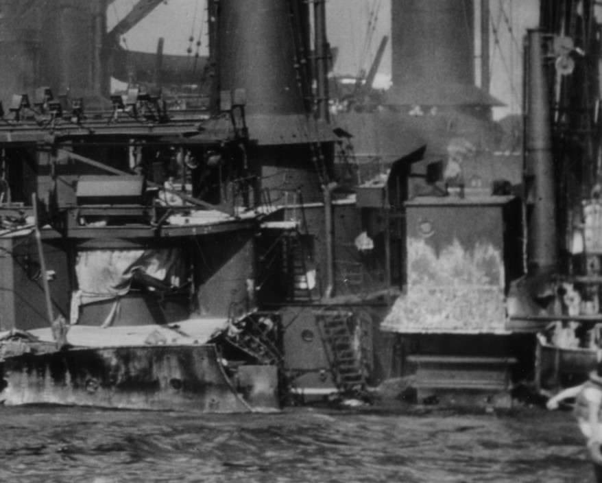

Does anyone know if this lower signal compartment existed, or was added to California and Tennessee by 1941? I think not, but the photo record is a bit indistinct. Had to use the FS graphic to illustrate.

"Bump" on my last question.
I've found a 1937 photo of California with what looks like lockers of some sort back there, but this not the same platform as with the Colorados. It's also not 1941.

Here's a shot of WeeVee, post-attack. There certainly looks like there is "something" there. You can see someone standing on what appears to be a platform even with the main deck.
All the shots I have of CA this day don't really show this area.
Posts: 8543
Re: Calling all Pre-war "Big 5" (TN/CO class) fans
Here is a better photo of that area on WeeVee.
Posts: 9052
Post by Dan K »
Thx so much, Martin. WeeVee isn't really the question, as her 1941 plans show that platform as seen in the Five Star photo. I'm assuming that MD and CO have that as well. It's CA, and TN, that I'm trying to discern.

The first 2 shots Martin posted are of California not West Virginia.
Posts: 8543
Jeff Sharp wrote:The first 2 shots Martin posted are of California not West Virginia.
Thanks Jeff - my bad. I missed the fact there wasn't a big a$$ ship behind her. :doh_1:
Posts: 9052
Post by Dan K »
Martin's 2nd posting is typical of all the abeam shots of CA around this time - the area in question is blocked by a service craft.
So, I was ready to accept a bunch of lockers around the base of the bulkhead on CA until I went back to the Doyle book on California (great reference book, btw) one more time to look at an overhead taken of her while under repair at Pearl Harbor in July, 1942. I scanned and enlarged the area in question.
To me, it sure looks like that compartment really was added at some point. The shape matches the plan (and part D20 on the 1/700 kit). I've cropped and rotated a section of the plan to match the angle. Your opinions sought.

Since it's looking like all three Colorados and California had it would Tennessee have also had this structure then?
Posts: 8543
ArizonaBB39 wrote:Since it's looking like all three Colorados and California had it would Tennessee have also had this structure then?
Looking at photos, most likely

Dan,
Scoured my image collections, here is the best I could come up with-
Slightly better quality crop from original used in Doyle book
Here is the California in 1940
Close up crop of area in question
Still hard to say, there are a couple of movies of her in Dry dock looking right at what we are looking for however equipment blocks the view.I would imagine that unless a Navy blueprint from that era comes to light, you won't be wrong in adding it.
HTH
Posts: 8543
In your last photo, there is a ladder coming up from to the boat deck that cinches it for me. It looks like it terminates on a platform even with the deck below.
