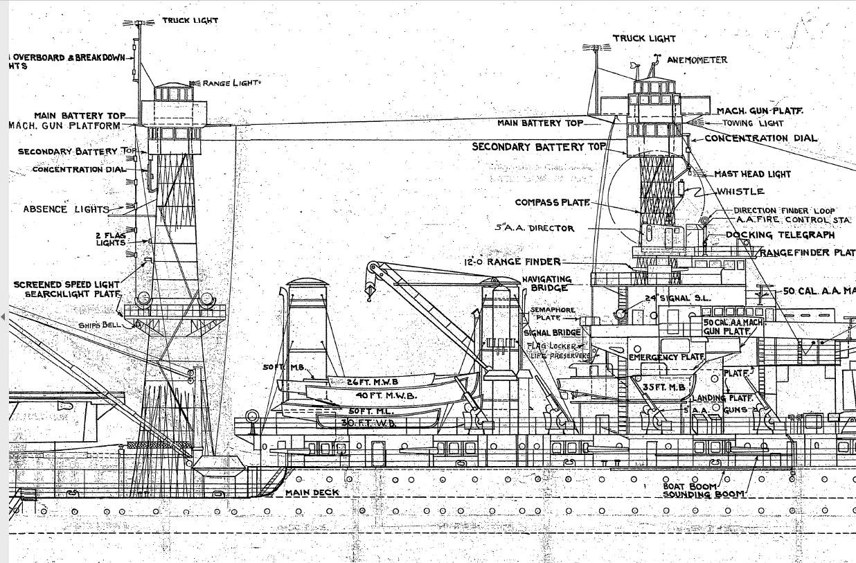

Does anyone have the actual measurements for the cage foremast itself? Looking at the general plans for West Virginia, and using the heights above DWL, I come up with approximately 32+ feet. Do I have that right?
If so, it would seem that kit PE and all the aftermarket alternatives are slightly short.

Great illustration and thank you for posting it, David. By any chance, would you happen to have the foremast as well?
I agree that both mast tops seem to be of the same height, and the West Virginia BoGP that you linked indicates the same. However, the dimensions to the top of the mast that I read/take from those same BoGP appear to be different, at 101+', assuming I am reading them correctly. The plan seems indicate this height is the deck of the secondary battery top, which also the top of the cage mast itself.
Do I have that right and, if so, maybe this discrepancy between sources is the reason the parts are off?

This helps illustrate the dilemma, though not earth shaking by any means. I might have the Blue Ridge version upside down. Not easy to tell with that piece.

I think you may.
Doesn't the cage mast actually continue up INTO the spotting tops? The real spotting top - unlike the kit parts - doesn't actually SIT on top of the top ring. I wonder if that adds to the confusion.
