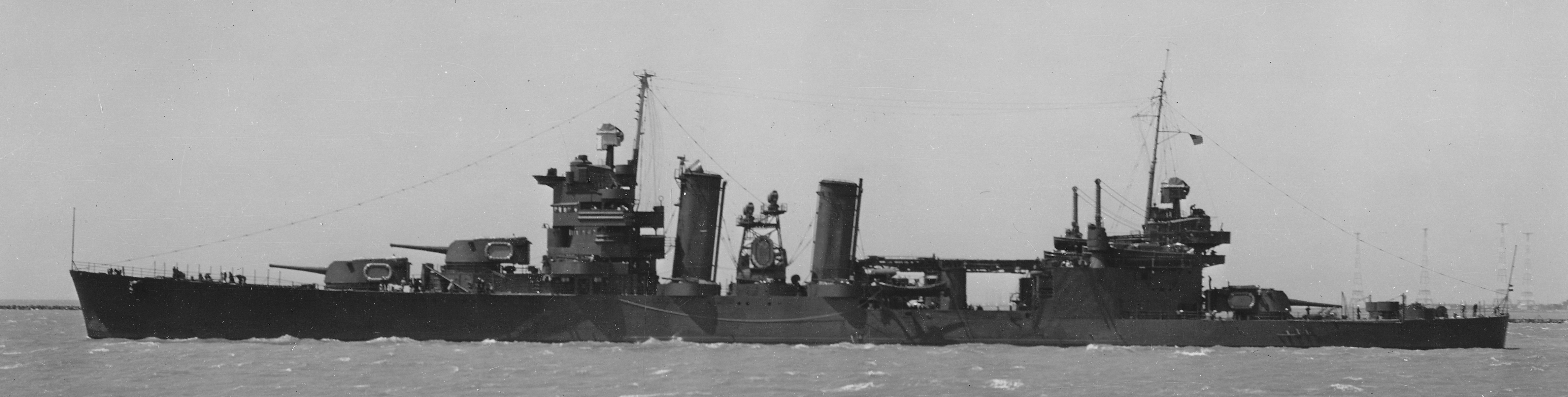

Has anyone built the Combrig 1/700 Astoria? I'm having issues with the shields for the 5 inch guns. If I line the outer ones up with the small round deck overhangs, they are very asymmetric and look odd. It's almost like they're all right hand or left hand shields and not half and half. Is it supposed to be like that? The instructions are garbage btw and don't really help.

The tubs were not symmetrical because the guns were not really symmetrical. US 5" mounts usually had the bank of fuse setters (for AA use) on the left side of the rotating platform, and so needed a little more room on that side to operate. Even the fully enclosed mounts (like on the Benson's, Fletcher's and others) were slightly wider on the left side for this reason. The open-backed shields on the earlier Farragut and Mahan classes had a protrusion on the left side of the shield to accommodate the fuse setters.

This photo shows the general situation with the 5" guns before the splinter shields were added.

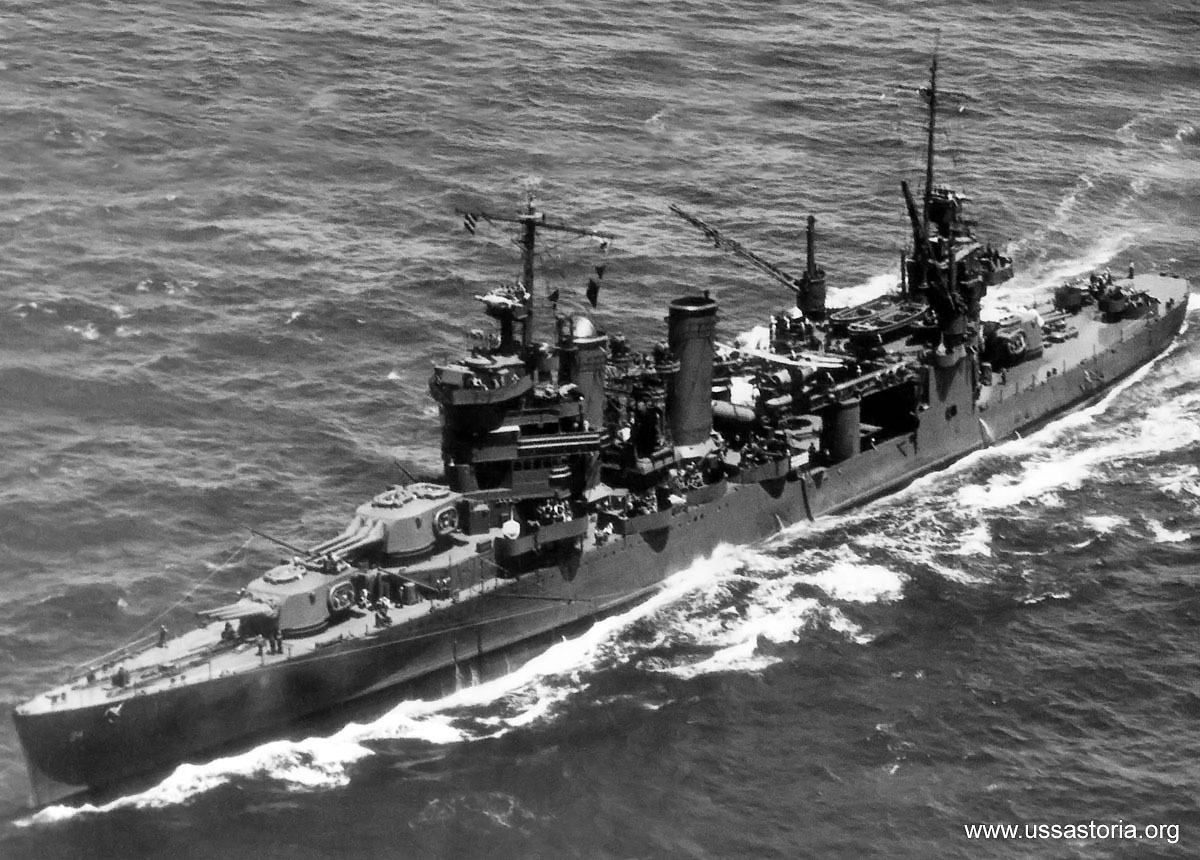

This photo shows the splinter shields fairly clearly - if you zoom it.

Thanks for the photos. They don't however show one of the issues I'm having, which is that the portside rear shield overhangs the deck, leaving a hole. The shields are still asymmetric too in the kit

AFAIK, there's a plate under the hole that extends the deck from the hull.
