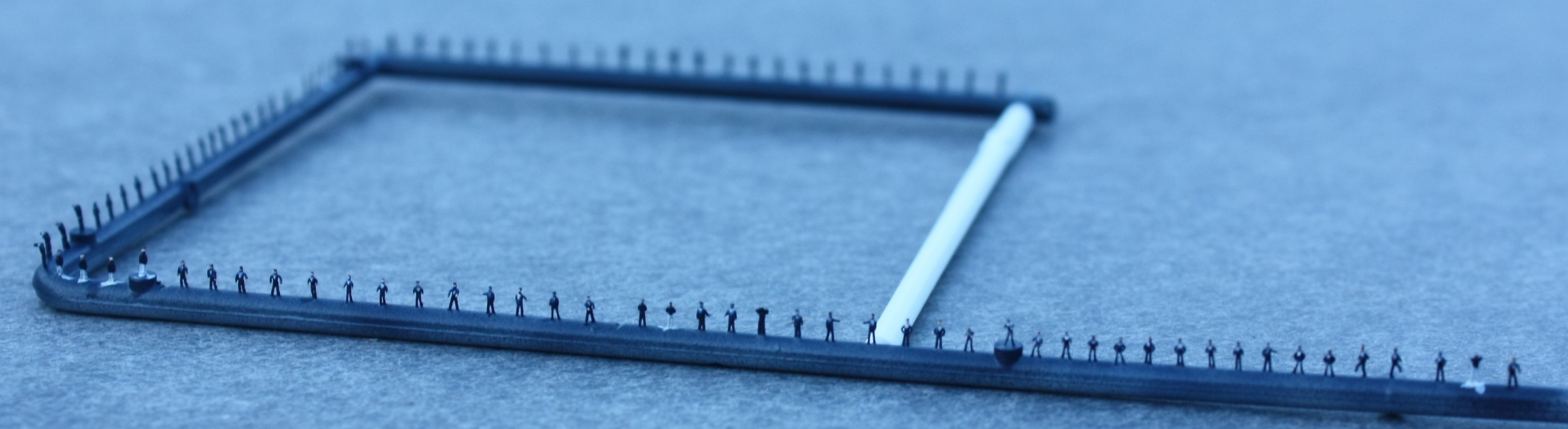

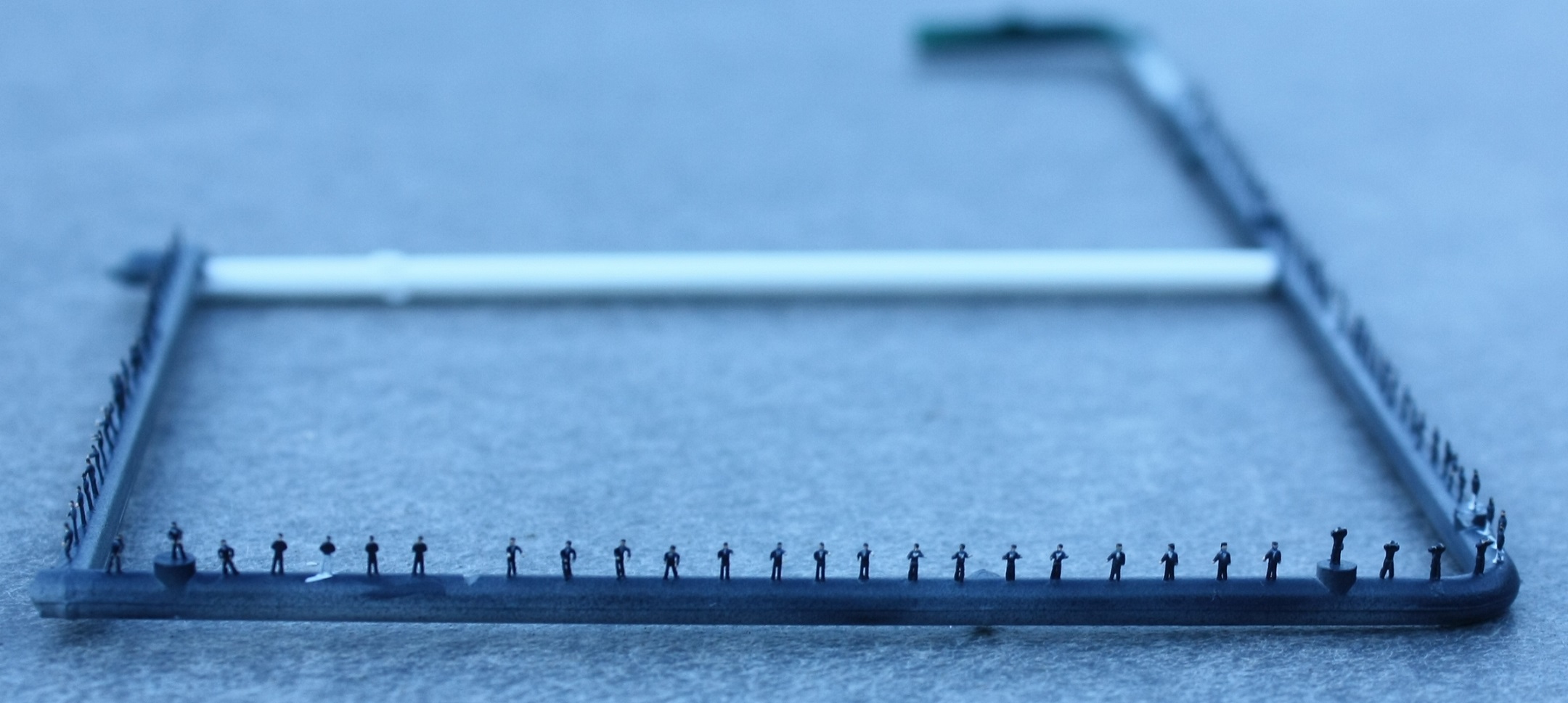

Before adding the AA armament I decided to deal with the crew � a departure from my previous practice, as populating the ships has always been the last step in the construction of my models. The reason for this change is that the ships is depicted in a state of combat readiness and therefore most of the crew is seen manning the open AA batteries and the bridge. It would have been nigh impossible to attach the figures to the 4� AA guns or pom-poms already fitted.
I used 101 PE figures from sets of GMM, Eduard, FlyHawk, Lion Roar and Five Star. I prefer to use photoetch figures with adjustable limbs � essential when you want to depict them seated or at an other specific posture. Ratings and officers have been glued to a piece of sprue, then their flat appearance was ameliorated by adding gel type superglue to their torso � one tiny drop to the front, two to the back, as learnt from Marijn van Gils, however without the addition of baking soda. A coat of primer followed by airbrushing dark blue all over them was the next step. Details like faces and hands, middle blue collars, white shirts and dark blue caps have been picked out by hand using a very fine brush. A layer of matte varnish completed the preparation of the crew.

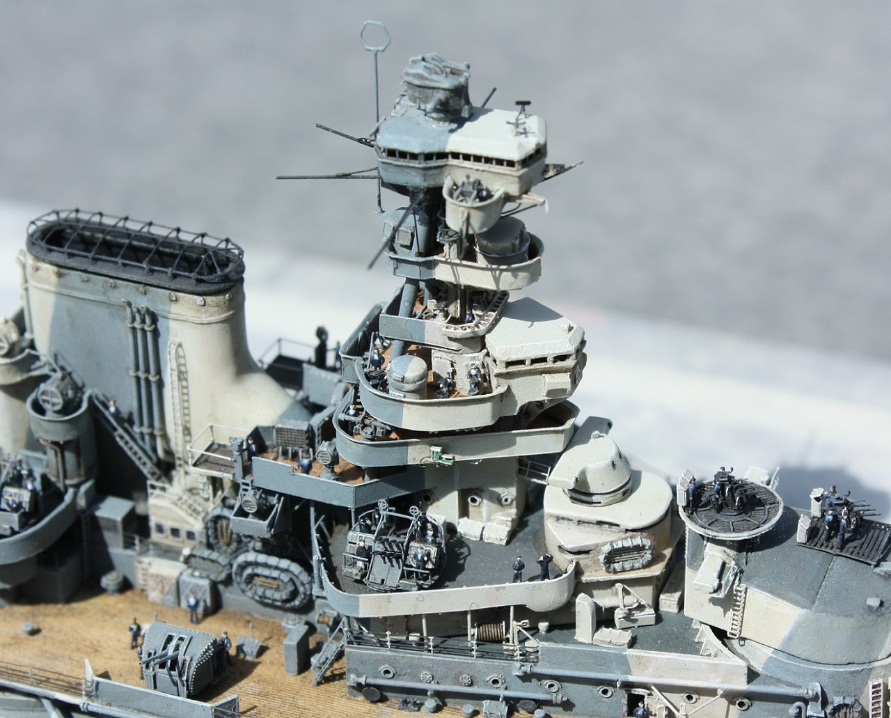

Next, eight of them were attached to the 4� mountings, six to each pom-pom, three next to the Vickers 0,50 machine guns, and the weapons have been glued to their respective places. I added figures to several deck levels most notably ones to the binoculars at the compass platform. They are minuscule and very hard to notice but there they are, sitting at their instrument. In all it is somewhat surprising how the ship soaked up a hundred figures � you have to look twice to notice them. The empty expanses of the forecastle and the quarterdeck must be responsible for this, but I resisted the temptation to put figures there � they are not supposed to stroll around when the crew is at action stations.
All that remains to do is to affix the railing, quite elaborate on this ship, and to add some flags.

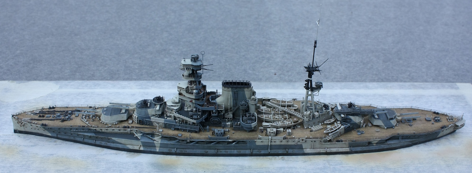

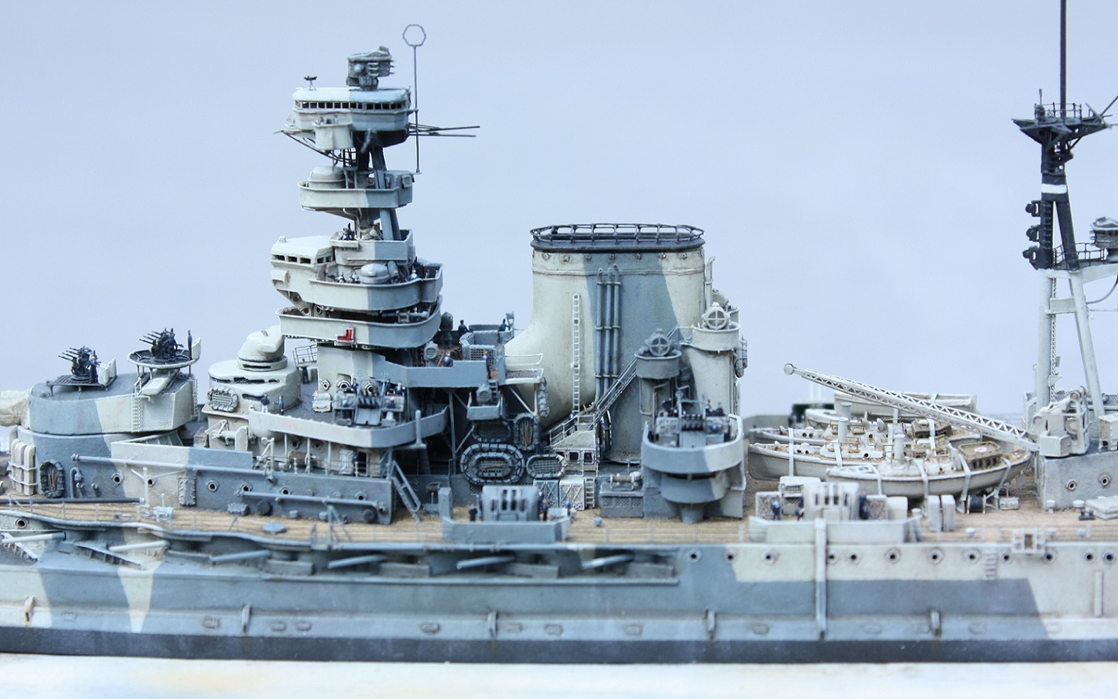

It took much more time and effort than anticipated to complete the rigging. I begun with the signal halyards, quite numerous in this ship. For this purpose I used Infini�s ultra fine white lycra which has a diameter of 0.048 mm. I thought this would be thin enough and the idea was that the elastic nature of lycra would make it easier for me to keep the 16 double stranded halyards tight. It was not very easy to affix the halyards � I glued one end to the yard, then fed the fine filament through a hemicircular part (PE anchor link cut in half and glued to the signal deck) and glued the other end next to the first one to the yard. As I found it nigh impossible to simply feed the tiny strings through the small openings and not damage the halyards already attached I glued the leading end to a piece of human hair which acted like a needle. I used the Infini lycra for the mainmast halyards and the antennae between the masts as well. After painting the halyards did not seem so very thin compared to what I can achieve from stretched sprue. All the rest of the rigging is stretched sprue. The source of it is sprue from Revell�s 1:144 Suchoj S-37 Berkut. It is an inexpensive kit which yields very usable plastic of the right colour � recommended to everyone not willing to sacrifice an Airfix Victory. According to the usage of two different materials there is a slight discrepancy between the diameter of the elements of the rigging but this something I can live with. Otherwise I like the look of the rigged ship a lot.
Next I prepared and attached the signal flags (Five Star) indicating �my speed is 17 knots�and I am altering my course to port� and a White Ensign (Hawk Graphics) folded around a piece of aluminium foil and brushed them with diluted light grey to subdue the harsh colours, then glued them to the appropriate ropes. As a final act some matt varnish was sprayed over parts of the model where glue spots were apparent. The ships has been secured to a base plate more suitable for display but its final home will be in her diorama. After a construction spanning over four years this battleship is finally finished!
Some higher-quality photographs will be taken by a friend of mine and I will upload them to the �Completed Models� and �What�s New� sections. Many thanks to everyone who followed this outrageously long build for the continuous support and encouragement!
