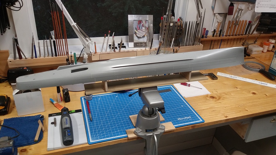

09/02/20 - Now that my workshop is fairly complete I will be able to begin the STODDARD build in earnest. Tonight I built a wooden jig to hold the hull upside down while I make the necessary penetrations & openings for intakes, discharges, and SONAR dome, etc.
