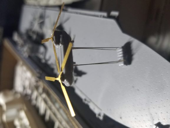

Besides painting the helicopter and wire/rope/vehicle what do you think of what I came up with?
Posts: 12489
Re: How do I replicate a helicopter delivering cargo
Very nice and in reasonable scale! An elegant solution to the thicker wire you'd have to use for a single-line slung load.

Post by spejic »
That is very impressive, both in detail and style.
Can you describe your material and process to help future modellers that come across this thread?

I wanted to replicate the attached picture since I've seen loads done before I want to do something different. The helicopter is a Aoshima Chinook with Toms Model photo etch Chinook blades. The truck is also a Aoshima brand everything is 1/700 scale, I used Albion Alloys 0.5 mm Brass rod to replicate the cables coming from the helicopter to the truck, There are one set of 2 lengths of brass rod at the front of the truck and the rear of the truck going to the helicopter. I used BSI Insta Cure + and also used BSI accelerator to join the brass rods together at the top so they wouldn't separate. When the CA cured I attached that end to the helicopter using CA once again using BSI accelerator since it would separate due to the tension on the brass rod.

spejic wrote:That is very impressive, both in detail and style.
Thanks spejic I wanted something to spice up my otherwise boring ship, Ive included a write up on my assembly of the mini diorama above.

Crafty solution, sir! There are some PE loads out there... will look in my PE stash for company/parts number.
