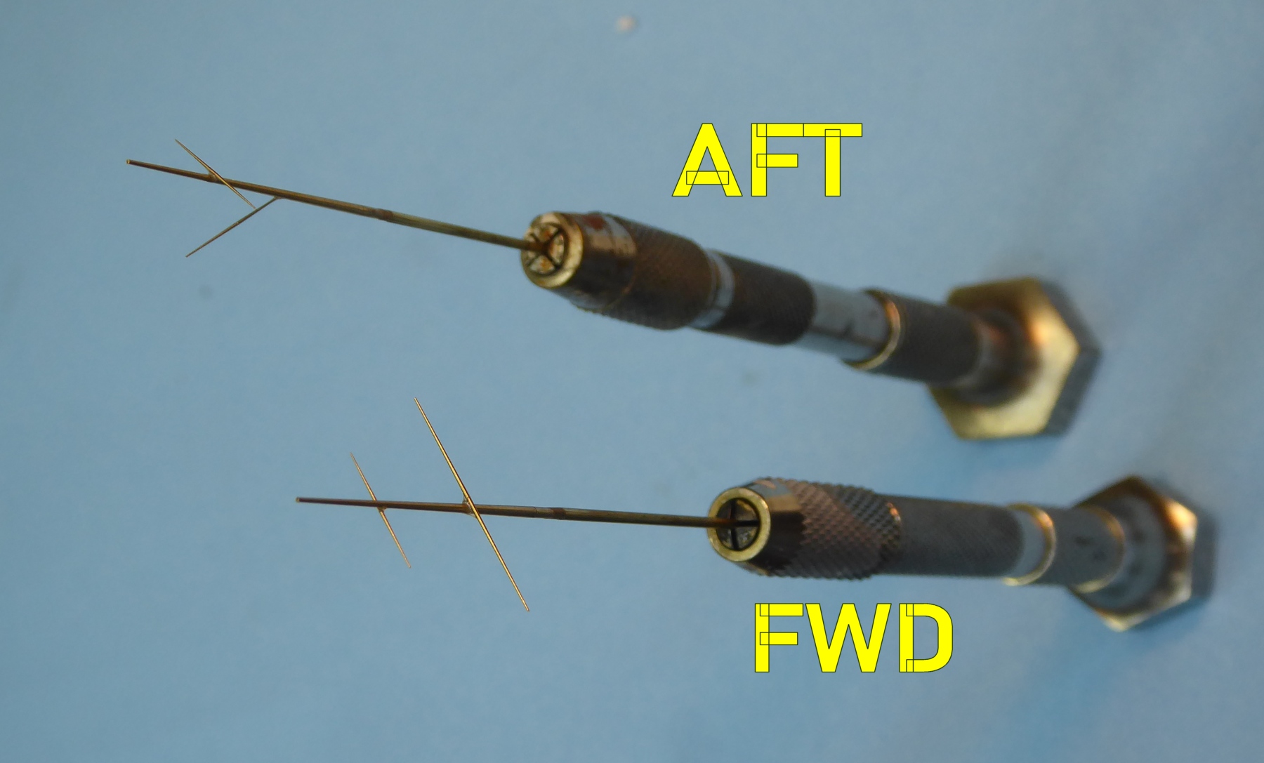

Masts and yards;
Having extensively ( maybe obsessively ! ) studied the photos,
I was not entirely happy with the shape of the kits brass masts,
as their taper was constant from its base and a exaggerated narrowing at the top .
I also felt they were too thick at the base--and in addition there was
-for my liking--insufficient ' tail ' to the mast ( to be installed into the solid resin cast superstructure )
to counteract the cumulative rigging tension .
Therefore I made my own - parallel for the first 1/3 of its length- with a lot of tail ! )
-using some Albion Alloys brass tubing,
with stainless steel wire cemented inside on the lower portion,
and a Master Models 1/350 Yard arm shortened and installed to give a more gradual shape to the the top taper .
The kit supplied brass yard arms - whilst the lengths scaled well-- they were alas rather too substantial when viewing photos
and were replaced with items from Master Models
The methodology of attaching the yard arms- according to the instructions--whilst structurally sound
alas bore no resemblance to the real thing

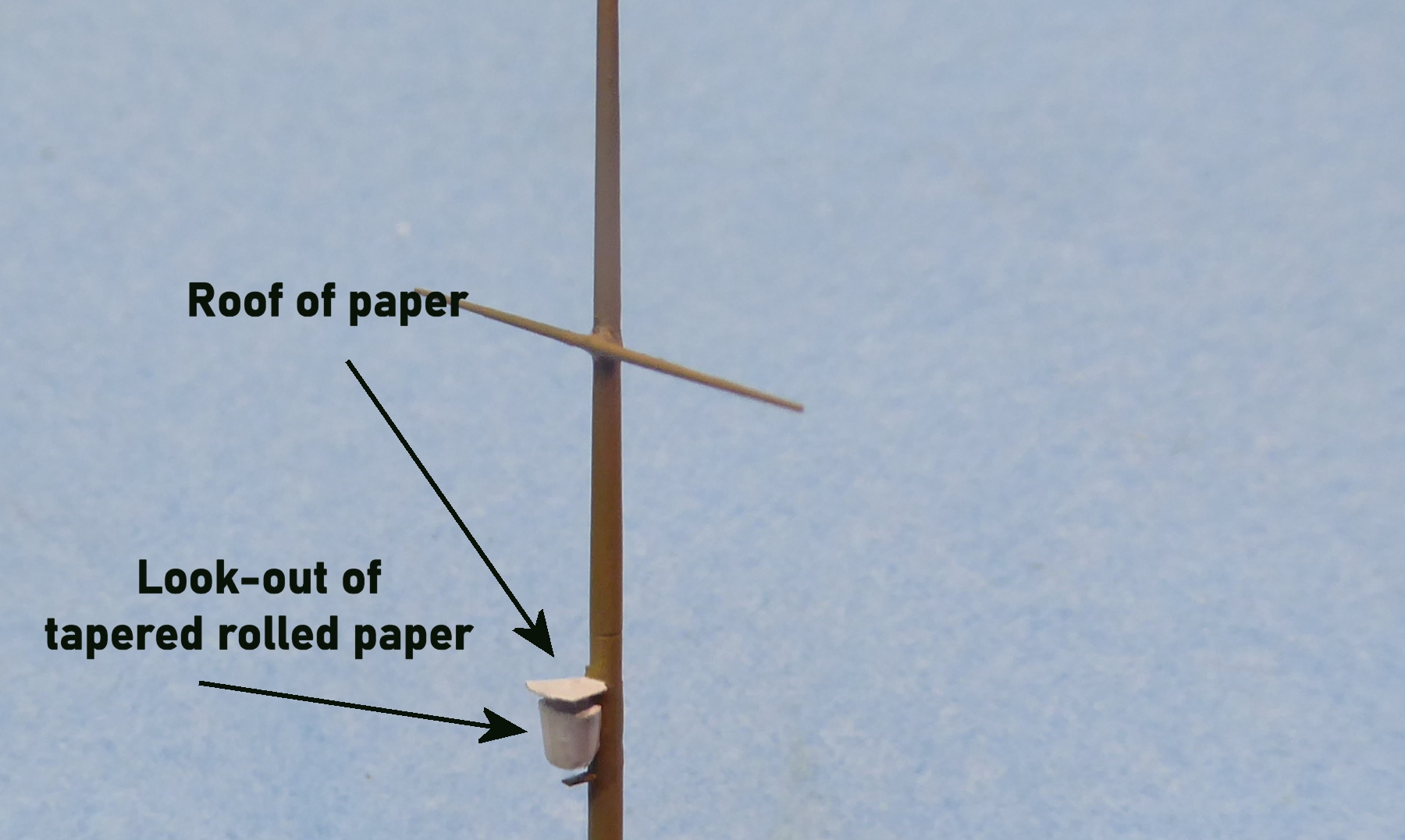

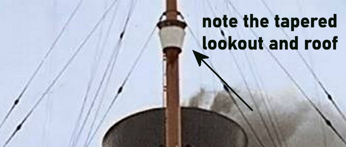

The fwd mast had a look-out on its fwd face --which in the early version of the ship was open with just a roof,
After the refit a more personnel-friendly fully enclosed version was installed
The kit supplied item was a good shape and quite well done ...
==> was post refit only !
As a result I made my own lookout using paper
The photos show an external ladder on each mast, however when scaled down this almost vanished from view,
so rather than attach a way over-scale ( even with my finest ) PE ladder to the mast ,
I attached a very thin copper wire to the relevant mast side,
-- which will have a gentle highlight/ shadow done to give the impression of the outer ladder vertical

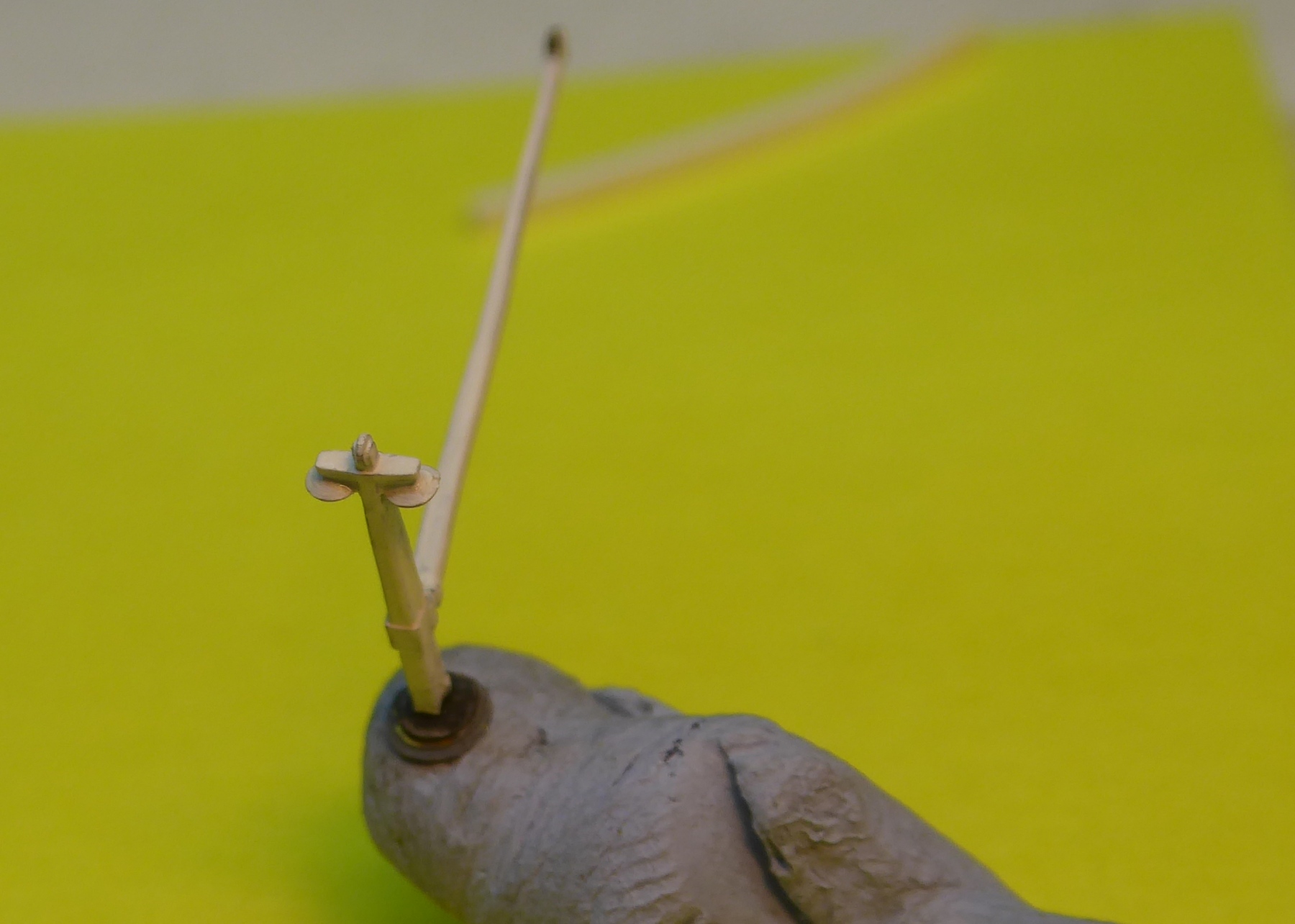

The Fore-deck cargo cranes were made using the cast kit parts,
which are pretty close in appearance and dimensions
The masts were cast from a 3-D print ( I think) --so they needed some work to remove all the printing steps to smooth.
The ' lamp shades ' are a bit over-scale -but pleasing to the eye.
I added my own lamps underneath made of white glue drop-lets
( also over-scale but ditto above...! :cool_2: )
I added a ( VERY ) small strip of stainless PE to the underside of eh crane booms to stabilise the resin and also create the impression of taper.
The real crane booms were actually an inverted hollow U shape
( making these would have been an ideal application for PE ... !)
When at rest, the booms were supported on a hinged centre post with hinged side-members and a aft support.
I made these with different thickness wires- glued in situ

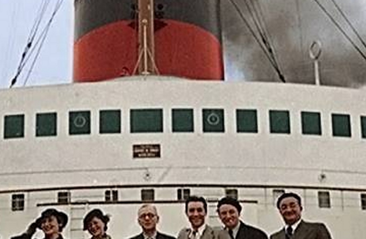

The Builders plate was proudly ( and prominently !! ) fitted below the elongated centre bridge window
I made mine using an anonymous ( ie no idea here it came from ! ) aircraft instrument decal cut down to get the desired effect.

Hate to say it but I do think the crane booms were full box structures rather than inversed U-beams. I think the bottom plate of the profile is just in the shadow, making it appear hollow. That is of course only based on that one picture you posted, if you have more pictures indicating a U-profile, then I'm mistaken.
It would, from a technical point of view, a very strange decision to use a U-profile as it would give rise to buckling under relatively low loads without any supporting on the bottom of the profile.
That said, apart from the modeler himself, nobody would probably notice this detail.

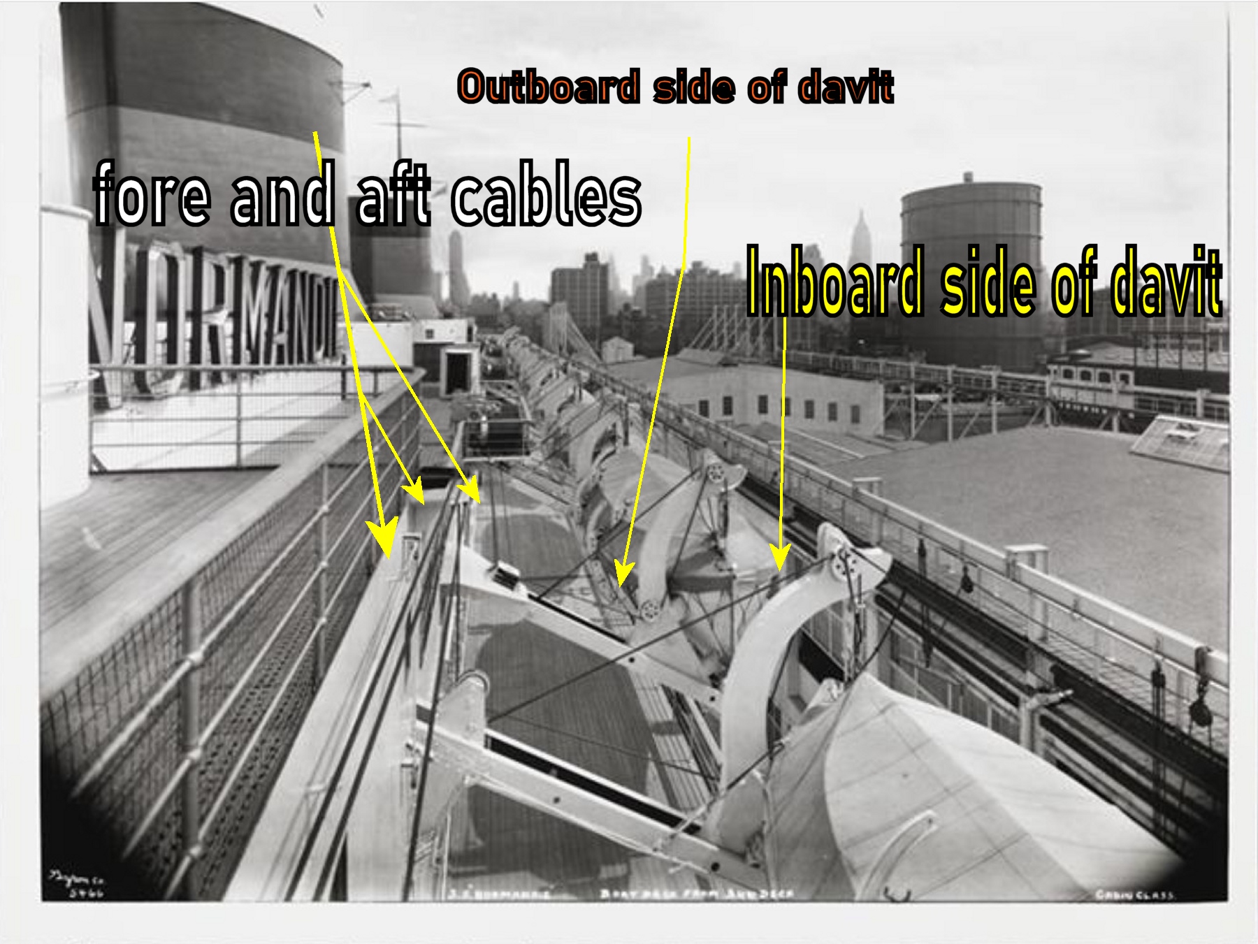

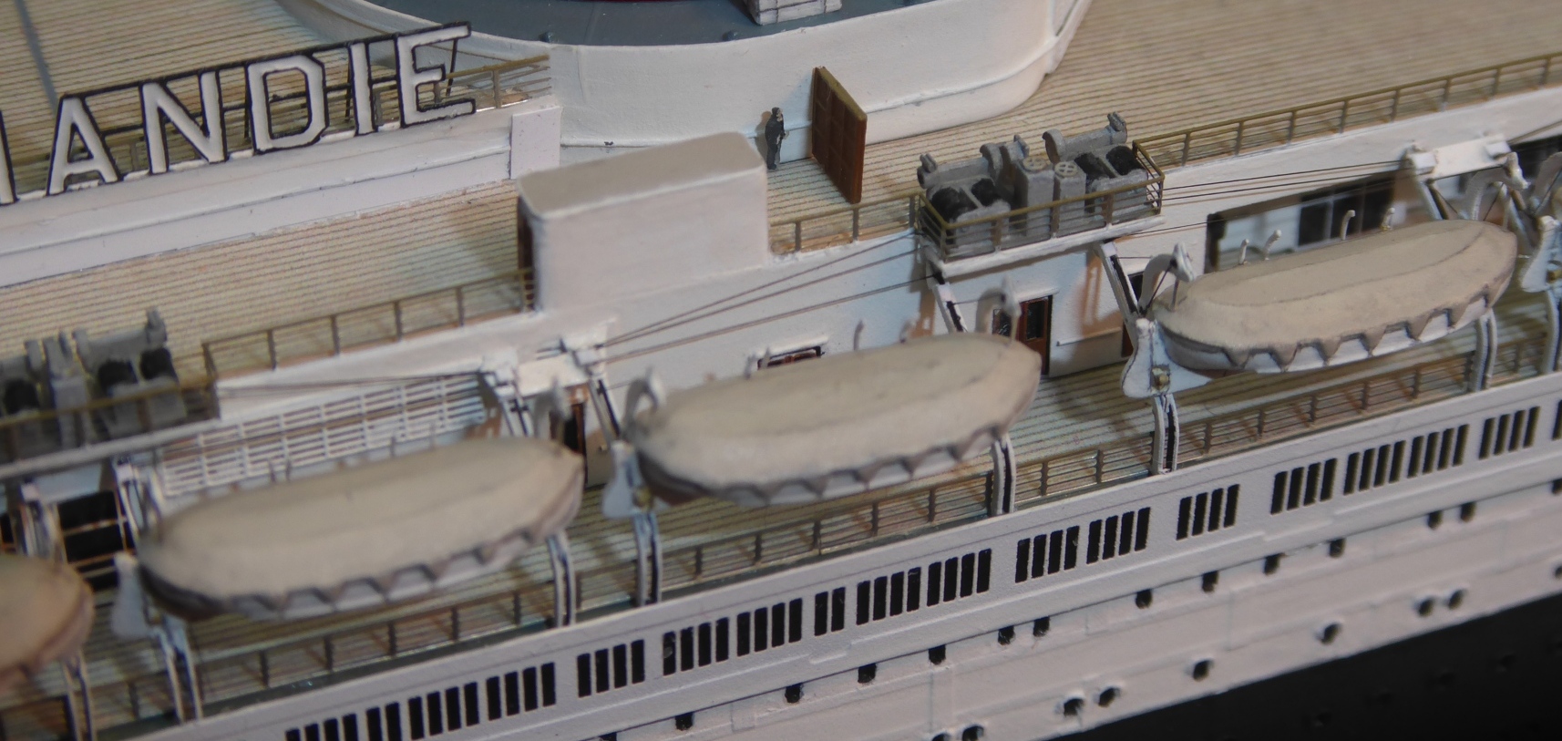

Lifeboat rigging...I set out to represent " seemingly " all of it
but leaving out some of of it off as cumulatively otherwise it starts to look over-scale
The lifeboat fall cables coming off the big winch drums span the vessel fwd and aft in all
sorts of differing ways , pending position of winches to davits to boat

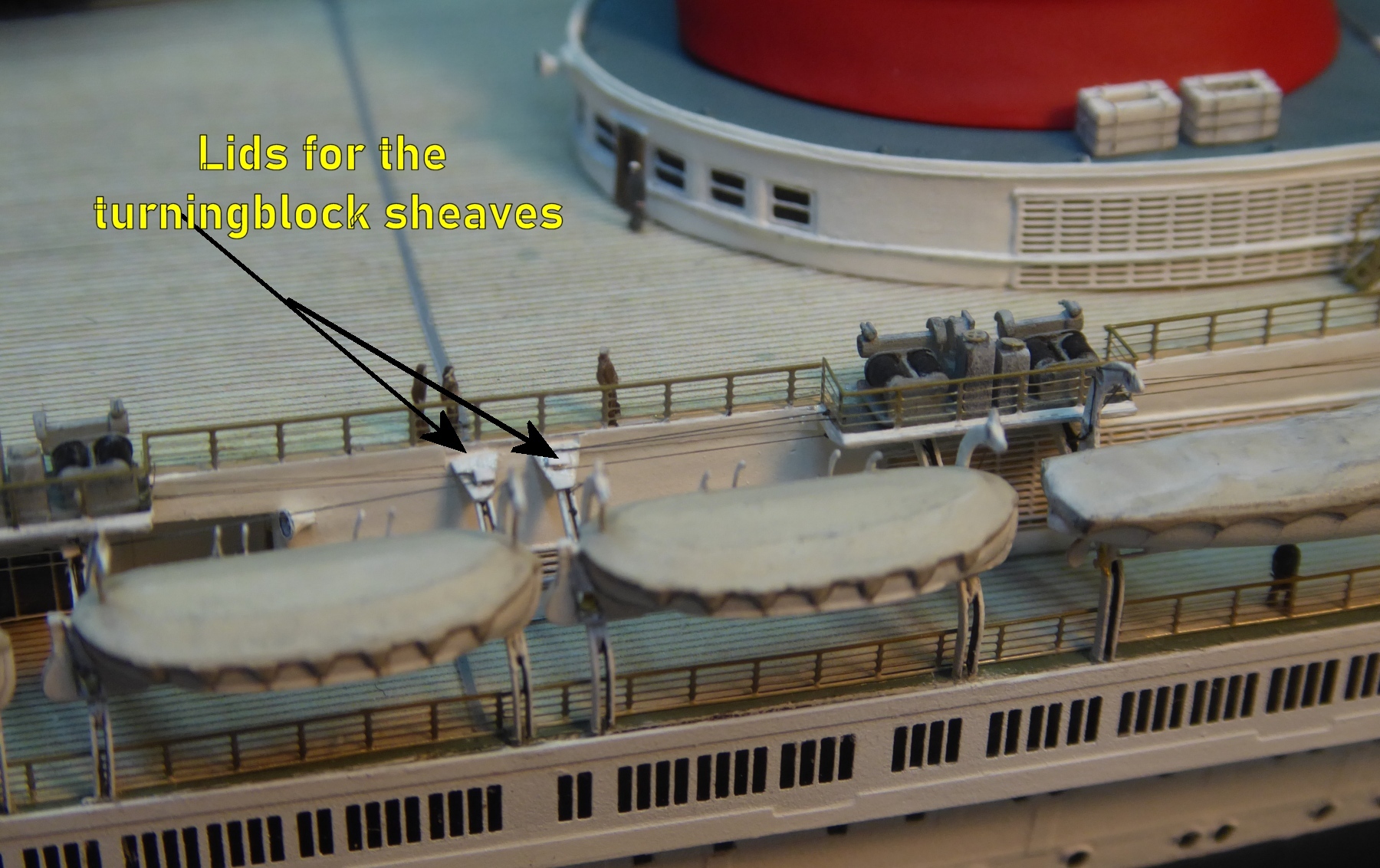

The turning blocks I had previously fitted made of PE circles had their sheave box lids made of paper
The davit rigging consisted of rigging running over the pulleys both sides of the davits
I simulated this with pieces of black thin sprue running in lines between the pulleys as per photo of the real thing
The large motor launches had a long I section spreader bar between the falls --I guess to inhibit/ reduce fore and aft oscillation?
( note the bow in it !! )
I made a representation if it in thin brass ( PE rigging = square section )
The boat fall blocks which had long flat-sided cheeks
I deliberated how to give the impression of these without actually making them!!
what I needed was a repeatable source of flat sided section
so that I could make a paint effect of dark fwd aft and white on the out/inboard sides
aha!! ... ( WEM 1/350 Koenig railing waterway
There were also additional plates fitted in various areas for turning blocks
I have added most--but not all
I have completed both sides of the rigging and falls installation,
now I just need to add paint ,and touch up and tidy
before moving onto the next stage
hopefully less repetitive and mundane !
Overall the end effect belies the sheer amount of fiddly work
but I am happy that
( looking like!! ) less-- is more

I find the your lifeboat and davit execution simply astounding. Bravo, Jim.
