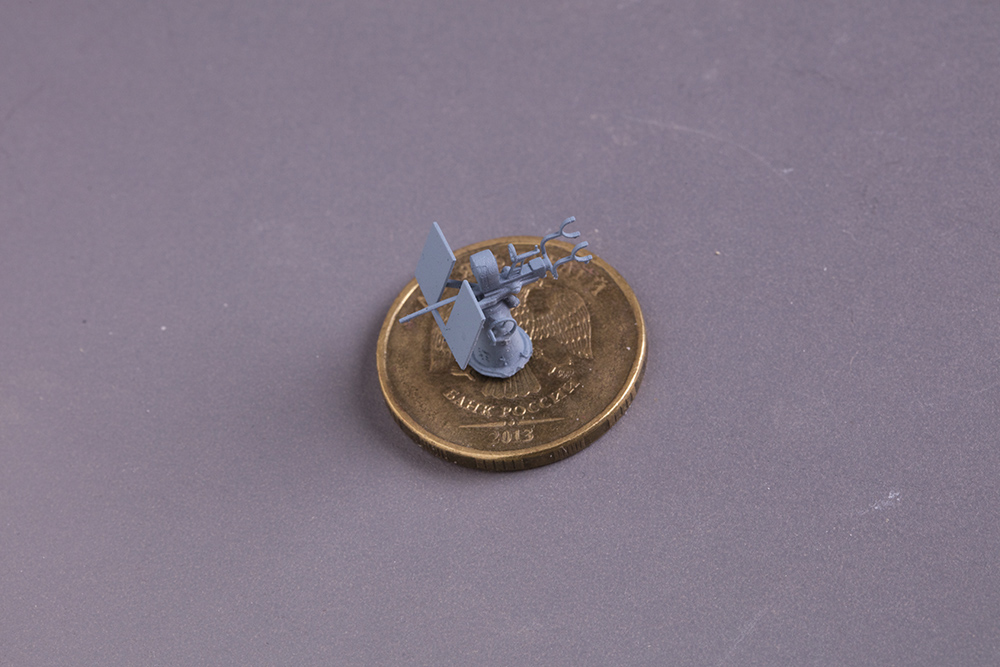

Posts: 5068
Re: APA project
Post by Fliger747 »
I mounted the Sky lookouts on the ship, but broke the last one... Arrgh! Below is a photo of one of the Oerlikons printed in 1:144. The 1:120 ones are a little more robust.
