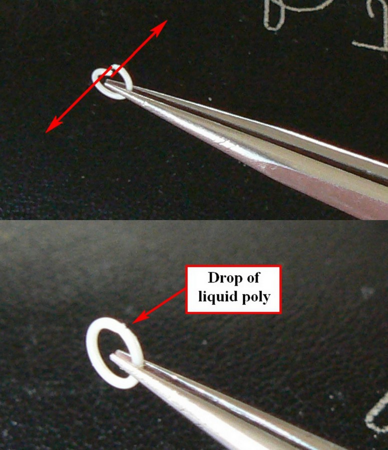

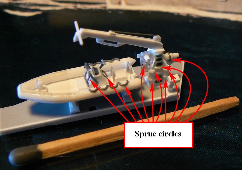

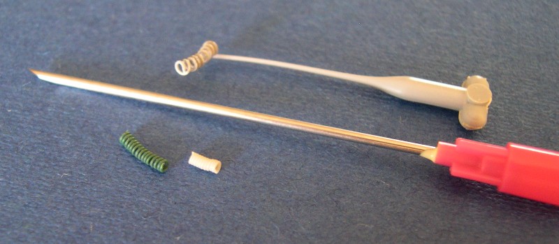

PostPosted: Mon Nov 09, 2020 5:26 pm
Posts: 681
Location: Vigo, Spain
Hi there Marijn and all,
marijn van gils wrote:
Sprue circles would be much easier to glue in many cases. Great idea! I'll be remembering this... ;)
Stretched sprue will never be praised enough. Actually, the limit is how much you can stretch it without it melting down (and breaking) when applying heat again. Other than this, the calibers that you can obtain can be surprising:
The only relevant handicap to keep in mind is that stretched sprue circles will "open" if you apply liquid poly to it, otherwise the only way to handle these small calibers. To avoid this, you have to cut all the sections in the same point, and in a long cut, as if you were cutting salami slices; then, reverse the ends, pushing them against each other, and the "spring effect" pressure will keep the circle perfectly tight and closed.
After this, and if the slice has been well cut, the circle should already be perfect, and the seam should have virtually disappeared. Then apply a small drop of poly on the seam only, and let it dry. Sand slightly and the seam will disappear completely:
I have used this method for years, and the effect can be very convincing even at very small scales:
I hope it can be of some help. I find it very easy to do, and with lots of applications in modelling.
Best regards from this side of the North Atlantic,
Willie.

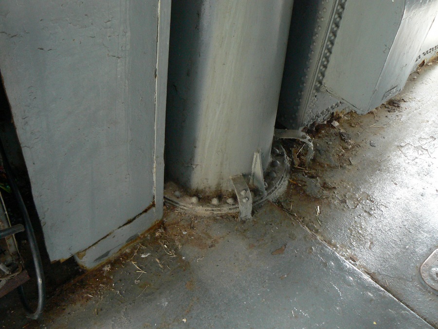

PostPosted: Sun Dec 06, 2020 4:41 pm
Posts: 681
Howdy Mr. Davis and all.
Sorry I could not come to you earlier, but 1/1 scale life has kept me busy. If you have heard of teachers with huge incomes, nil work to do and lots of holidays to enjoy, well, they are talking of my school. :cool_1:
Thanks a lot for the excellent, salty picture, a flashback to a world that no longer exists. Mr. Davis, you are right, this detail is very small, and hence rare to be found in generic pictures, so your idea of addressing this subject is mostly welcome.
I could take some pics of this mast base detail when I was on board USS The Sullivans in Buffalo. As further info, I attach the pics that I have:
And something else that I had never ever seen before that eventful day: the base of the main mast at main deck level, just ahead of stack number one. I attach as well the pics that I have :
Not that it will be very visible, but actually this is a detail I forgot completely about when I closed the structures, so I will have to take care of it pretty soon.
In the meanwhile, I hope these pics are also of your interest.
Best and warmest regards from this side,
Willie.

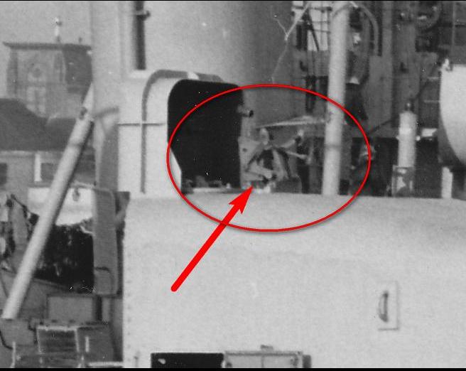

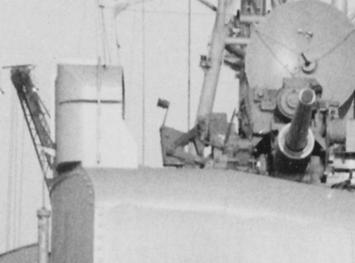

And something else.
While searching for info on the blast bags, I have come across an element that puzzles me, an strange device before the mount captain´s position. The ring sight seems to indicate that it is some kind of aiming device, but the pics are not too clear, and I have found no reference picture or graphic. Would somebody have a clear reference of this thing ?
If you have nothing, no problem at all. With the scarce pics that I already have I think I could more or less produce something.
TIA in any case, and very best regards from this side,
