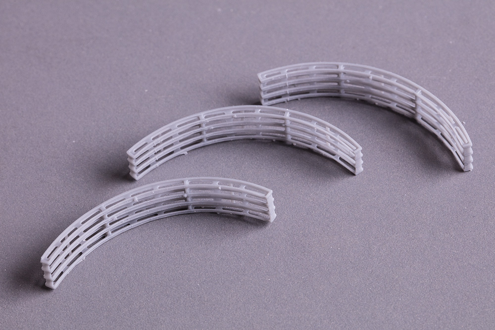

Three of the four 40mm ammunition rings for the forward 40 mm mount.

Tom,
You're really going to town on the parts!!! Well done - the ammo stg. racks looks great! Are you using the Phrozen Model Gray Resin or...???

Thanks Hank! Right now I am printing the last segment of the ammunition racks. There is a gap where the tub access is just to Starboard of the MK 51 director (it's a climb over). So I split a ring section into two parts. What surprised me was how substantial the curved racks are!

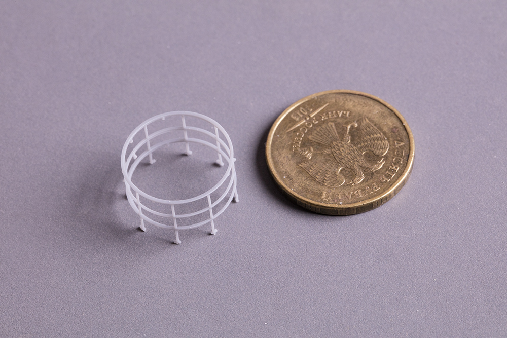

Today I printed circular rail for the foremast SG radar platform, which looks very nice. At the same time I also printed rail to surround the inclined ladders as they emerge on the top bridge deck. However I fat fingered the dimensions so am printing some new ones. The Aft mainmast radar also has a circular rail, however I will need to re design this as it will need to be split as the large search radar is too large to slip the rail over in one piece. For the 1:120 scale the printed rail is very nice, perhaps better than PE with a more three dimensional appearance and not overscale.
Fwd Mast platform rail ring. The one for the aft mast printing now has a split for installation.

Tom,
That looks excellent - wish my handmade railing for the Mk. 56 Director platform had come out as nice. You're moving right along with the 3D design - kudos!
