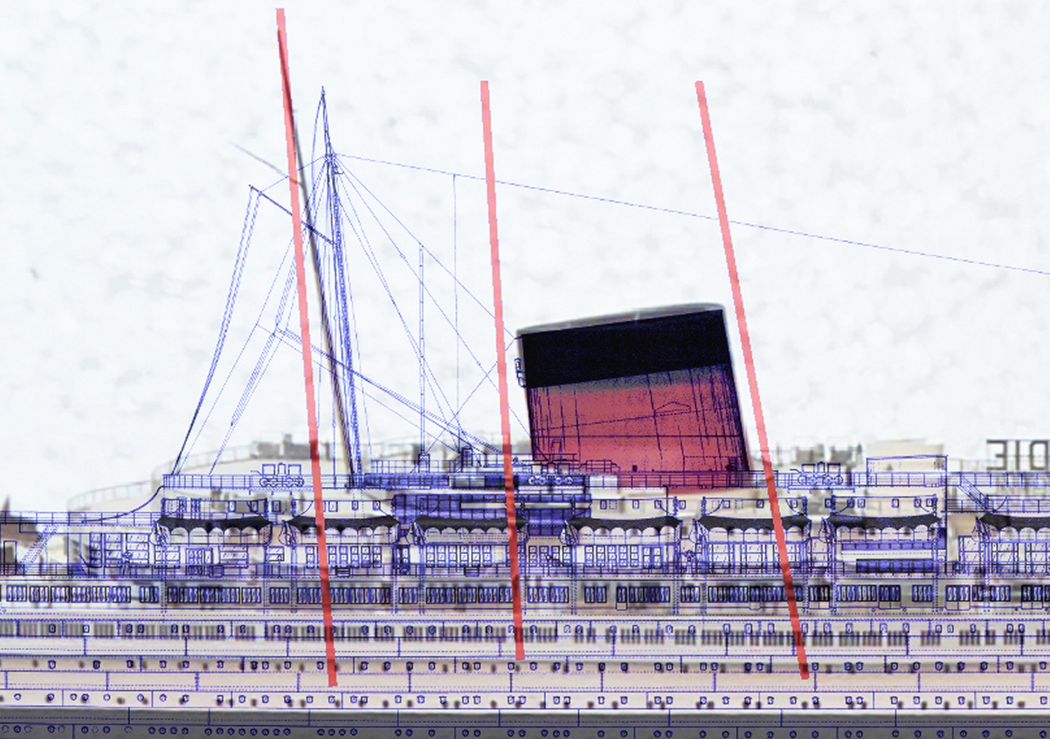

herewith overlays of the plans on my model
fwd was pretty good-
- aft was a catastrophe-- wrong rake and too tall !

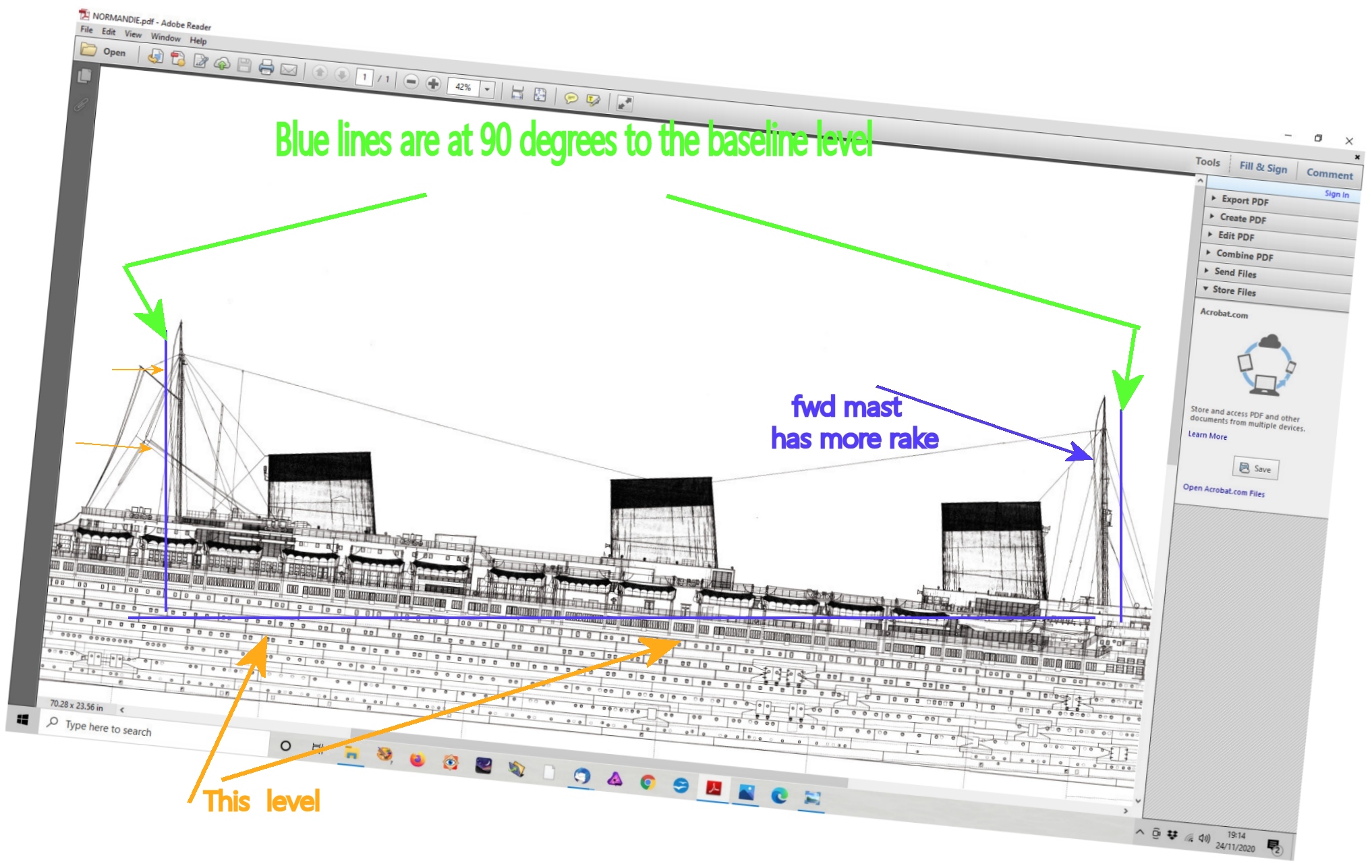

Intriguingly... I suspected the aft rake angle was different to the fwd rake angle...(?!!)
I rotated the plan excerpt until I had a level baseline and 90 degree tangents parallel to the masts
and indeed the rakes differ...(??!)
In the end.... after some fiddling It did all look pretty ok ( I may still need to tweak the aft mast rake a little more...)

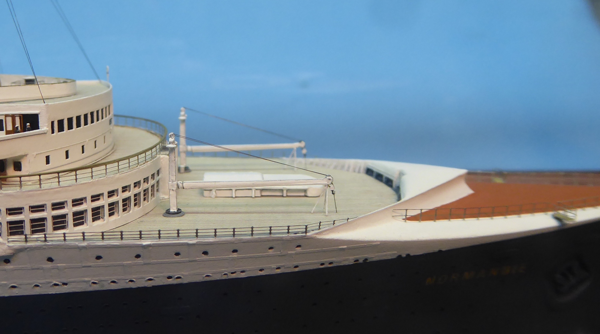

Overall the ship model is starting to look much like the real thing from most angles
some of the copious life-rings can be seen here, both on rails and on the stands
and some of the final little bits are now installed ---

Isn't it fairly common that the rake of masts and funnels increases towards the stern ? It reenforces the impression of speed and dynamism that is conveyed by the rake as such.

>>>>> Isn't it fairly common that the rake of masts and funnels increases towards the stern ? <<<<
>>>>> It reenforces the impression of speed and dynamism that is conveyed by the rake as such. <<<<
Indeed that so--but according to the plan ( which I believe to be pretty reputable)
it suggests --according to my level baseline and 2 x 90 degrees that the aft mast is actually STEEPER than the fwd mast???!!
its only a degree or two ...
EH..!! ?!"
I must confess I have NOT followed that exactly--as parallel to fwd looked more harmonious to my ye
but....
though the angle can still be tweaked still before rigging....

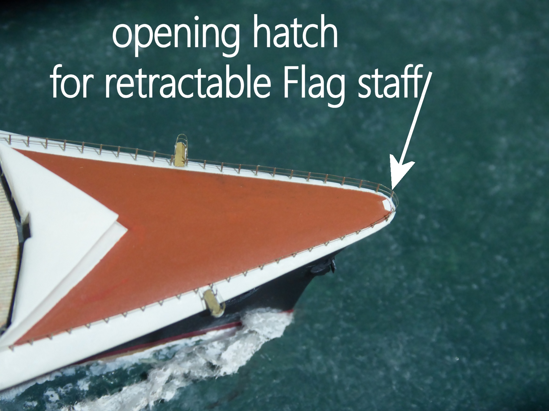

Normandies fwd flagpole was telescopic and would be lowered when at sea--there was a hinged flap in the deck to allow it to be raised.
I cut the ( closed )lid from a piece of white decal sheet
The aft flagstaff has been installed, ( it still needs to be rigged--as it is very tall! )

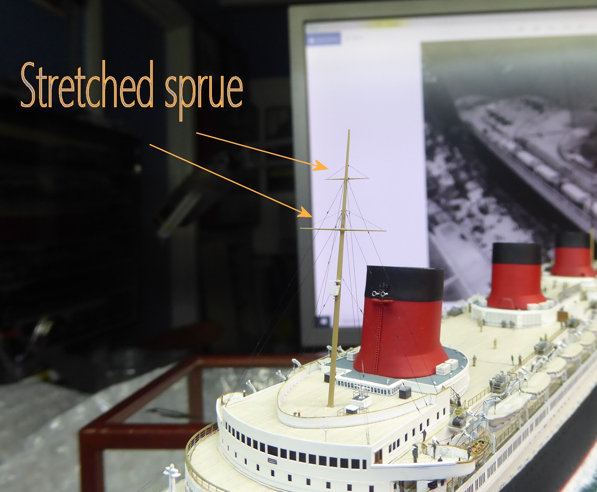

Its main advantage is that for the use in for example Funnel stays, it can be 'propped' up,
and is very resistant to kinking whilst handling.
However... I can stretch 'Sprue' easily and reliably - to about half of the Nitinol wire, useful for halyards
and antenna.

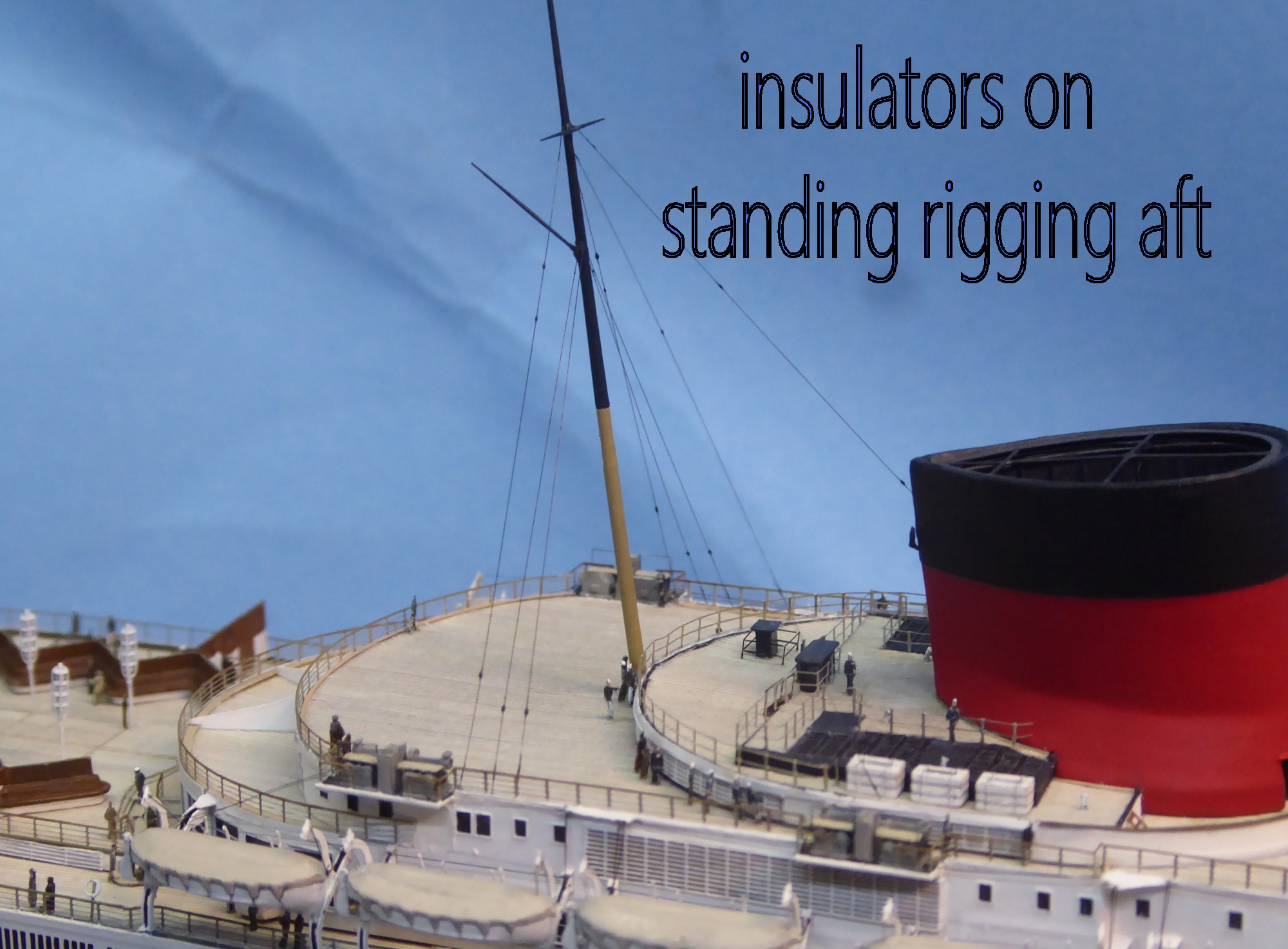

Having practised with the Nitinol ( Nickel Titanum ) wire on the Tug, I was armed and prepared to get cracking on the Normandie rigging of the two masts
I always wanted to use stretched sprue for the halyards and ariels- ;
although the MK wire at 0.047 mm is pretty skinny by any standards...
it still can be thinner and finer.!
So the plan was to use the wire for the standing rigging only along with the (minimal ) crane rigging fwd
and my familiar tried and tested method of stretched sprue
the methodology of which is still unchanged
my step by step of how ..-for those interested ..-- is here at MW.com
link
viewtopic.php?f=4&t=37536
The standing rigging of the foremast was was first.
Some people like the metallic grey colour of the wire, my view is that ALL rigging looks back against the sky.
I colour it black --without paint build up -- using a 'Pentel' Permanent markers,
drawing the pen along the wire ( secured with tape at one end) on a piece of Kitchen towel--
==> the paper towel soaks up the excess ink and transfers it to the' underside' .
( warning--don't use Sharpie pens for this--they bleed with adhesive, thinners and / or varnish)
So as to be able to gauge the EXACT longitudinal dimensions of each piece of wire,
I used a thicker " measuring " wire .
Once it had been offered up and test-fitted by snipping to size it was then
the 'template' for cutting the EXPENSIVE Nitinol wire
(( ==> ( � 25,oo for 5 metres ! ) :scratch: ))
The ship being a fast liner -- there is a fair amount of cable to be rigged.
( alas a 'soft' photo image--shot though the glass case)

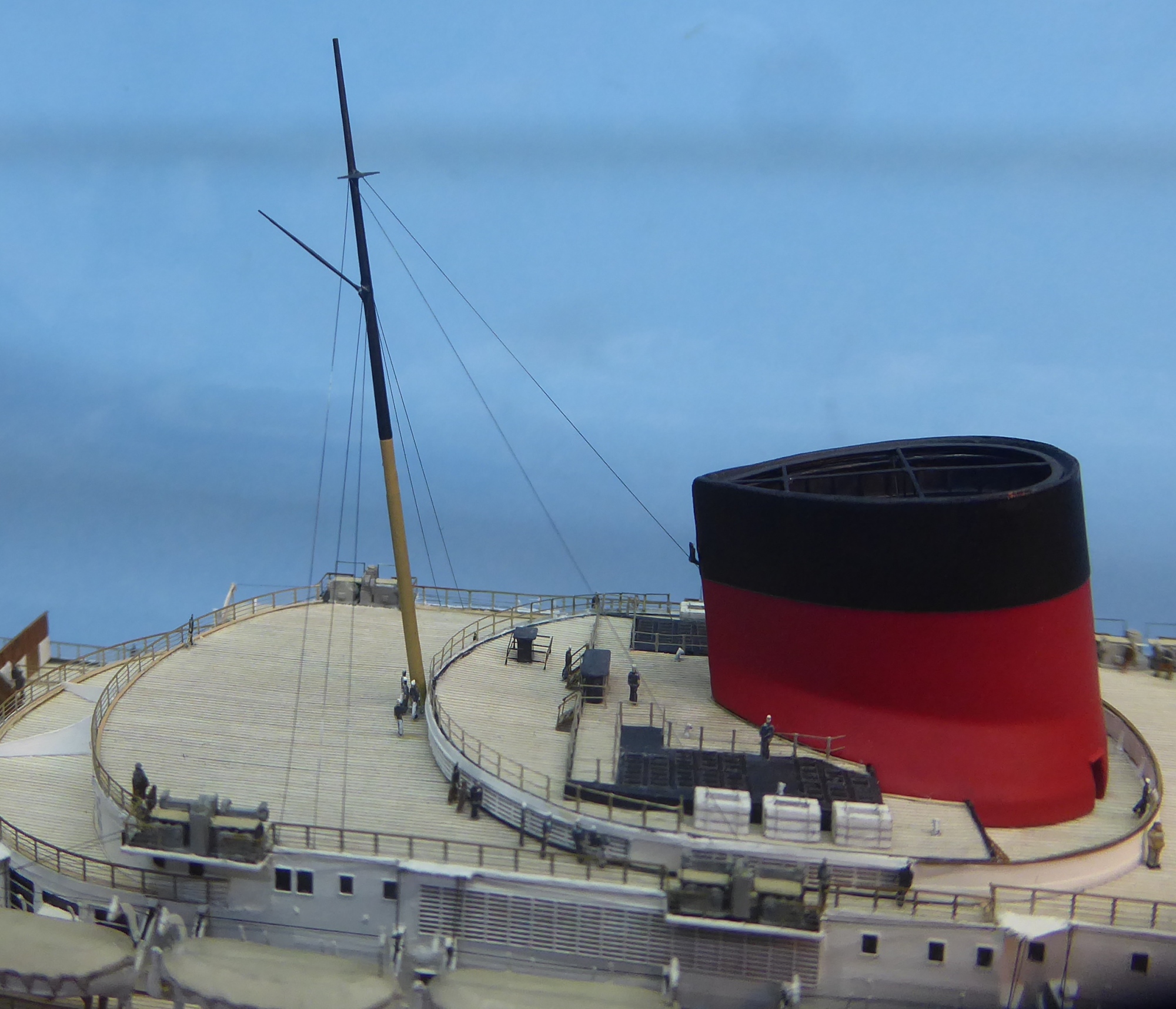

followed by the aft mast
it all was looking a bit stark--but the thickness is about right--as the wire cable holding those tall masts up were quite chunky!
The insulators were done with gentle application of paint on a thin brush--in situ
I added the 'suggestion' of the turn-buckles at the lower ends with some paint-
==> its an ongoing process-- adding a thin layer a day.
then back to familiar territory-- rigging some of the sprue portions

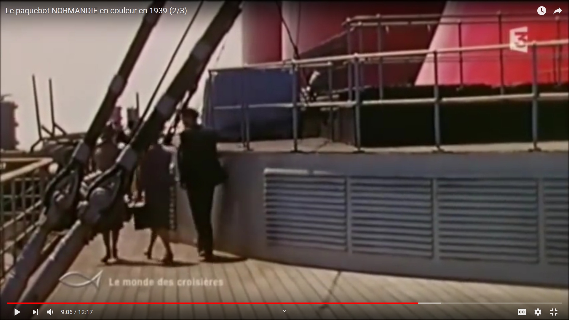

spanning the fore and aft antenna cables-- spanning from foremast upper yard-arm via centre funnel spreader back to aft mast yard arm
I also needs to be very thin, barely noticeable....
even in 1/700 that is quite a span!
--- will report in how that goes..! :Mad_5:
below image of the real thing!
JIM B :wave_1:
