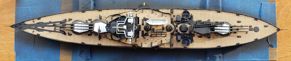

Ok, as promised, WeeVee's current state. Both ships have the pair of rear 3"/50cal. guns installed. These are from Blue Ridge. Superb versions.
