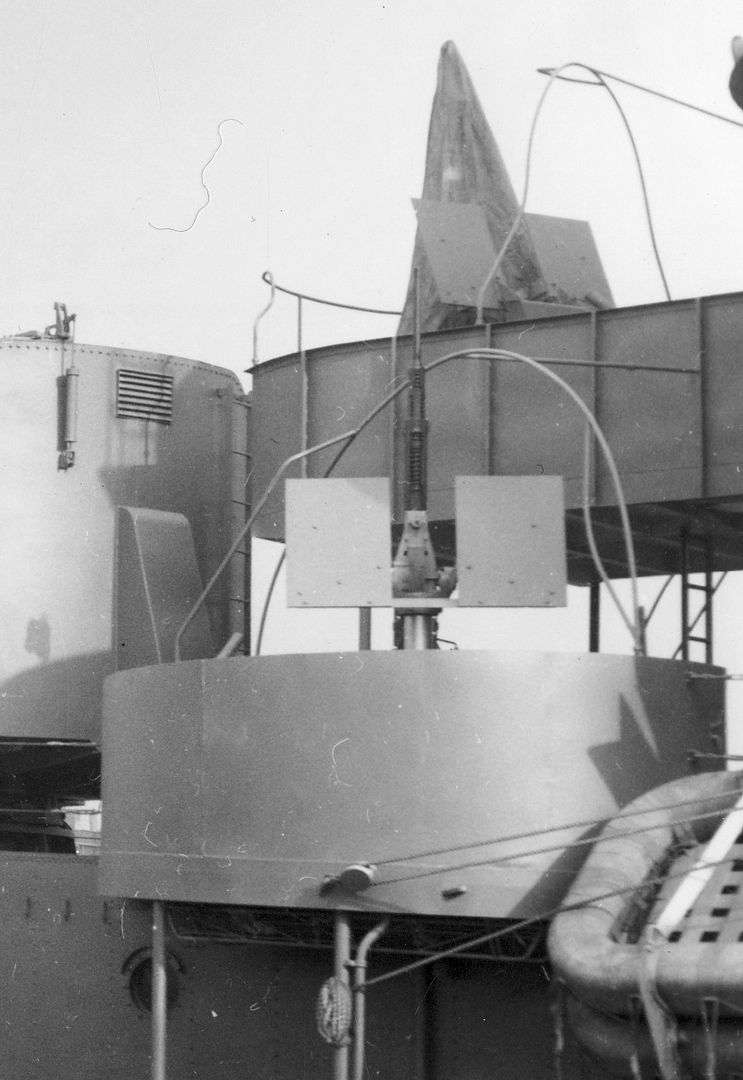

So my friend and I have been digging more into the topic of USS Chevalier DD-451, the damage sustained by the ship and its eventual sinking. While studying different blueprints for the 20 mm AA position in front of the bridge we never once found any sign of a ladder leading there. Which, obviously, begs the question, how did the gun crew get there? Any ideas or data, perhaps?
And then there's the damage of the front superstructure. A diagram on navsource shows the first floor dented inwards and the second floor inclined forward with the deck between the bridge and no. 2 5" turret blown upwards towards the bridge. Could a long lance torpedo explosion inflict such damage, even if the shells in ammo handling room under the no. 2 5" turrets exploded as well?
Last not least, it appears the torpedo explosion left the forward fuel oil tank burst open. To properly replicate this on a model it would be necessary to know if the oil tank was mounted on the keel and bottom longitudinal beams essentially forming a double bottom or did the tank's bottom coincide with the ship's bottom. The inside view pictures of USS La Valette suggest the latter, but better ask twice than get it wrong, right?
Thanks in advance, as always.

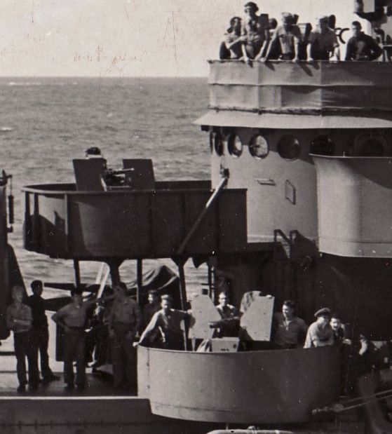

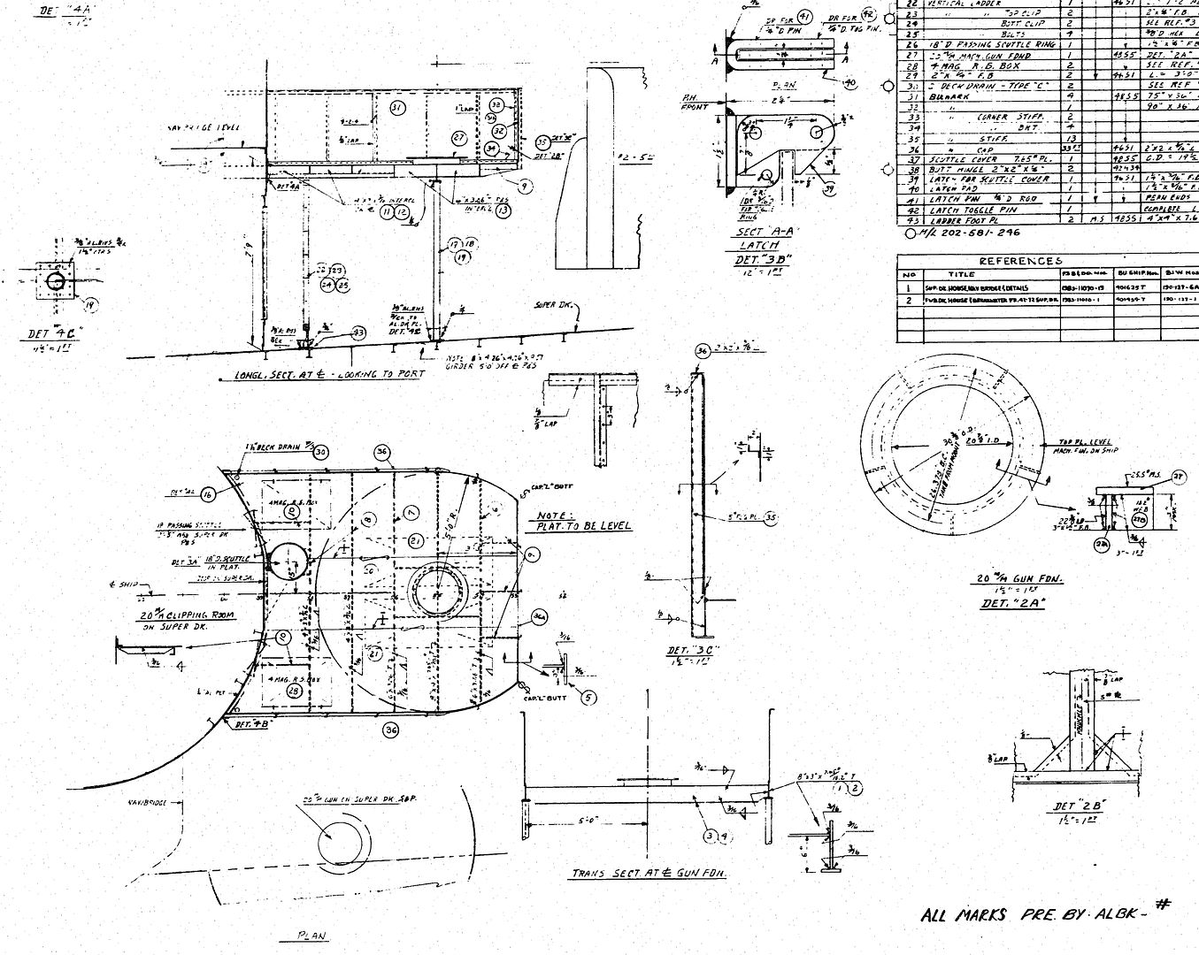

There were at least three different designs of the elevated center-line platform for a 20-mm gun on FLETCHER's (another similar platform used on BENSON-GLEAVES class units, plus designs unique to other destroyer classes). BosNY and NYNY had two slightly different designs for Round-Bridge FLETCHER's. A third design was made for Square-Bridge FLETCHER's. The BosNY design had a crew access and ammo passage through the bottom of the platform with a ladder under the platform. Meanwhile, NYNY had an access on the portside of the platform with a ladder run up the face of the bridge and smaller ammo passing shuttles through the bottom. The BosNY design had an issue with the access being just outside of the working circle for the 20-mm gun. I don't know if there was a hatch cover over the access or how they managed not having a crewman fall through the hole in the deck. So I have wondered if crews altered the access in the forward areas? In any case, it appears that the NYNY design was used on FLETCHER's built at other yards.
As far as dimensions of the NYNY-style platform, it appears to be the same or close to the BosNY-style platform. The most obvious structural difference, is that the NYNY-style platform has more "rounded" edges forward, while the BosNY-style has a more cutoff "square" appearance.
Getting good closeup images of the platform, with overhead views next to impossible, are rare. Here is an image of the platform installed on a sister, USS HUTCHINS, built by BosNY that had the same platform installed.
Here is an image of USS SIGSBEE with the NYNY-style platform showing the access opening in the portside bulwark and ladder location.
As for your structural questions about damage done, I refer you to the attached link to the BGP for USS SIGSBEE (DD-502). She was built at Federal Ship Bldg. and this BGP shows her in a different configuration to CHEVALIER when lost, but the below decks layout in the damaged area that didn't get separated from the rest of the ship is going to be the same. Particularly as far as location of oil tanks and such. Hopefully, these plans will provide you with the detail you need. I would need to guess what all you needed and try to post images. By studying the plans yourselves, you can assess want you need. That part of the ship would be a very tangled mess of structural metal, electrical, piping, etc., from the explosion and there are no photos and the Battle Damage Report is somewhat of a best guess. So, there really isn't an absolute appearance in trying to model the damage.
... https://www.hnsa.org/wp-content/uploads ... /dd502.pdf ....
And YES ... when the torpedo hit and exploded the 5-in ammo magazines, the degree of destruction is great.

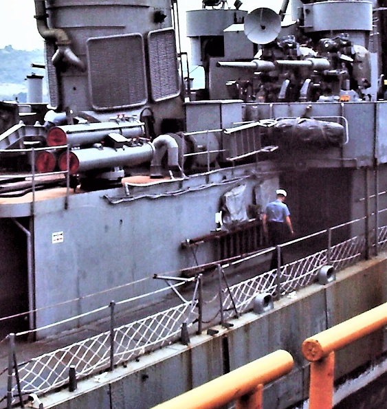

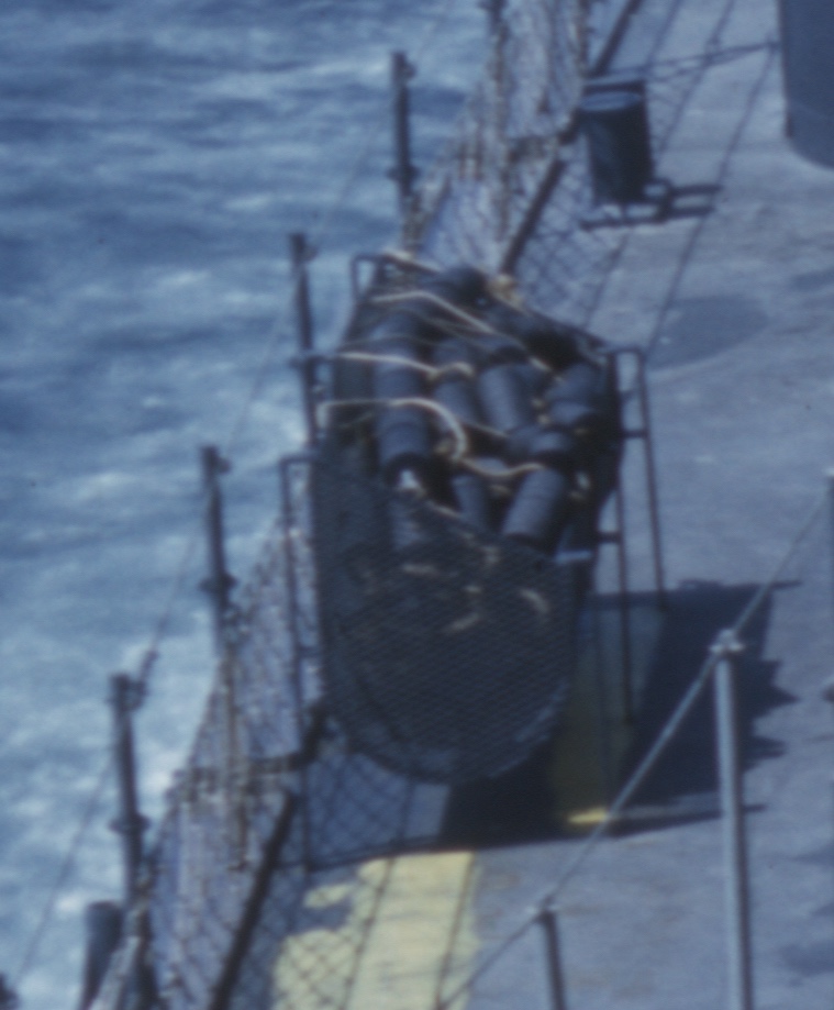

I don't know how to answer your question. For the USN the deck was painted with a standard paint, "20-B Deck Blue" during most of the war. But as can been seen in onboard images, the decks took a lot of abuse from foot traffic and weather/water while at sea and staining from refueling operations. So at various times, there was visible faded and touch-up paint (yellow primer and fresh 20-B) making for a "spotty" appearance. The areas with non-skid, many time "rectangular pads" of non-skid material were cemented to the deck. Sometimes other types of non-skid that appears to be applied as a continuous roll or like a thick coat of rough "paint", were used (or tried out as an experiment). As with the paint, the non-skid material could and did wear off in places. The USN appeared to painted over the non-skid as they did the rest of the deck, in appearance "painted non-skid" looked more "flat" than only painted metal deck.
Bottomline, I feel there is no single "or right" answer to your question. Depending on what ship and timeframe you are modeling "may" lean to different treatments. A destroyer fresh out from the yard after completion will look different than a destroyer constantly busy for a few months with combat missions/duties.
Just as "examples" and by no means general practice, here are a couple of views of decks in combat zones. CO's and Chiefs may well be more demanding in maintaining a "ship-shape" appearance.
In this image, note the "light" areas which are places where yellow primer has been applied. In a couple of days these same areas very well would have fresh deck paint applied over them.
This image, shows something that is rare to see in photos, the use of "mats" on the navigation bridge. I don't know your background or age, but these types of mats were used in places like shops and factory floors when I was growing up (50+ years ago).
Here are a couple of "cropped" color images of a destroyer decks, that gives you an idea of how the deck paint looked with primer and how the non-skid looked after some wear. The yellow zinc chromate primer started out looking fairly bright, but faded to almost a "tan" appearance if not painted over in short order.
