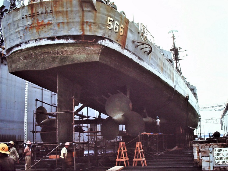

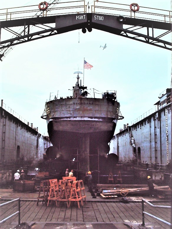

Here is a photo of STODDARD in the drydock in Subic Bay, PI in 1966 for stbd. shaft bearing replacement:
(photos courtesy of Robt. Schutte)

Pretty notable oil can smashing above the waterline, but not below. Wonder if that area was reinforced with some heavier STS plating?
Floating dry dock?

Fliger747 wrote:Pretty notable oil can smashing above the waterline, but not below. Wonder if that area was reinforced with some heavier STS plating?
Floating dry dock?
You know, I actually don't recall the drydocking at all - we were in for a week and then back out to continue on to the Tonkin Gulf - I had no direct involvement other than line tending - was in 1st Div. (SA at the time) and working on the boat deck (01 level).
As for the oil canning or not, I don't think the FLETCHER hull was anything other than 1/4" plate steel. The frames, however, I haven't looked into as to size or location, etc.

I believe the midships by way of the machinery spaces had 20# plate, where you can see the riveted butt straps and lack of oil canning. There may have also been 2# STS deck in their area as well. The idea was to give some protection against aircraft strafing. I imagine R.E.D would know for sure.

I can't remember where, but I think it was in Willie's build, there was a long discussion about oil canning and thickness of the steel plates on FLETCHERS. I looked at the BIW FLETCHER class Engineering Drawings DVD and found that the underwater hull plates were thicker and that the plates above the waterline were thicker amidships over the machinery spaces. USS STODDARD's oil-canning would look this bad due to her not having had a "re-skinning" done fore and aft during a recent overhaul. That is why you can find images of a specific ship with oil-canning and others with little during their career. Likely it wasn't done recently on STODDARD because the USN knew they weren't going to keep her in service for much longer.

Reading through Friedman's US Destroyers book on the Fletcher's wasn't very revealing on this point of use of thickened plates for splinter resistance. The "Jist" (term implying considerable uncertainty) was that the general board desired use of 20 and 30 # plate by way of machinery and control positions. As the ships became increasingly crowded with more equipment, later ships may have had such plate reduced for weight control, especially topside control positions. Other top weight modifications included reducing the height of the MK 37 director. Some do, some don't.
As to practical as opposed to nice to know, for modelers, mostly we can only be aware of some of the possibilities for platng and for an individual ship observe carefully the arrangement and condition of external shell plating. Certainly heavier plating below the waterline keeps weight in the ships in the right place and possibly more useful structurally than "ballast" as was employed in the Bensons.

Thanks Rick/Tom for correcting me on the FLETCHER 'Skin' thickness. I looked over the sectionals on the BoGP and I do think the machinery spaces, esp. had a slightly thicker plate steel than the majority of the ship's hull surface.
