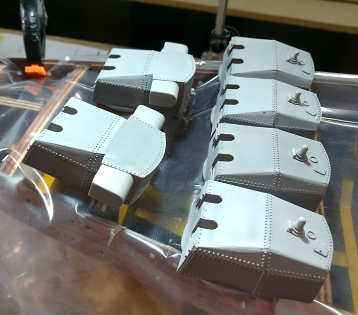

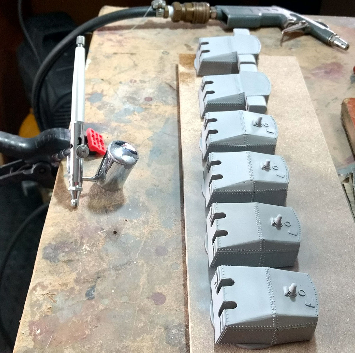

Hi all fellow modellers
SK/C-28 with first coat of primer.
production line
production line

soon news
SK-C/28 A.A. guns
SK-C/28 A.A. guns

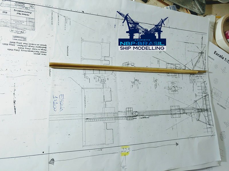

SK-C/28 A.A. guns
mast works
mast works
platform
platform

MAST
MAST

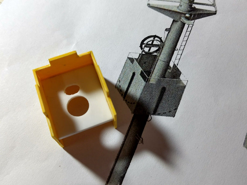

mock up SK-C/33
mock up SK-C/33
INTERNAL PARTS
INTERNAL PARTS
SK-C/28 rear
SK-C/28 rear
