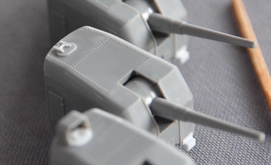

Hi again, folks.
While I think on how to make the b****y blast bags, I thought I could star detailing the many elements that will suffer no damage while handling the mounts for the construction of the said blast bags.
I started with the hatches on mounts 2 and 3. What you are given in the kit is correct but pretty basic, but it can be easily improved. First I made the inner elements with a scrap of plastic strip, two drills and a file. I completed the set with some stretched sprue, and after it dried, I refined it with fine sandpaper: Then I made the two hatches for mounts 1 and 4 that you are not given, following the same process: The mounts captain�s cupola is basically right, and big enough to be refined to give it the correct shape: Once the elements are set in place, they are like this: So after adding some other basic elements, the mounts are like this at the moment, waiting to dry completly and be further detailed: The next thing will be to detail the cupola and to make some other other easy elements in the front armor, unless I can start directly with the blast bags.
In the meanwhile, the mounts are starting to get some Fletcher shape.
I hope you like them, and very best regards from Spain,
Willie.[/size]
Willie.[/size]

Hi all once again, folks.
And after I have no fixed idea as how to make the said blast bags, I went on with further detailing. I have seen that there are many variations in the small stuff on these mounts, so I have followed the pictures that are closer to the hatches on board Jorge Juan. I have already made the doors on the front shields, using pieces of Evergreen profiles and stretched again sprue. They are like this at the moment: Best regards from the North Atlantic,
Willie.
Tom, thanks a lot for the tip and the excellent sketch. No doubt it will be of great help.Fliger747 wrote:Some bare dimensions for the gun Captain's slewing sight taken from the HNSA Gun and turret catalogue.
Marijn, again an excellent tip, and this while I am still in debt with you for the #15 scalpel that led me to the light after so many months of darkness looking for a solution for the oil canning on the hull. I will seriously consider this option too.marijn van gils wrote:One option for the blast bags would be to sculpt them from two-component epoxy putty. (...) My preferred brand is Magic Sculp. (...) I would apply a blob of mixed putty, push it into the general shape of the bag, press the folds in it, and then gently refine and smooth the folds while the putty starts to harden. If there are any imperfections to the surface, these can be carved or sanded after hardening.
It does. Actually it also helped to give me a shock when I read your message and realized of the new blunder in the kit. I was following straight away the detailed drawings in AOTS The Sullivans, which reproduce the same mistake as in the kit barrels, and had never realized about the true lines of these barrels.BB62vet wrote:One thing I've noticed about the kit gun barrels - they have a "joint" in them that was not there. Here is a photo of USS STODDARD's Mt. 53 & Mt. 54 in 1967 when we were in drydock in Sasebo, Jn. If you notice, the barrels are smooth from the muzzle back to where the barrel disappears into the gun mount housing. Hope this helps,
My shock had to do with bleak visions of the sanding and pasting that you mention, with the mounts already closed and very little room to work, but I later realized that the mistake in the barrels begins at the very same point where the ring to set the blast bags has to be fixed, so there is no need to make any kind of correction, as the blast bags will cover all inaccuracies. This is also the reason why I have not closed the gaps around the trunions in all four mounts: uncomfortable, and unnecessary. I have already set the rings around the guns, made with stretched sprue, and I feel much better.BB62vet wrote:I don't know why the kit manufacturers can't get this detail correct. I would suggest gently sanding the barrels until they are one smooth surface; perhaps add some putty prior to sanding, etc.
Willie.
