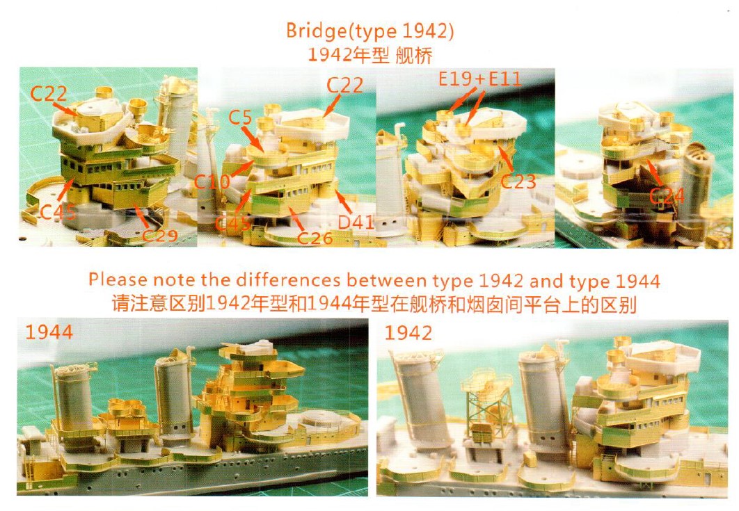

Now about the FiveStar San Francisco PE set. I had a very positive experience with FiveStar set for the Tenryu, the set definitely looked nice and comprehensive on their web so I ordered it as a solution for improving the Trumpy kit and adding detail. It contains 7 brass sheets and turned brass main gun barrels. FiveStar promotes you can build 1942 or 1944 version out of it, but upon closer inspection it appears the set was primarily designed to build the 1943+ San Francisco with parts for the 1942 version added perhaps as an afterthought. This can also be seen in the instructions, where the 1943+ version is covered in detail on several pages while for the 1942 version only the bridge and searchlight tower are shown on just over half a page in total.
To my deepest regret, FiveStar designed their version of the pre-refit (1942) main bridge not as a full replacement, but rather as an overlay to the original Trumpeter parts (see the part of the instructions relevant to the 1942 bridge below). This maybe makes the construction a bit easier for a beginner, but what beginner would buy such a comprehensive set? As a result, one would end up with bulkheads and splinter shields even thicker than the – already quite thick – Trumpeter bridge :(. More ambitious modeler is then left with not only having to cut off the unneeded plastic bulwarks but also to gluing stripes of plastic to compensate for the width of the plastic sides of the bridge where those are not used. Honestly, if I realized this before buying the FiveStar set, I´d likely have rather resorted to designing entirely my own bridge in either PE or 3D.
Another annoying feature of the FiveStar set is that some parts – like bulwarks of the bridge, overlay of the hangar superstructure or overlay for the forecastle deckhouse – have accentuated edges by relief-etching, quite unrealistic when compared to the real ship. I am considering to amend this by using these parts reversed, putting their flat reverse side outwards. The disadvantage is that I´d lose relief detail where I liked it to stay, so I´d have to add those details separately. Funny enough, the replacement bridge for the 1943+ version does not have these accentuated edges, so it definitely comes out much better – if it wasn´t totally useless for anyone building the original New Orleans class members as they appeared in 1942.
FiveStar also tried to make life easy to the modeler by having the bending lines etched all the way through in dashed lines. The advantage perhaps is you won´t need a bending tool, but you´ll end up with visible dashes over the bended joints that you´d have to fill in or leave them as they are.
The part I disliked at the very first sight was the 1942 searchlight tower. Compared to the much older Tom´s Modelworks set the latter comes out definitely better to my eyes, although not perfect. I will enlarge about my solution to this problem later.
Last but not least, it´s also a pity that FiveStar forgot to include the SC radar for the 1942 version. I really regret it as the rendition of the SK radar for the 1943+ version looks really good!
On the positive side, there are some really nice looking and detailed parts in the FiveStar set, such as catapults (they sell them also separately) incl. overlay for the catapult bases, or crane arms.
Overall, I can see both positive and negative sides of this set. I think the 1943+ version comes out just fine. Modeler of the 1942 version comes out much worse, unfortunately, as he bought many more 1943+ parts that are useless to him (I guess at least one third of the set, maybe even more) while some of the large important parts he needs are not really perfect and the coverage of this version in the instructions is inadequate. Let´s see how useful this set will be to build the 1942 version of the original New Orleans class members in the end.

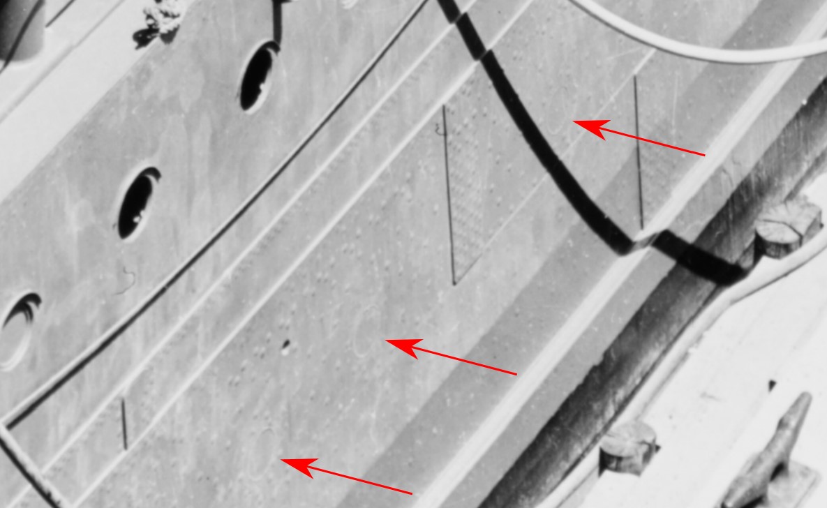

Next step are the portholes. I´ve got no close-up photo of Astoria showing how exactly her unneeded portholes were covered during her prewar refit but SF photos show very little hint of them remaining so I think it´s ok just to fill those in and sanding flat after their relevant eyebrows are removed.
20210107 Removed portholes on SF at MINY 19420519 cropped from 19-N-30281.jpg
20210107 Removed portholes on SF at MINY 19420519 cropped from 19-N-30281.jpg [ 109.75 KiB | Viewed 5712 times ]
I am using plans by Profile Morskie for Astoria (basically redrawn BOGP) and MMP Books for Vincennes, crosschecking them to photos. Both ships will be depicted as in combat readiness at night so all remaining portholes should be blinded. I still hesitate whether to use PE for them or just fill them in and make them a bit more amplified by punching slightly over the filler. The Trumpy eyebrows are quite good so I don´t think they need to be replaced at all cost. Any ideas welcome!

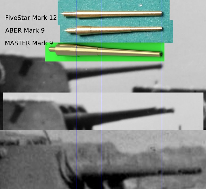

Astoria had the “round face” turrets for her 8“/55 Mark 9 main armament, another documented difference between Astoria and SF. Unlike New Orleans and Minneapolis, Astoria´s “round face” turrets were unique with two vents located at the back as opposed to below the rangefinder arms like all her sisters (incl. those with “flat face” turrets with Mark 12 guns).
I bought the ABER 8"/55 Mark 9 turned brass barrels for my Astoria some time ago. Unfortunately, they look different than barrels on photos of Astoria (or actually any other Mark 9 barrels) so I am not going to use them. The FiveStar Mark 12 actually look much closer to Astoria photos although they should be slightly slimmer. Anyway, the FiveStar Mark 12s will find their use on the Vincennes later on.
There are two more accurate turret solutions for the Astoria. Master released Mark 9 barrels in the meantime, these appear much better than ABER and are “fatter” than the Mark 12 as they should be. Master designed them without blast bags so one would have to sculpt the bags as Astoria had them installed while supporting the Guadalcanal invasion.
The other option will be the Red Devil/Kraken 3D printed Astoria turrets that are planned to be downscaled from their 1/350 Astoria upgrade set. As I tried to help with their development I´m hoping to go down this way :)

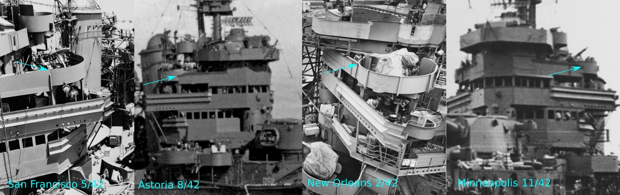

Okily Dokily, I just recognized that my searchlight tower was maybe nice but suitable for San Francisco or New Orleans, not really for Astoria (or Minny) :cool_2:
As shown below, SF and NO had supports going fore and aft around the vent down to the deck. Supports on Astoria and Minneapolis were still there (thanks to Dick J for pointing that out to me :thumbs_up_1: ) but these did not extend outside the rounded roof of the vent. Otherwise their searchlight tower construction was very similar to SF and NO, unlike in case of Tuscaloosa, Quincy and Vincennes that had different narrower searchlight towers „sitting“ on top of the vent.
So by now I designed three versions of the NO class searchlight towers in PE – or more precisely four as Tuscaloosa´s lower half was overplated and I already modified my PE for a friend of mine to reflect that.
File comment: Original photos can be found at NHHC under catalog # shown
