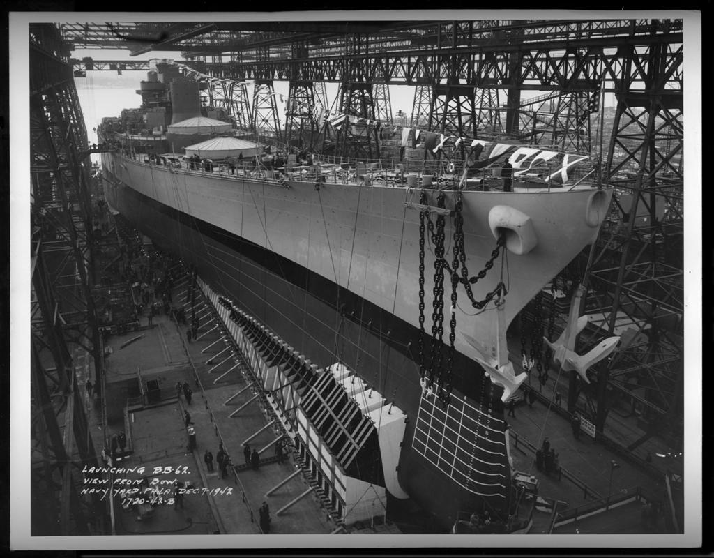

When launched, the 4 IOWA class BBs did not follow a single protocol for what was or was not aboard at launching - here are some photos to illustrate my point - BB-63 DID have her 20mm bow enclosure in place, BB-61 did NOT. BB-62 did NOT, BB-64 I can't confirm - no launch photos. Here are some photos to explain:
BB61 -
BB62 -
BB-63 -
Additionally, here is a photo of IOWA's 20mm Bow enclosure from the deck level:
Each shipyard handled things differently as to how much of the ship was actually completed at launching. Most were fairly incomplete (lacking 16" turrets, 5" gun mounts, all smaller arms, etc.) and the ship was then towed to a "fitting out" pier nearby for months of completion of all shipboard systems prior to a Shakedown Cruise and subsequent commissioning.
Edit - So, here is a bow plan I converted from a .pdf BigJimSlade sent me - this shows the configuration of the 20mm mounts as they were designed on IOWA class ships.
Hope this helps,

Quite right about the precise state of completion at time of launch; my point earlier was that both Iowa and New Jersey commissioned without bow 20mm tubs. And yes, ships are known to commission slightly incomplete at times (Washington is a fantastic example, see: http://www.navsource.org/archives/01/015646.jpg Iowa likewise still had work being done: http://www.navsource.org/archives/01/016122.jpg ) But photos of both ships during the months of their shakedown periods show no obvious signs of intended items left off till later; it seems to me that the bow tub, like the pair of 40mm quads that replaced the pentagonal 20mm enclosure forward of turret #1, or New Jersey's enclosed bridge, were "additions/revisions," not "completions." And, of course, all three elements were incorporated into Missouri and Wisconsin before commissioning (and the bow tubs are present at launching!)
- Sean F.
PostPosted: Sun Jan 24, 2021 1:00 pm
Posts: 1843
Location: Mocksville, NC
I've just edited my prior post to include the bow plan that BigJimSlade discussed a few posts back.
To what SeanF just posted - The IOWA class (as were other USN warship classes) were in a constant state of "evolution" - their continual changes in anti-aircraft defenses were on-going as were modifications to superstructures; this state of "flux" in what actually commissioned from the origiinal builder's plans is a study in itself.
Understanding the differences between the ship "as launched" and the ship "as commissioned" AND subsequent alterations made after initial shakedown and 1st deployments helps one understand that nothing with these warships was static - I'm fairly sure that the initial battle reports coming back to the Bureau of Ships from all theaters of combat more than likely contributed greatly to how the follow on ships were configured and thus commissioned.
Ships that are launched are still "under construction" - lacking most, if not all weapons systems, very little of the final superstructure, and no masts/RADARs, etc. - a lot of this has to do with the location of the launching ways, depth and breadth of the waterway where this would occur, and other logistical factors which would make launching a "completed" ship almost impossible.
Hope this helps,
