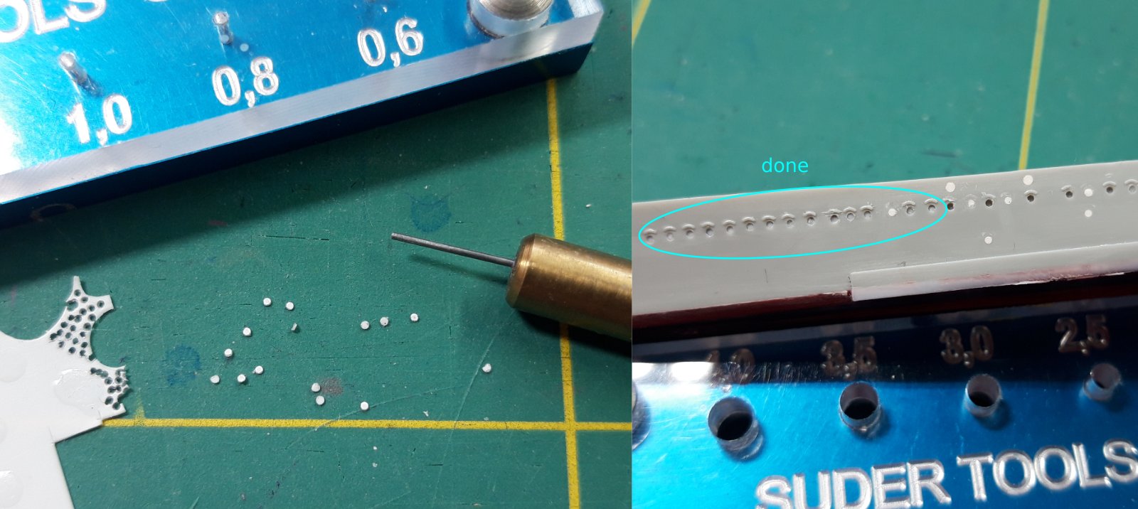

I hesitated how to best imitate portholes closed for combat. Options included PE and putty, but in the end I decided to fill them in partially using 0.6mm diameter �lids� punched from 0.2mm plastic sheet. It went really well and fast, for sure faster than aligning PE portholes. This left the last approx. 0.1mm depth open so I think that will be about right. I also removed the original hawser �ring� and replaced it with a slant cut plastic tube.
Unfortunately, my hole puncher broke when finishing the work on Astoria, so I�d be getting a replacement one for Vincennes.

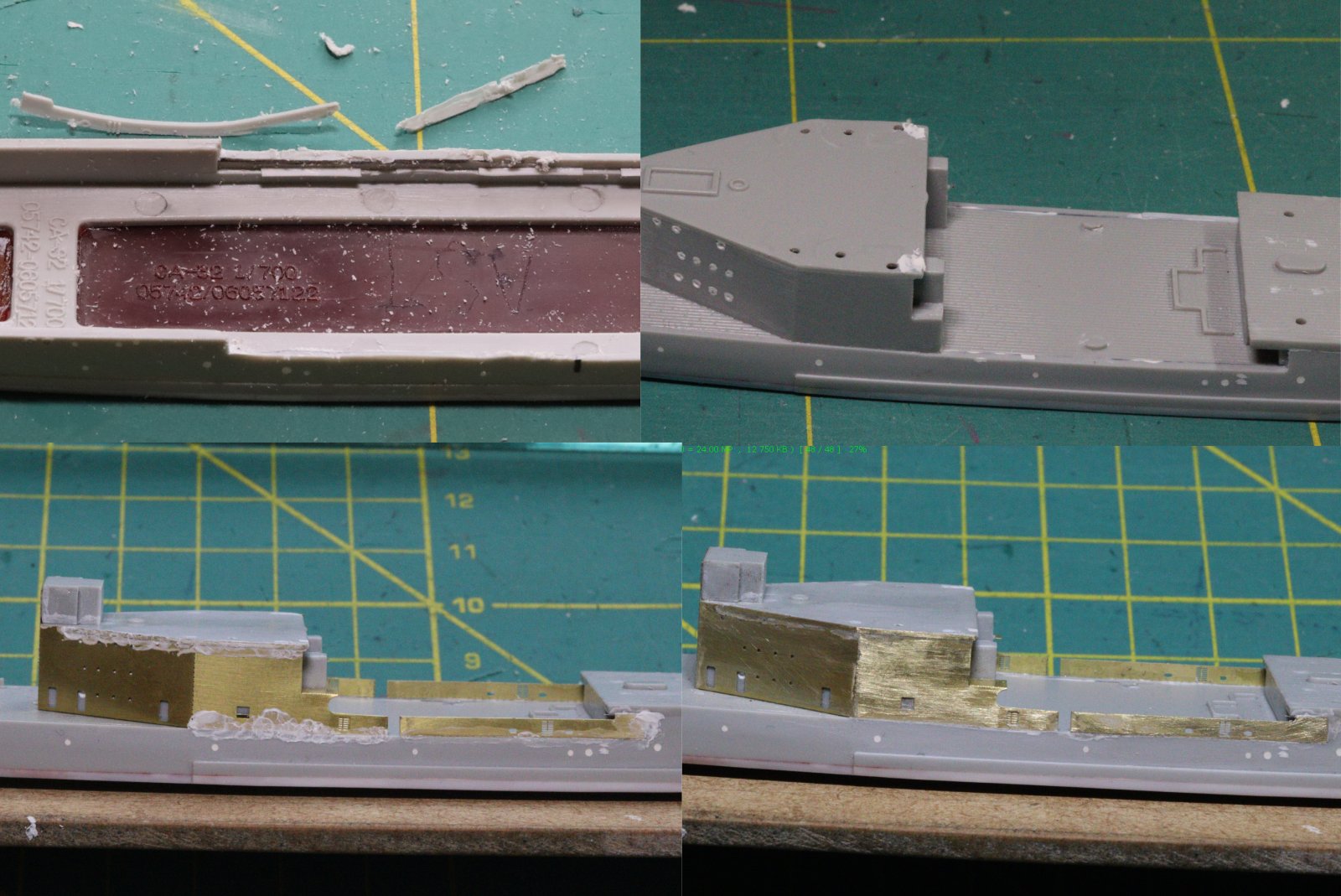

Then I continued with assembling the hull and deck. The Trumpy kit does not fit the best, the deck (especially aft deck) attempts to submerge quite deep into the hull and I needed to add some pieces of thin plastic sheet to prevent this. The fit of the hangar to the hull is not the best either. I decided to use the FiveStar parts for hangar sides and bulkheads of the well deck to blend hangar sides into the hull better and to make them looking a bit sharper. It was not a really an outright solution as the FiveStar set is intended for San Francisco with her hangar roof overhanging the sides of the hangar, so I had to add an extra 0.5mm wide brass stripe along the roof to compensate for the difference. Using the PE reversed also paid off as additional puttying and sanding was needed in order to make the transition between the plastic hull and PE parts smooth, this would not work with the original relief etching. I found no proof of two large vertical hatches (?) on the aft side of the hangar structure on Astoria (neither on SF) so I filled them in. Also note the modified lower part of the aft bridge � there was an open part just aft of the mainmast at the hangar roof level (see photos and BOGP) as opposed to the Trumpy kit.
By the way there are two versions of the hangar overlay provided in the FiveStar set - one for 1942 version (with roof overhang) and another for 1943+ that differs in providing bulwarks in between 40mm tubs and the aft bridge. I wanted to use it (cutting of these bulwarks) only to find two mistakes in it: the height of the hangar walls has aparently not been adjusted to cover the excluded roof overhang and the aft wall is narrower than needed. It could be used with some adjustment but I decided to use the 1942 version and modify it as mentioned above.
By large I think the PE overlay is a good improvement of the hangar & well deck area. Not really easy to make it all fit, but better and safer than making the well deck bulwarks thinner by dremeling like I did in case of Quincy :smallsmile:

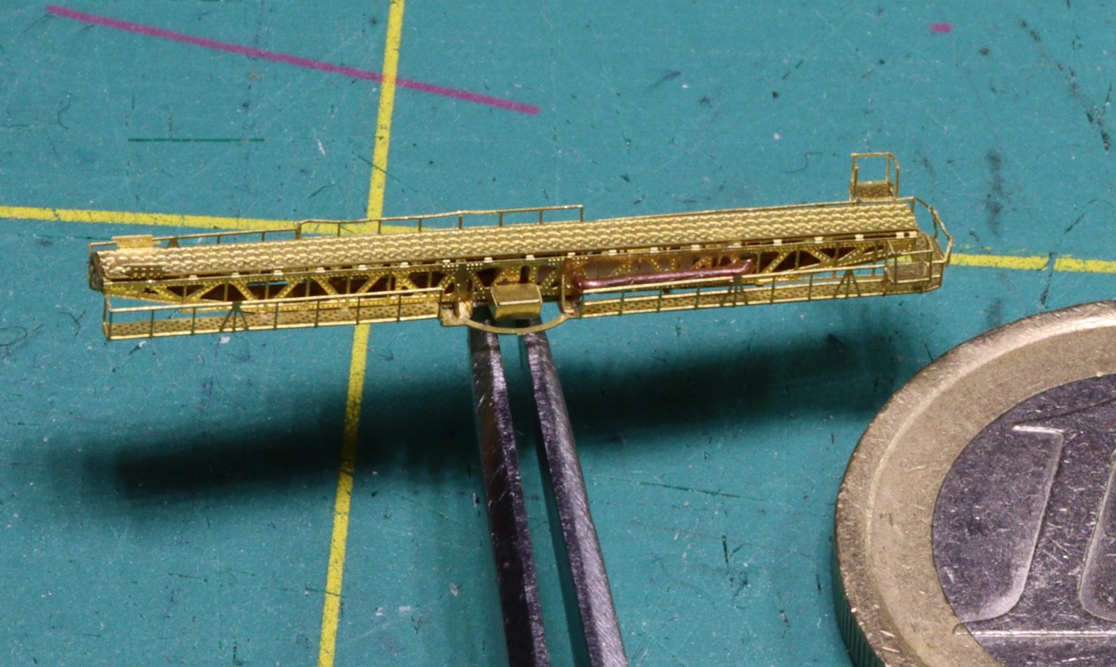

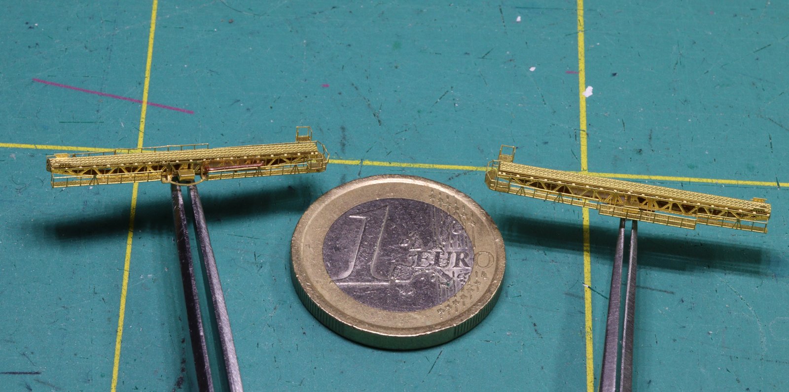

I thought the FiveStar catapults were the best I�ve ever seen in 1/700 from the very first time I�ve seen them. My experience now only proved this was the case. Each catapult consists of 8 pieces and the aircraft cradle. They are really delicate with relief etching and they even include the two small aircraft handling platforms at the back. Of course it is a lot of folding and extreme caution is needed while handling the part with walkways and railings. Actually, all the four small handling platfroms fell off when I worked on the cat and had to be glued back when done. I also added a piece of plastic rod into the inside (leading from the centre backwards) to simulate for the internal mechanism, and the prominent pipe on the left side of the catapult (looking along the flight direction).

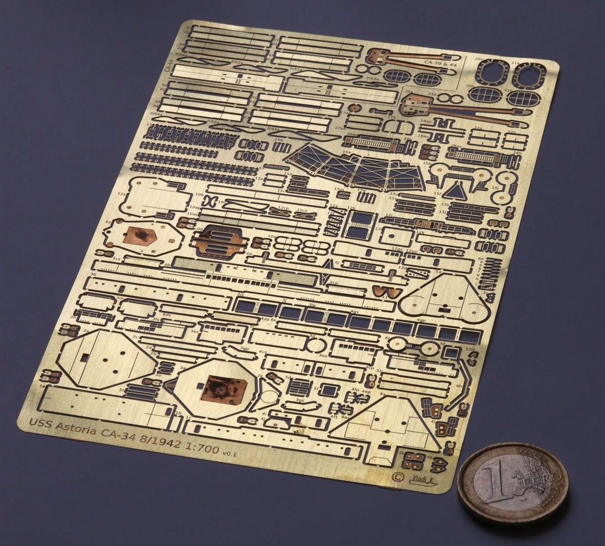

Haven�t done much on Astoria recently but it will for sure change now - my Astoria PE set arrived today!
It contains a completely new main bridge, searchlight tower, secondary conn & platform, 5in splinter shields plus some other parts.
Let�s see how will it all fit together ;)

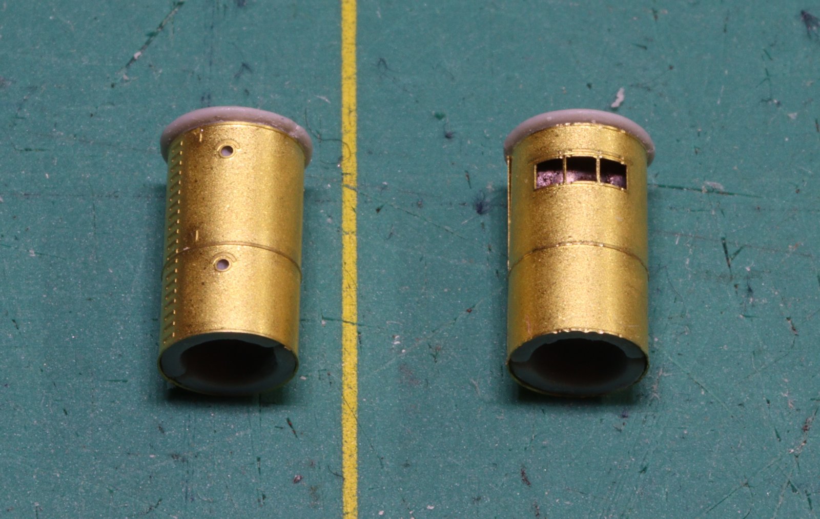

If you wondered what are the parts that you circled on the photo, these (and the others not circled) are platforms on signal and navigation bridge wings to man blinker lights, pelorus and similar equipment.

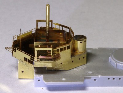

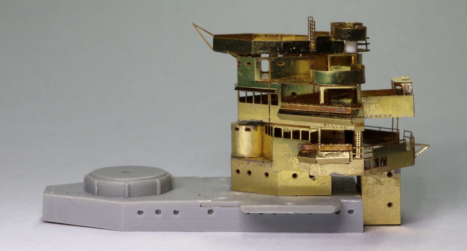

Tested the first two levels of the main bridge, looking quite good.

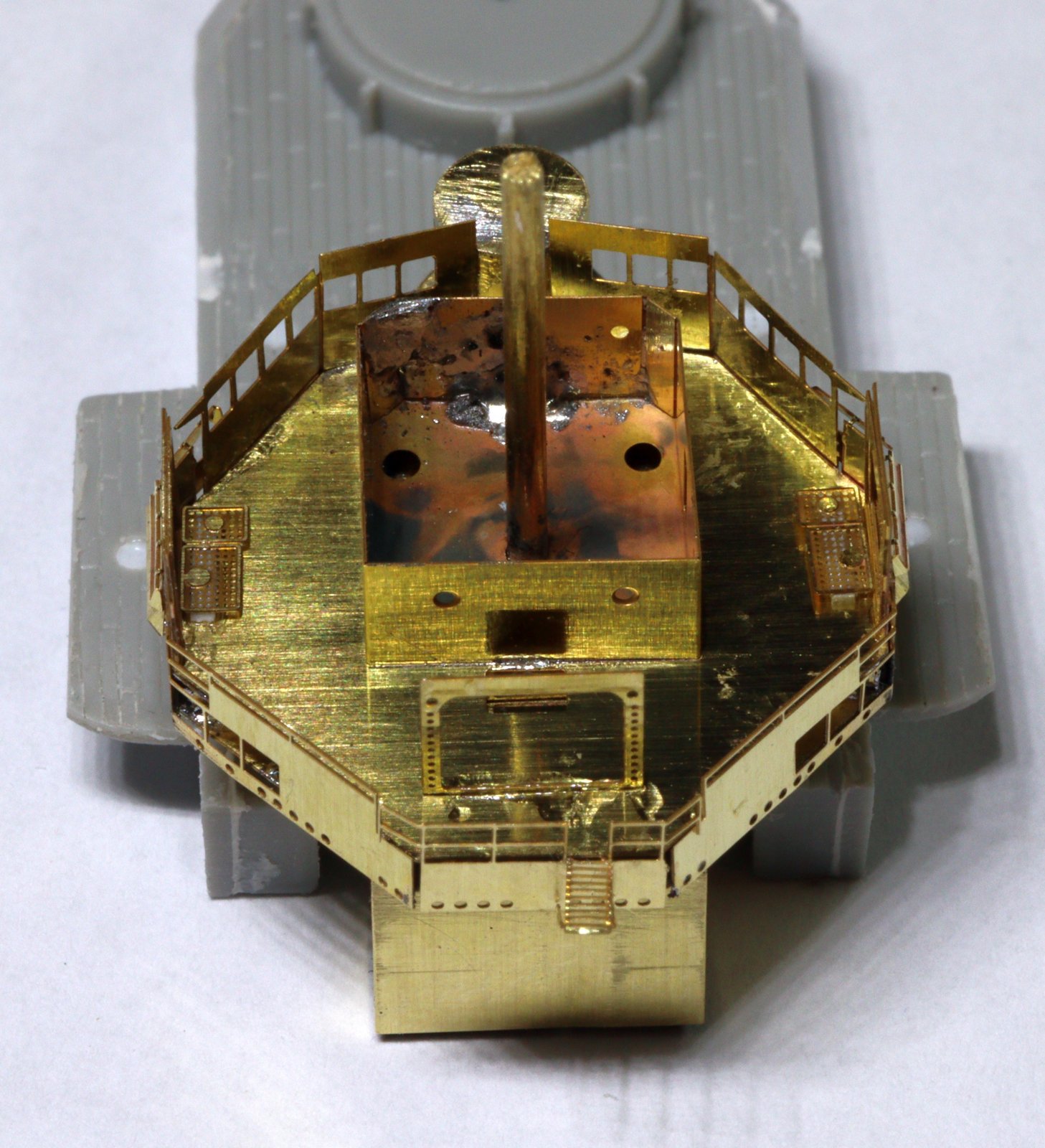

Manuel, note (two of) the small platforms you circled in the previous photo:

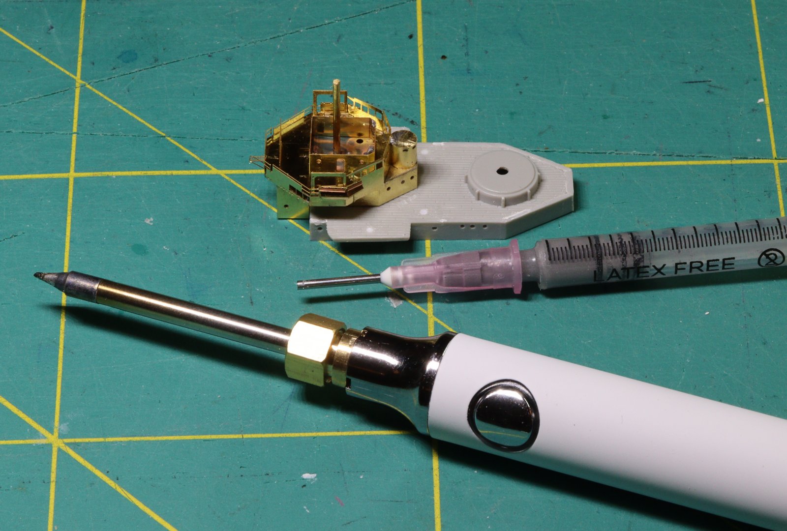

These are my two best friends for soldering PE - USB-powered mini soldering iron (my recent acquisition - very handy, really lightweight, ready to use in 15 seconds! Excellent value for the few bucks on Aliexpress) and soldering paste in a syringe. Recommended!

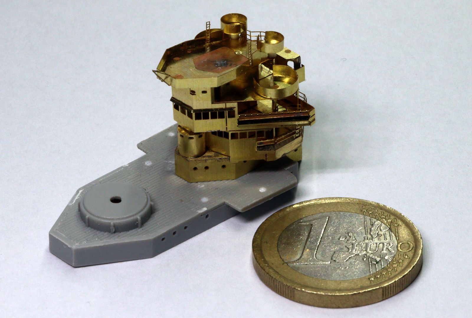

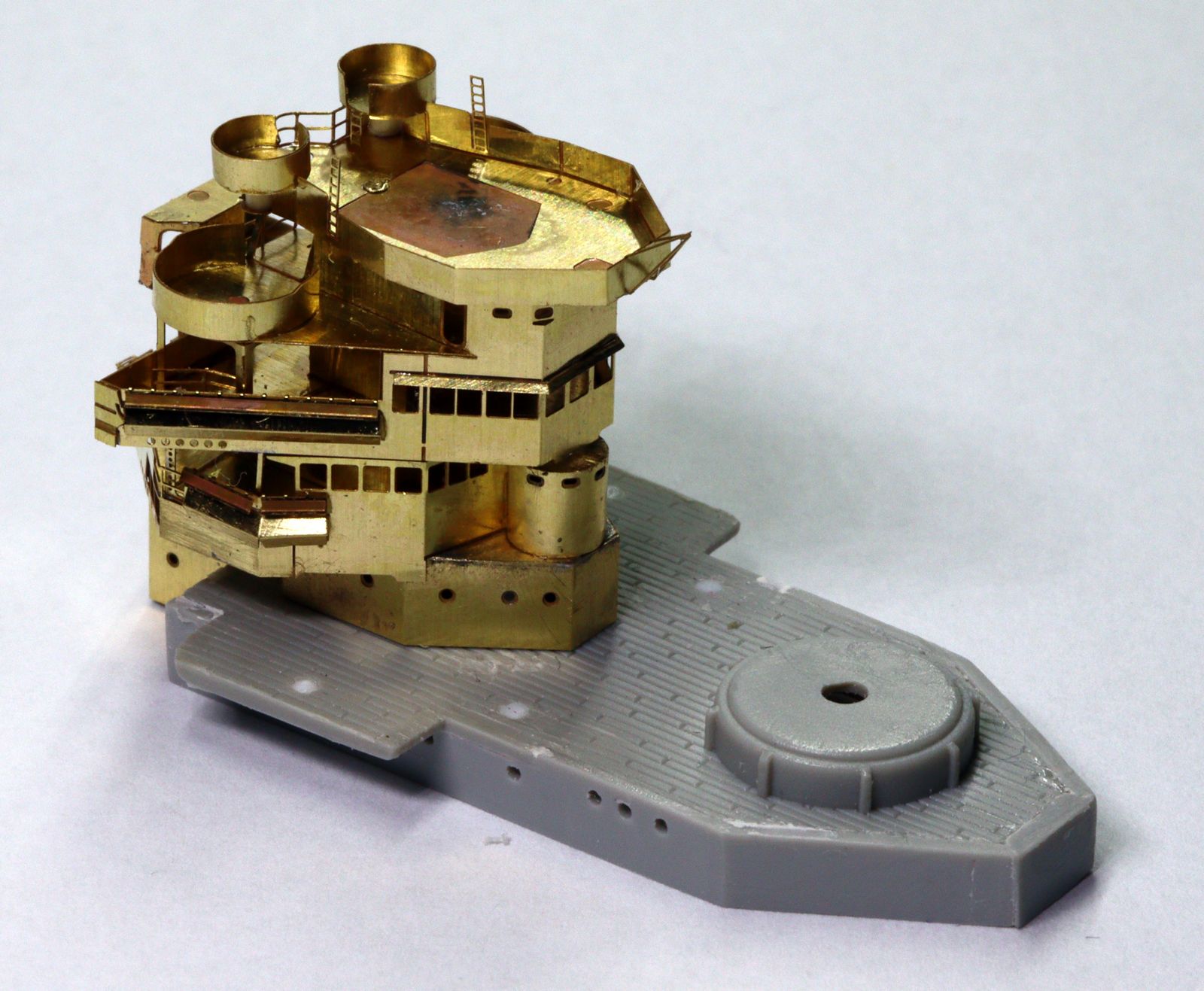

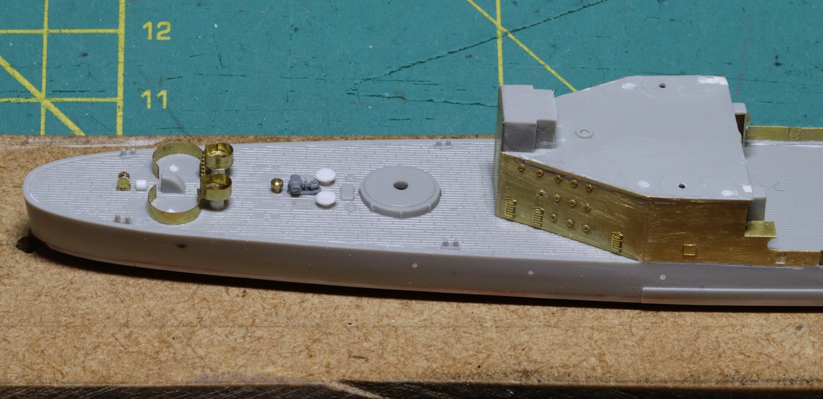

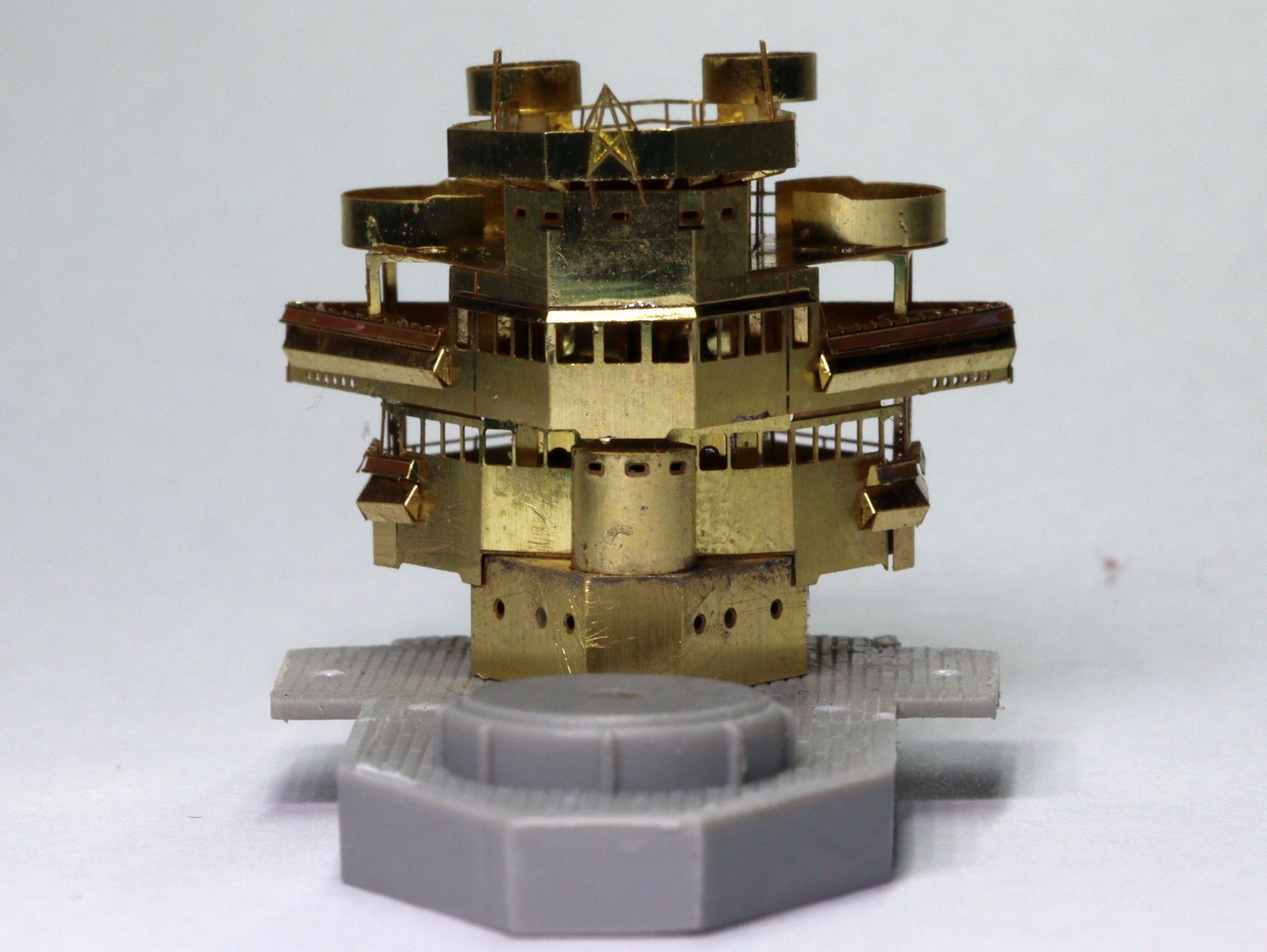

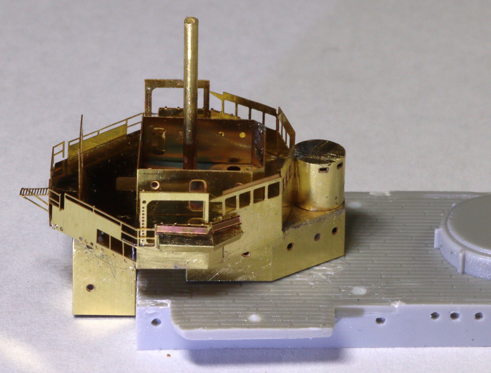

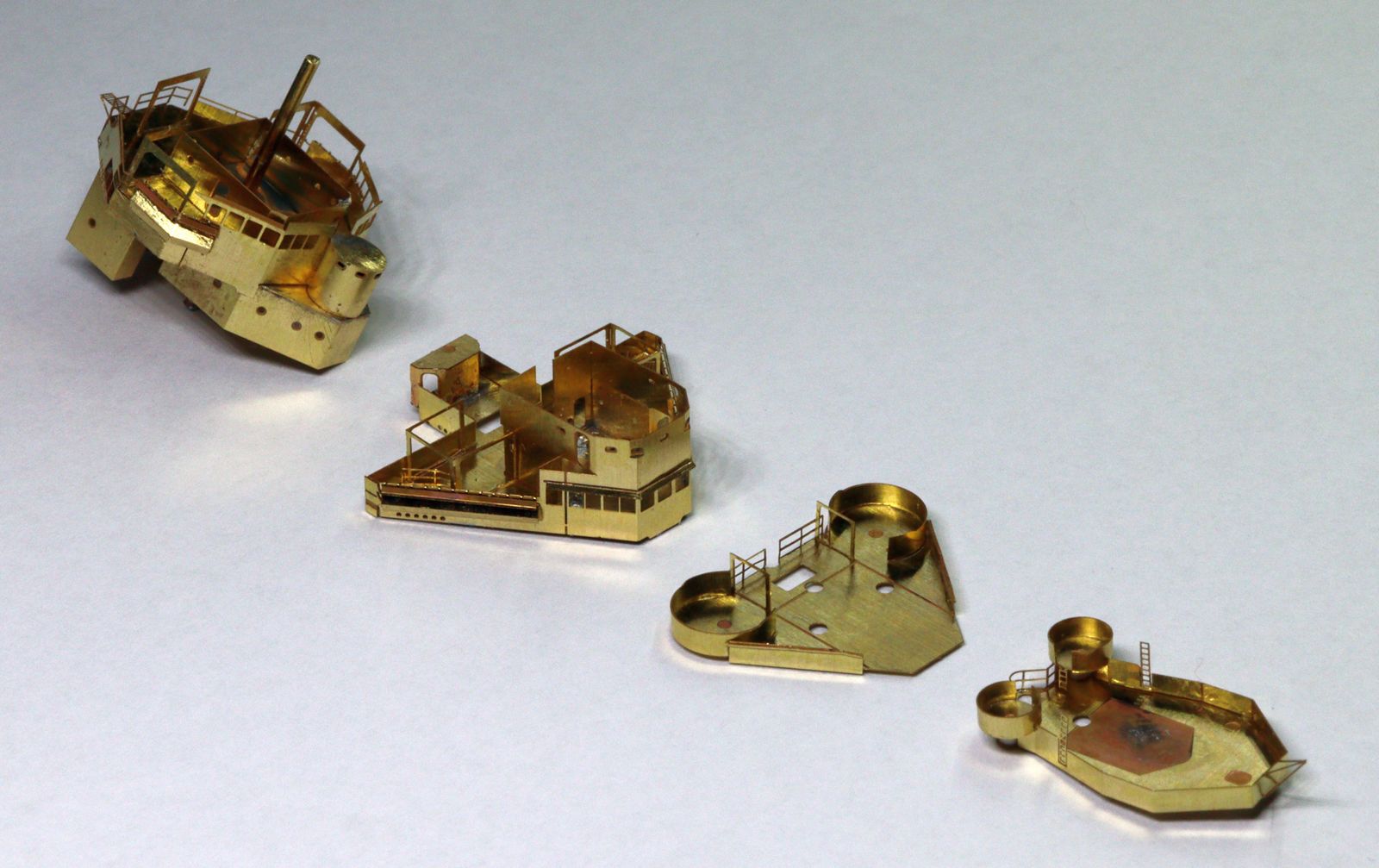

So this is where I am now. It was a good idea to have the central brass rod as a pivot inside the bridge (where the central ladder shaft was in the axis of the 5in director/rangefider), it makes it lot easier to assemble and keep the proper alignment. Also the assembly will be much sturdier and less wobbly than a structure made only of 0.1mm brass would be.
The bridge is dry fitted, many smaller parts still missing, but the basic fit and geometry seems to work fine. I made two small errors in the PE design (the height of the inner part at the signal bridge level and missing back side of the RDF booth), but both can be amended easily by scratch. Photos of course reveal some details that will deserve corrections, that�s the burden of macrophotograhy ;) . One has to look at the last shot for comparison with 1 Euro coin to realize how small the bridge in 1/700 really is.
Pieter wrote:Will it have a crew inside?
Now I think I should be able to spray the bridge partially unassembled and complete it afterwards, hopefully without too much spray getting to the inside when finalizing it.
So far so good :)
