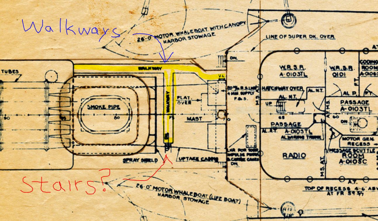

Then, a snip of plan found prior (thx whoever posted it!)
Looks like a section of walkway complete with railing running down port side of stack (similar to the catwalk on the rear deckhouse, BTW)
And then a transverse walkway that opens onto starboard side, accessed by inclined stairs & windbreak on deck level; heres the starboard side showing this.
The mods arent too difficult; removing the deck from DML part & adding walkways & stairs, but am I way off base here? does this config sound reasonably close to Laffeys ?

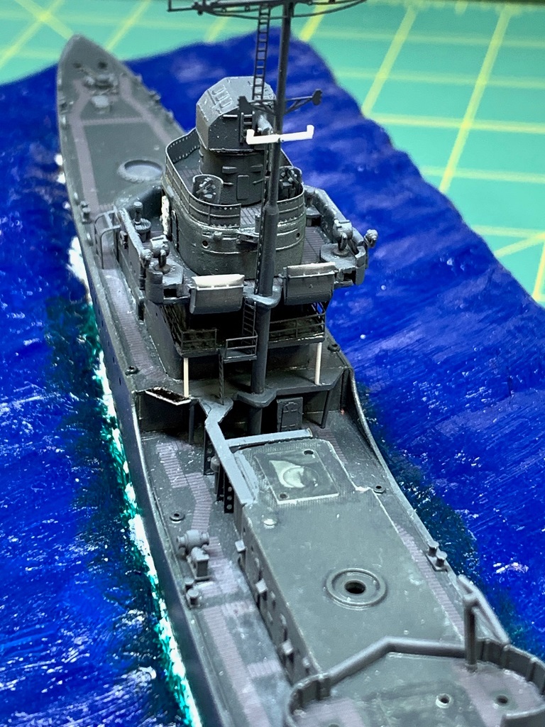

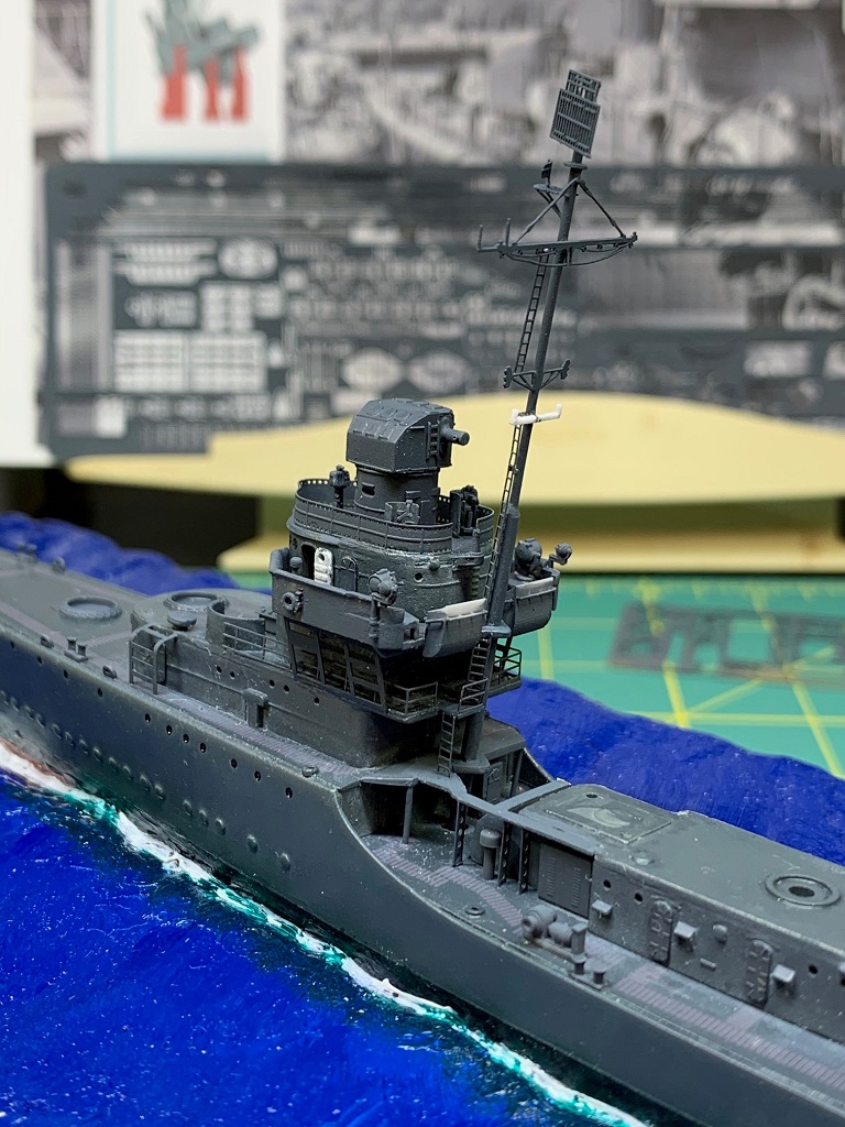

Posts: 8614
I've been working on the very same "conversion". Here's my take on it. I added a vertical ladder to the end of the walkway running port to starboard. I know it's not 100% correct, but it's what I could gather from plans and photos. It's also a bit of a mess, because, for some reason, I got an ill advised jump start on the weathering (I think I thought I was farther along than I was :doh_1: )
