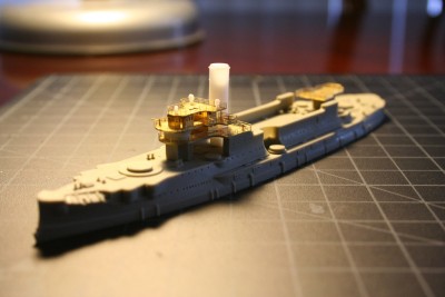

This is KomBrig's 1/700 Slava. It came with a photo-etched set by Star Model (China). Anyone know if there is a pre-cut wooden deck for this?

Looks very sharp so far. As Kombrig decks usually have very fine planking why don you mask and paint the decks?

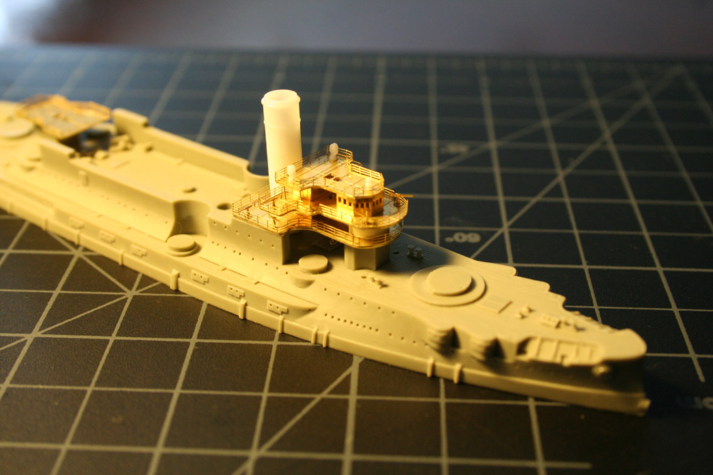

I really hate to say that En-TACT because you have done such a nice job on this kit. Unfortunately, both Kombrig and Star Model didn't...
This is how Slava's forward bridge should look like:

After the completion of Tamiya's IJN Battleship Yamato, viewtopic.php?f=59&t=161768&start=100v (I'll post final pics soon), be it my first 1/700 model, I've learned a lot working with that scale and PE parts. I will resume the Slava project with a plan of a docking scene and attention to much of the ship's detail - to start off, correcting that horrendous forward bridge.

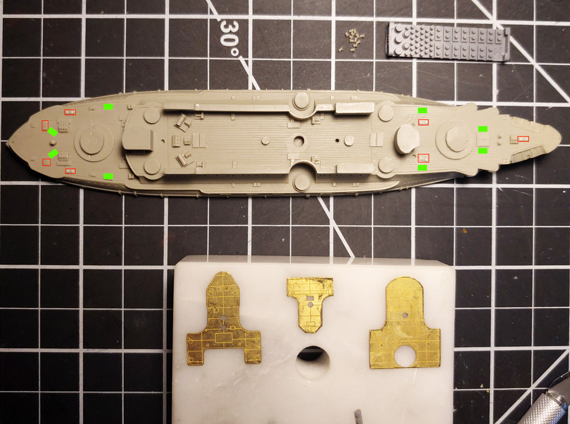

Re: 1/700 SLAVA (Borodino)
After reviewing the detailed schematics of the Slava (provided in the Russian book), I started to remove the casted bollards (boxed in red). The correct places are in green; will be placed with Shelf Oddity's bollards.
I'm finding many inaccurancies with this Combrig's Slava - I have a feeling this mold was meant to be another Borodino battleship??
