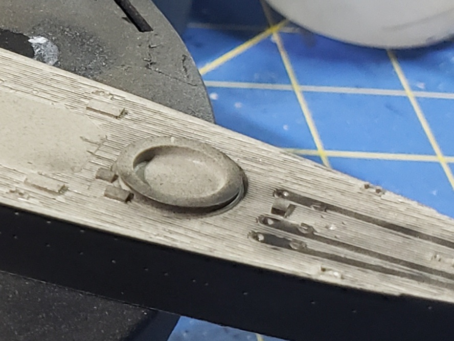

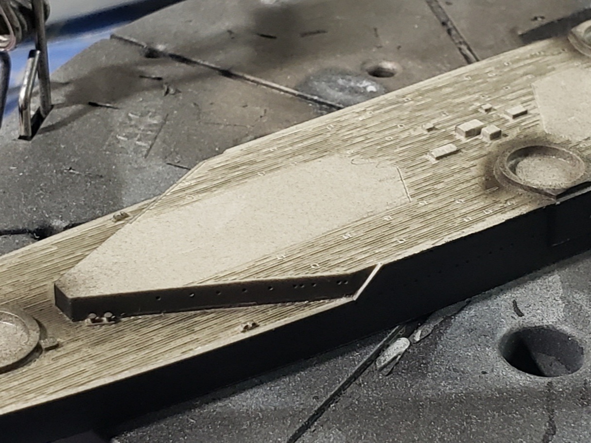

Hello, I've recently got a 1/700 Combrig HMS New Zealand, and I've tried your technique on the decks, just with a sharp no.2 HB, and it looks solid to my eye, but since the decks are ridged style, have a look, do you think it will translate well under a light sandy beige to look like a holy-stoned RN wood deck?
https://i.imgur.com/ZLa9Eci.jpg
https://i.imgur.com/CBzyxRl.jpg
