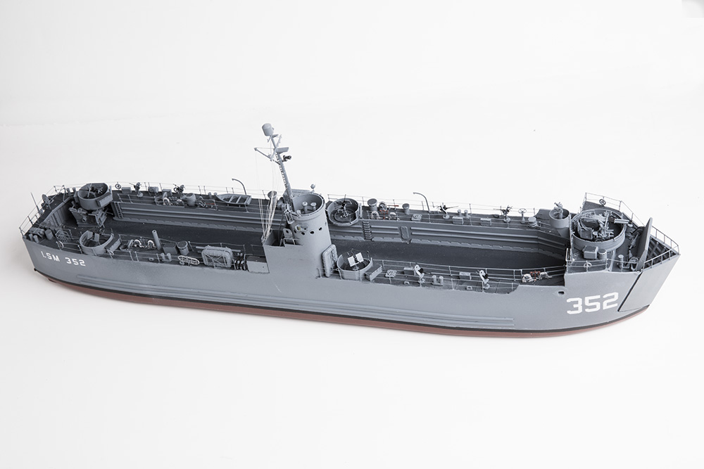

Today's progress? Finished the attachment of the draft marks and re marked some of the ships landing craft. In the movie, the LCVP's also had a small boats number in the upper corners of the ramp. The 8 pt lettering works well for this.
Tedious! Tom
Tedious! Tom

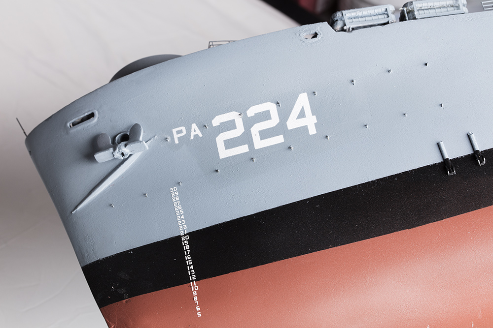

Bow hull numbers (done with stencil) and draft marks. Draft marks are 8 pt, measure out to about 1.9 mm high. Placed individually as press applies. To apply the stencil I had to remove some of the padeyes and replace after complete.
Tom
Tom

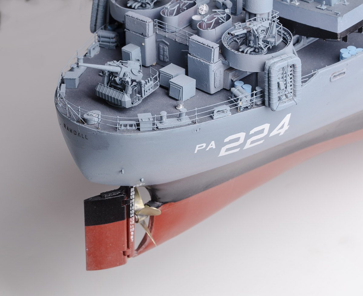

Today I did the ships name on the stern in black, using the Dr Phil masking method. As ships names are usually welded in plate and then painted, using stencils as press applies might have been better if I had a flat black vinyl.
Tom
Tom

I have seen some ships where the names were made up of flat plate letters welded to the hull. But during WWII I think it was more common in the US Navy to just weld a small (1/4 inch) bead outline of the letters and numbers onto the hull plating. This served as a guide when the hull was repainted. The waterlines, boot topping outline, plimsol lines,ship name, etc. were all done this way. This prevented "creep" of the important markings when the hull was repainted.
However, each shipyard had their own "right" way of doing things, so I suspect there was a mixture of both techniques in the fleet. But for mass produced ships the bead weld would have been faster and cheaper.
By the way, the draft marks on the bow and stern were checked on the morning and evening watches in port, and when cargo was being loaded and unloaded. Damage Control Central used the readings to recalculate loads to correct the ship's trim.
I agree that it was unlikely for the trim to be so unbalanced to make the bow or stern ten feet too deep unless the ship was sinking (serious battle damage). These readings could be used to determine if there was a chance of saving a ship and how much fuel, water or ballast should be shifted to counter flooding, or if the ship should be abandoned.
