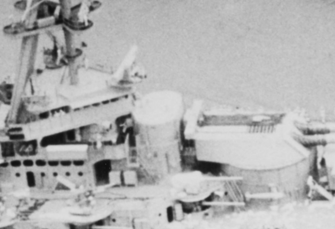

I recently received a request to help identify all of the locations of the life rafts on USS Nevada and USS Oklahoma on 12/7/41. This topic has come up a couple of times the past couple of years so I thought it's time to put it here for future reference. I'll try to do my best to show what I have found so far but I'm sure there are more rafts to be discovered on both ships. I'll start with USS Nevada first.
I think there were 3 sizes of oval life rafts used in 1941. 25, 40, and 60 man capacity rafts. Exactly which sizes are present in these photos I'll let you decide.
Starting at the bow and working my way aft, this is what I see on Nevada.
Turret #1 did not have any rafts on her sides or top. Instead, paravanes were stowed on the sides as seen in this pic.
As you can see from the above photo, turret #2 had rafts on the sides. A small raft inside of a large raft. There were also two rafts on the roof. They were placed on the starboard side of the roof.
I've been able to find only 1 raft on the superstructure as seen in this pic.
Moving aft, the vegetable locker on the starboard side had 3 rafts on the bulkhead.
Turrets #3 and #4 both had rafts on the sides. Turret #3 for sure had small rafts inside large ones. It is unclear if it was the same for Turret #4.
I suspect turret #4 only had a single raft hanging on the sides as seen in this pic.
Finally, turret #4 had 4 rafts on the roof. These rafts were painted white. You can see the crew lowering one of the white rafts into the water in this pic.
Hope this helps for USS Nevada!

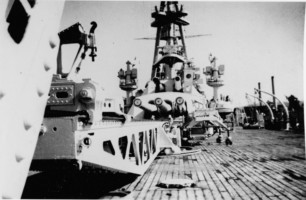

Found another possible location for a raft. These photos were taken aboard Nevada on Sept. 9, 1941. There is a raft stowed on the casemate bulkhead on the starboard side in between the first and second casemate guns.
I highlighted the location of that raft in this pic.

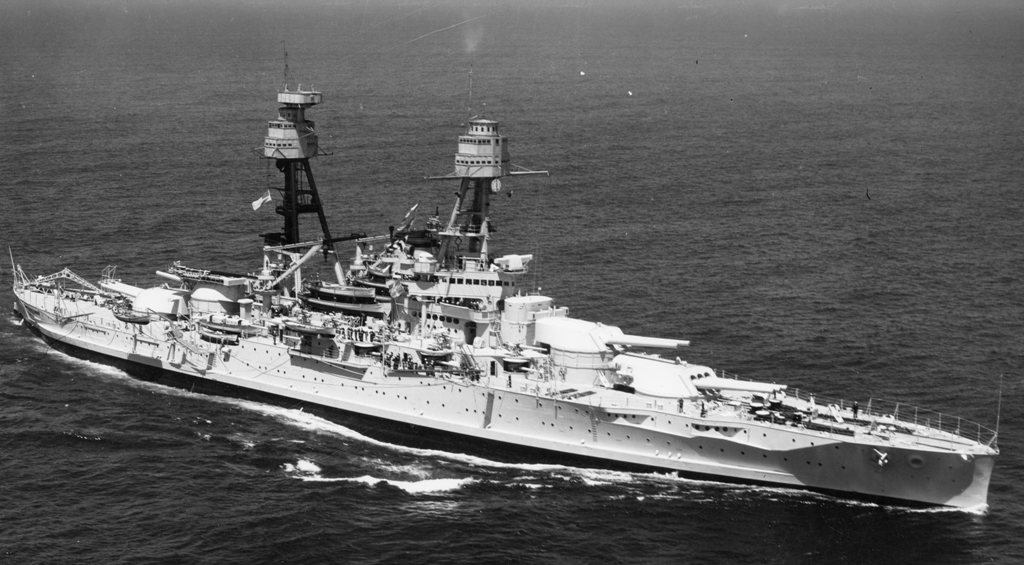

Before I jump into USS Oklahoma's rafts, thought I'd post these pics of her. Not many pics of her with black mainmast legs. Anyone know what year she was like this?
Posts: 8543
Re: Calling all USS Nevada class (BB-36) fans
This photo of Nevada is dated August 1935, also with the black on the main mast legs.
I think that photo of Okie dates from 1936.

Jeff Sharp wrote:Anyone know what year she was like this?
According my sources this is 80-G-466164 with a recorded date of 10/16/1936 transiting the Panama Canal after rescuing American nationals during the Spanish Civil War. You can just make out an American flag painted on Turret 2.
What's interesting about this image is she does not carry any 36" Searchlights. The funnel platform is empty and she still mounts 4 .50cal MG's on the Mainmast Cloverleaf but yet had them on the funnel at Gibraltar in the previous August.
This picture is dated 1937 and I believe it to show the black legs of the mainmast
