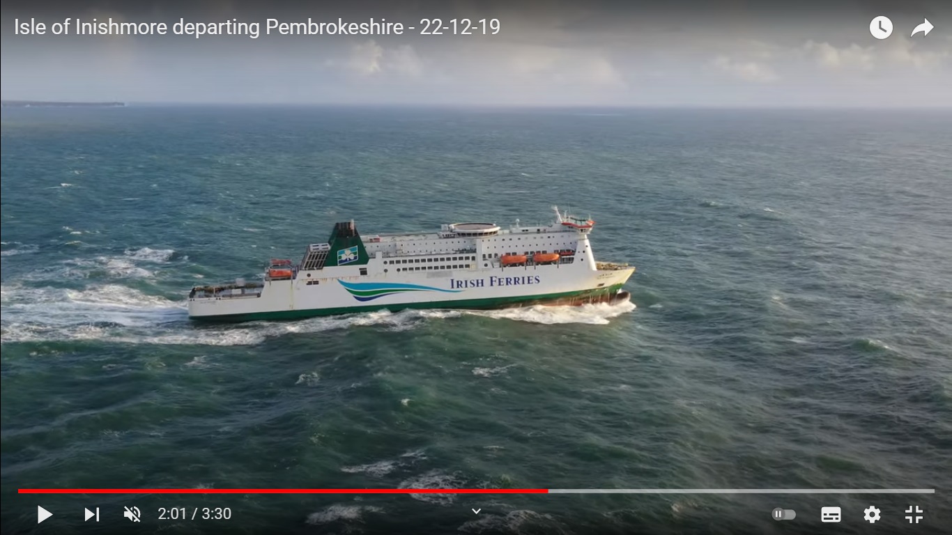

Thanks again to SargentX for taking the time to share all his methods. Model water that would genuinely fool you and raises the ship models to a whole new level. Very helpful indeed to know how it was done from scratch.
An potentially useful reference video I came across on Youtube showing the Irish Ferries ferry Isle of Inishmore departing Milford Haven Estuary on her way from Pembroke Dock in Wales to Rosslare in Ireland:
https://www.youtube.com/watch?v=gW4JQ9LZtX8&t=146s
It is filmed from a headland and the image is lovely and crisp and clear. The majority of it is in bright sunshine too which gives lovely rich colours in the sea. Plenty of food for thought as regards wave and wake patterns in a moderate to rough sea state using SargentX's methods.
