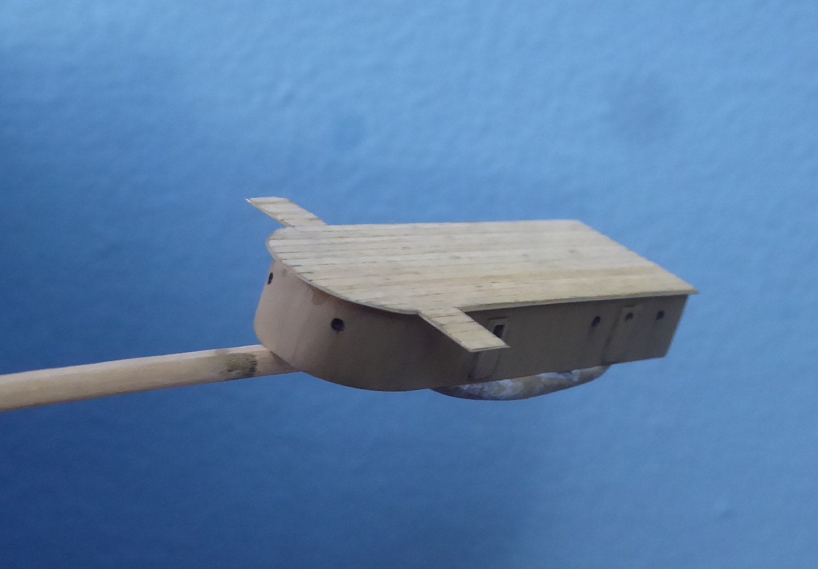

The main superstructure block was united with its overhanging decking ,
painted, drilled for portholes and lightly weathered.

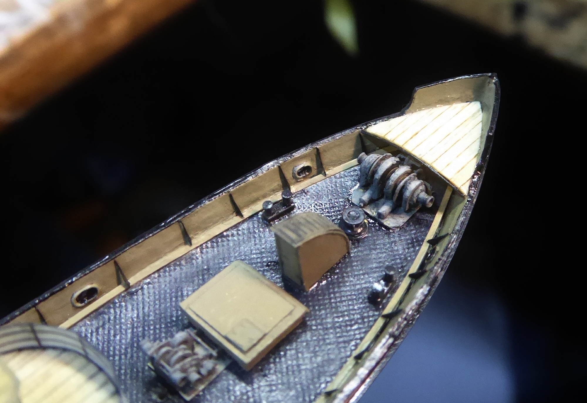

Rather a lot of time was expended on making a feasible simulation of the steam
windlass-winch situated at the fwd face of the of the mast
(based on the partially obscured side view on the builders model..)
I used a piece of PE scrap as the baseplate, the windlass side upright cheeks were cut / filed from brass strip
the waisted drums were simulated by using small diameter
brass tube and wire ringlets to give impression of both hollow and flare of winch drums.

Excellent Work Mr Baumann! the winch is superb and the metallic deck outstanding: great idea to use that wrapping.
Questions:
- Did you separate the aluminium layer of the wrapping from the paper or just glued the ensamble on the deck?
- White glue technique for the window glasses of the wheelhouse? Whatever the technique, what an amazing result you achieved!

>> Did you separate the aluminium layer of the wrapping from the paper or just glued the ensemble on the deck? <<
no splitting the paper from the very very thin foil --it is quite fragile.
Next time I would glue the ' butter-paper' to a stiffish card or styrene deck first before install to ship model rather than direct glue to the deck ...........................................................................................................................................................................................................
yes-- thinned 50/50 white glue-- I feel that completely clear windows 350 smaller than the real thing can look a bit gawky!

the Fwd steam anchor windlass...
I have only an oblique photo of it on the builders model -- but enough to --sort of--determine its type--
horizontal twin cylinders aft of the windlass--
==>The 2 x photos of the real ship allow no information to be gleaned from....
after a lot of checking images of real steam winches this is sort of what I think it would have looked like
It is made of pieces of nickel silver sheet and brass etc cut and filed to shape.
and took --relatively-- a stupid amount of time ! :thinking:

The fwd anchor windlass has been installed , the stairs to bridge wings have been made and fitted,
as well as the fiddly stair handrails -
