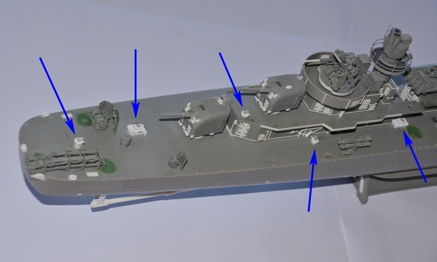

Hi all again.
This week was hatch week for the second week in a row, this time the rest of the six types that Fletchers seemed to display. Very easy and entertaining to build, using only some Evergeen scraps and generic PE hand wheels. As all of the round hatches seemed to be similar in width, I standarized them to 4.8 mm. Evergreen tube.
With all these new elements placed in position, the fantail looks way better:
Over to the next post,
Willie.[/size]
Willie
Posts: 690
Location: Vigo, Spain
Post by Willie »
After this, I thought it would be advisable to set the whole hatch set in place to check that they matched their final positions all over the different decks, so I put together around them the main sections all along the ship.
With this this thing starts looking like a true Fletcher class, with the only drawback that none of these sections is complete yet, small details to be added here, there and everywhere.
I hope you like it anyhow, and very best regards from this side of the oceans,
Willie.[/size]
