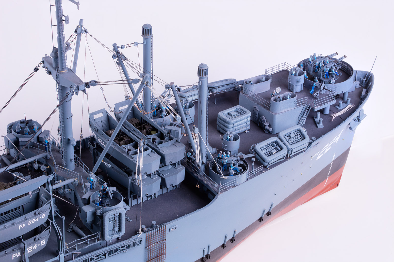

Bow of the Randall, APA 224. For those of you who haven't followed this project the hull is a traditional balsa strips over plywood framing except for center section from thin plywood over frames. Boat and superstructure decks from 1/16" plexiglass, Masts from Brass tube and uppers from turned aluminum, booms from wooden bowls, Gravity Davits, Strathmore paper wood beams and styrene, LCVP's 3D printed, LCM's and command boats carved basswood, all cargo vehicles, 3D printed, crew 3D printed, all deck weapons 3 D Printed, tubs and bulwarks, strathmore paper, all inclined ladders 3D printed.
This all reflects some changes in modeling technology, initially all the weapons and LCVP's were hand made.

Tom,
Looking quite excellent, as usual!! The crew is 1st class!!

Some "first class" and Chiefs, but mostly wartime E-3's....
