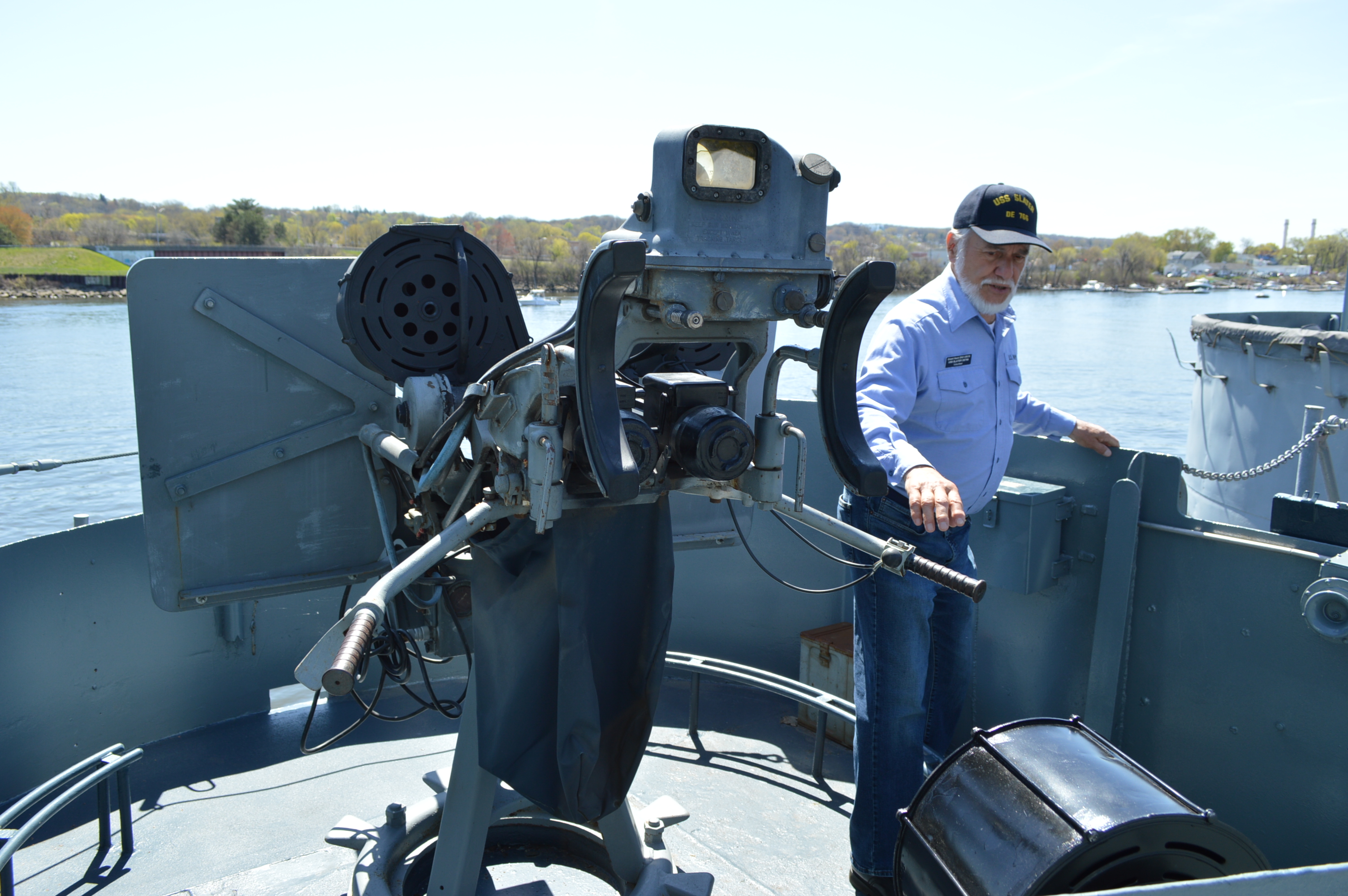

A whole whack of pages ago, (+100) there was some discussion about the elevated 'rings' that were on the pedestals of the 20mm mounts. And it was shown that they were for the gunners feet, to really get 'elevation' and such.
My point being, was watching a National Geographic show the other night, about 'Hero Ships' and specifically the LST episode. They had a few REALLY good shots of those rings, but they weren't just 'round' they were 'segmented' quite like a bearing retainer ring.
I'm not doing the description much justice, but it truly showed the adaptation of the ring and it's progression through the WWII boats and such. If I was any gooder at this, I'd be able to figure out how to put up a still from that show, but anyways.
Posts: 8544
Here's the rings on the museum ship USS Slater
Posts: 5068
Post by Fliger747 »
The 20 MM on the battleships mostly had an elevating wheel which would obviate a need for the foot rings. Never say never, but I don't think the modern BB's had them, whereas I am sure that the LSM' and a lot of the amphibious types did. Not to my knowledge did the ARL's have them. Slater was a DE and was probably less lavishly equipped. And of course I could be wrong!
The "whodidz" always make for a good discussion.Cheers: Tom
