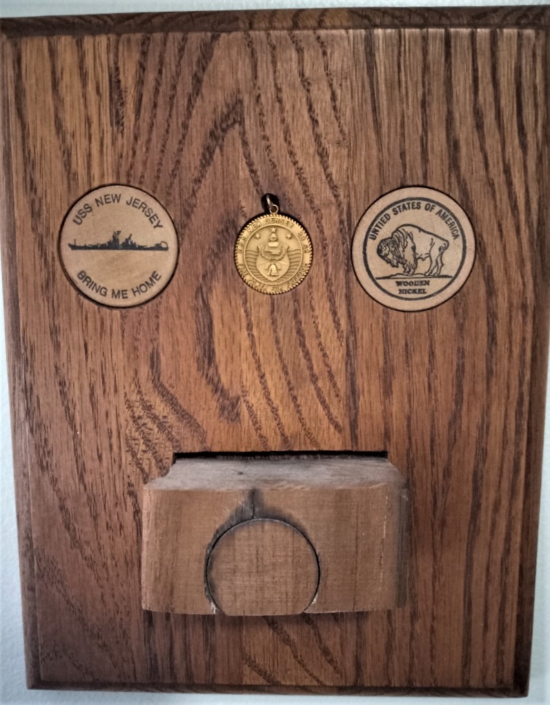

The wooden deck ends just forward of the #1 6"/47 turret as shown on the model. The deck was 2 inch thick teak planks 4 inches wide laid directly onto the metal deck plates (with a water seal between the wood and metal). Around the edges of the wood were 2 inch high steel borders 3/8 inch thick that were welded to the steel deck plates.
Short threaded rods were welded to the deck. The deck planks had holes to fit over the rods. The holes were counter sunk 1 inch deep to allow nuts and washers to be threaded onto the rods and tightened. The space around the nuts was filled with white lead and a teak plug was driven into the hole above the nuts. The teak plugs were oriented so the grain matched the grain of the deck planks.
After WWII when six of the Clevelands were converted to missile cruisers the new deck planking was a laminate of 1 inch of teak glued to 1 inch of Douglas fir. I do not know if this laminate planking was used on any of the ships during WWII.

Just to illustrate DrPR's description of the teak deck & plug, here is a shot of a small portion of teak decking that was removed from USS NEW JERSEY (BB-62) in the process of mothballing her in 1990. Decking removed was stored for future donation to the ship's crew. At the annual ship's reunion in 1991, those attending the banquet dinner received a plug of the ship's teak deck. I mounted mine on an oak board with a couple other BB tokens -
This particular piece does have one of the plugs described but is not a full 4" wide section as a small piece of it is missing. However, it does show exactly how the deck looks once installed. Here is a shot of teak being installed on NEW JERSEY a few years ago when the ship's deck renewal project (as a museum ship) was in progress -
