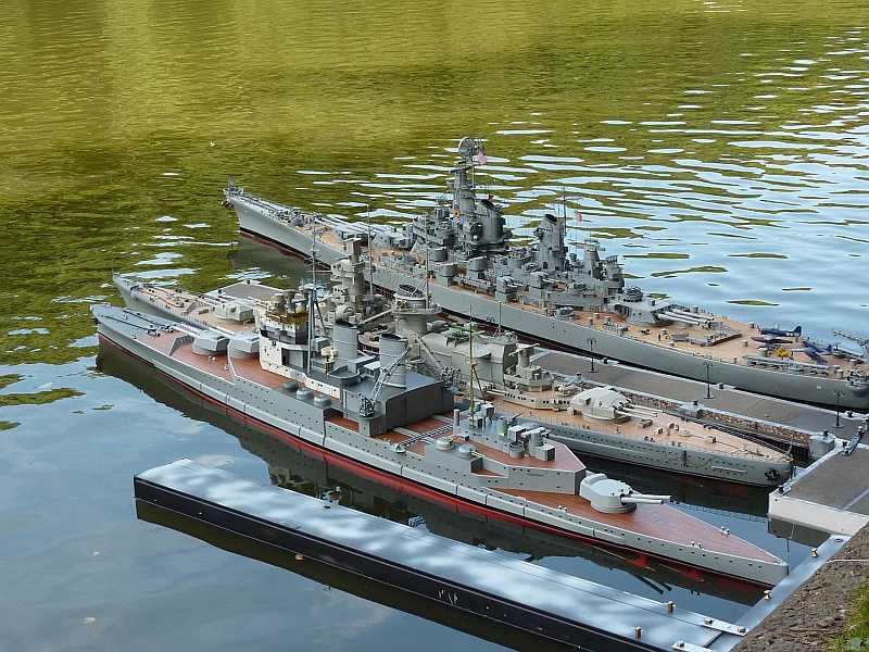

Dear friends,
here are some pics from yesterdays meeting in Witten.
Its been very fine weather, almost 30 models had been on display or water.
No losses, no collisions, everything was fine.

Dear friends,
last Sunday there was a big event at ship modelling club of Heuchelheim: the launch of KMS Graf Zeppelin.
Renown was witness from close by, see the pictures below.
Best regards from Wetzlar!
