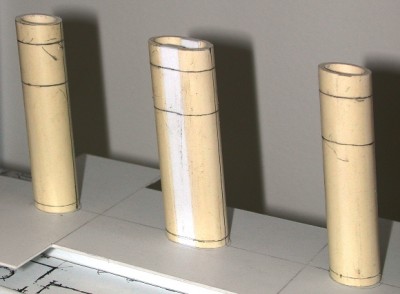

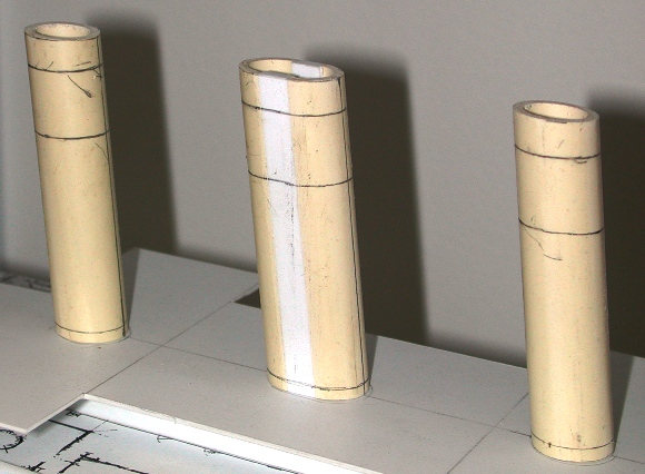

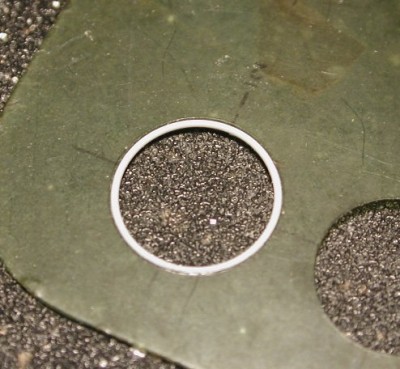

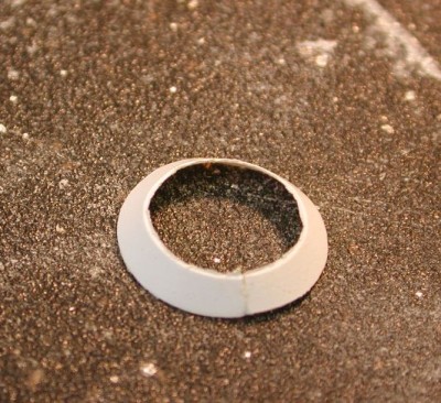

Perhaps the most distinguishing feature of the County Class were their three raked funnels.. The forward and aft funnels were both circular in plan while the center funnel had semi-circular fore and aft ends with a straight center section making it approximately twice the area in footprint of the other two. I was able to find cpvc plumbing pipe of the proper diameter and cutting the pipe at the proper angle - 8 degrees from the vertical � and length for the fore and aft funnels was quickly done. The middle funnel was somewhat more difficult in that a couple of lengths of pipe had to first be cut in half longitudinally and then joined in the middle with two straight sections. The basic forms of the funnels were thus completed some time back.

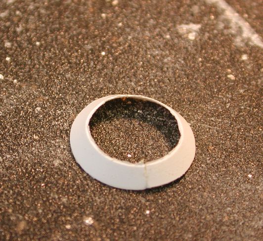

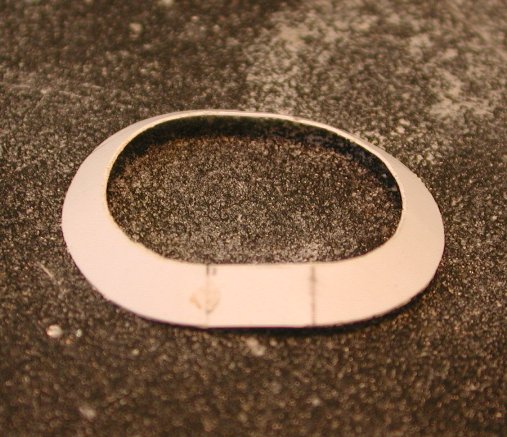

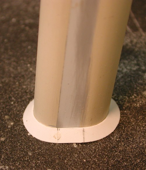

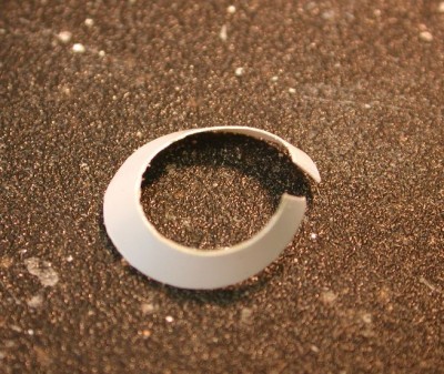

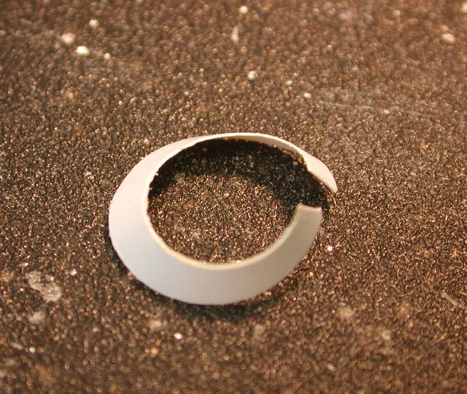

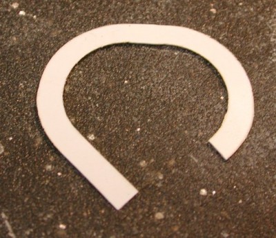

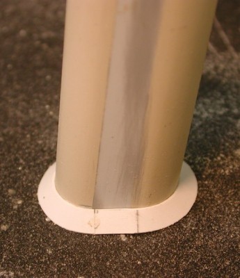

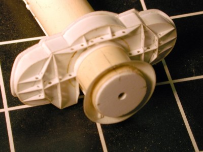

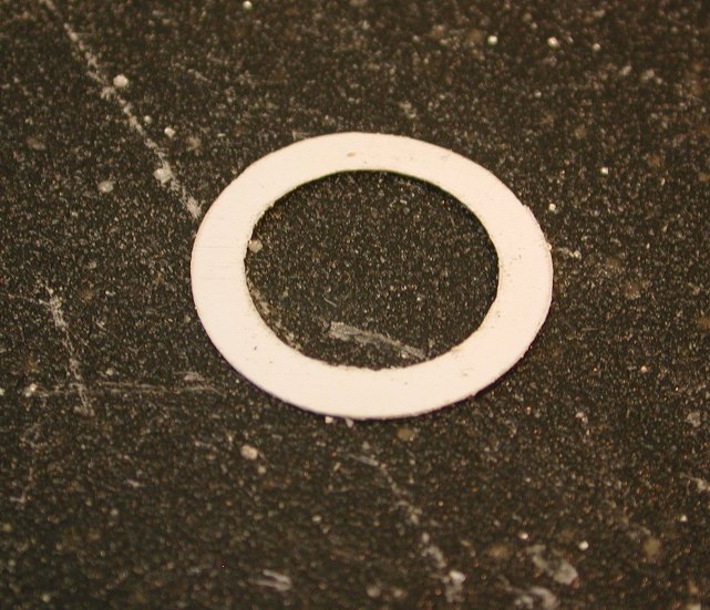

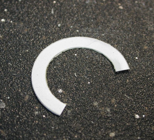

At the tops and bottoms of each circular funnel tube is sloped circular cap and skirt. These are basically truncated conical forms cut from thin (.010 inch) plastic sheet using a pair of dividers with very sharp points. There is an excellent diagram that shows how to calculate the proper radii in Scale Model Warships edited by John Bowen, and once you see how its done it becomes fairly easy. Some of the steps in construction the skirt are shown below:

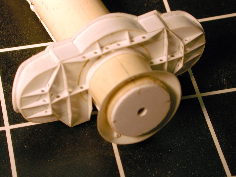

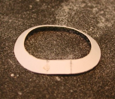

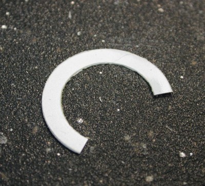

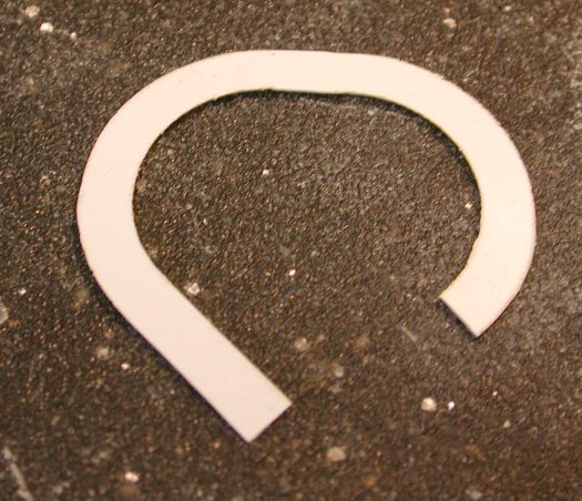

The skirt for the center funnel is somewhat more complicated but the basic steps are the same:

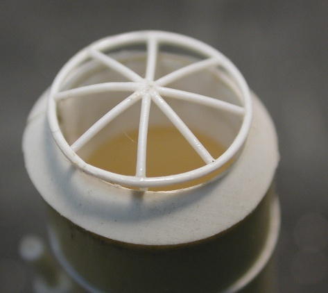

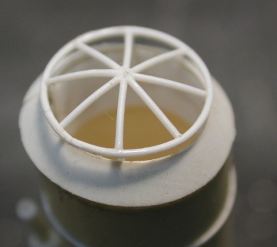

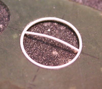

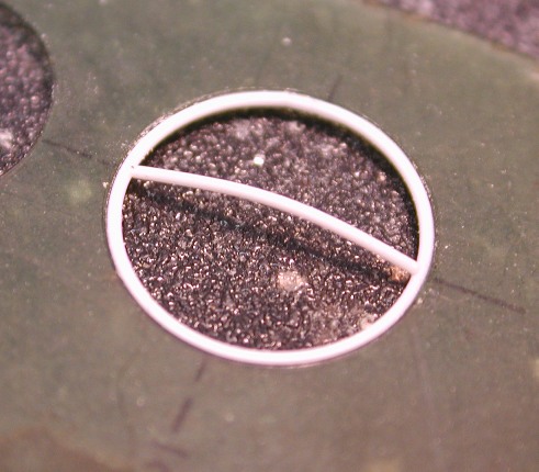

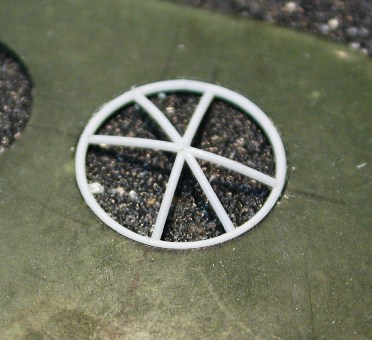

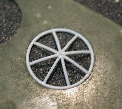

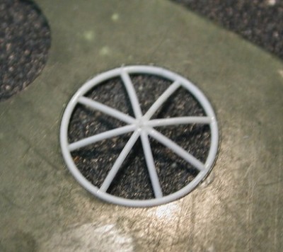

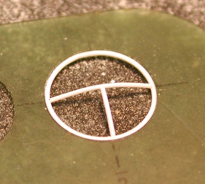

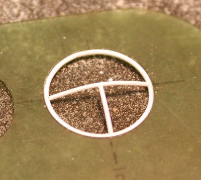

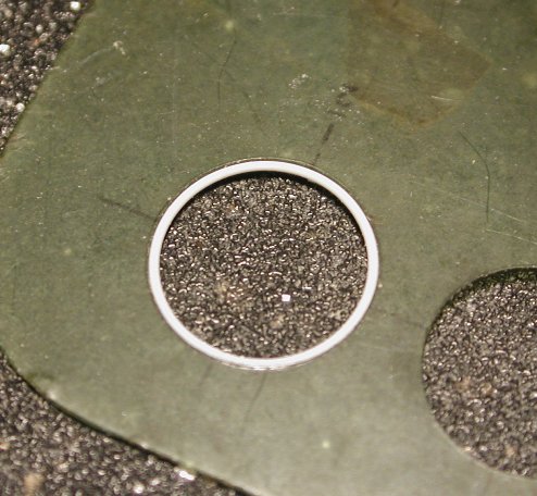

The funnel caps are also conical sections, made just like the skirts, of a slightly smaller size. Atop each funnel cap is a pipe framework used for supporting a canvas cover to protect the funnel opening when the ship is laid up or the engineering plant is down for any length of time. The first step in making this is to construct a circular frame of the proper diameter. To do this I used an old circle template used for drafting in the days before computers. I cut a piece of .020 inch diameter plastic rod to fit inside the circle and then lightly applied liquid cement to the joint.
I then laid the first curved piece across the frame and gradually added the other frames radially until all eight were in place. I then supplemented the liquid cement with small drops of cyano on the underside of all the joints and let everything dry thoroughly.
The completed frame is then attached on small tabs which raise it slight above the rim of the funnel cap. Its probably a bit on the heavy side, but attempts using smaller diameter plastic were not successful and I do not have the soldering skills to fabricate it from wire.

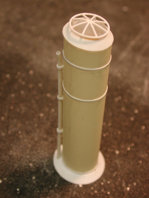

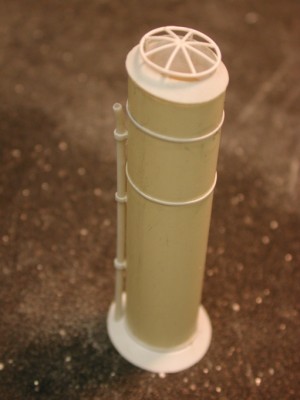

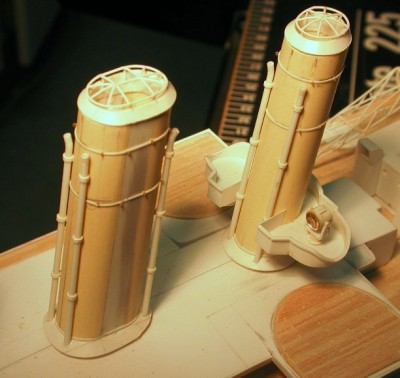

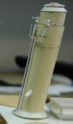

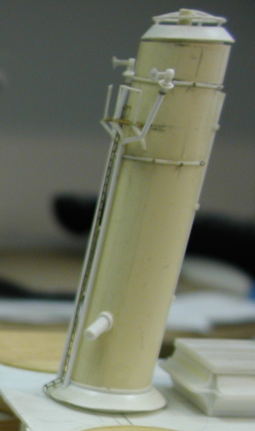

Below is a photo of the fore funnel with skirt, cap, band and steam pipe fitted.
The next photo shows the completed funnel cap with the framing in place. You can also see the four steam pipes in place as well as small brass eyelets (a model railroad product) for the guy wires.
The fore funnel has several unique features, the most noticeable being the ship�s horns with associated piping, access platforms and ladder. The fore funnel also contains the galley stack, which enters the funnel near the base on the port side and extends up the interior of the funnel and through the cap. The horns themselves are another railroad item while the rest is made from various bits of plastic rod, tubing and photoetch.

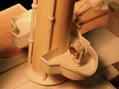

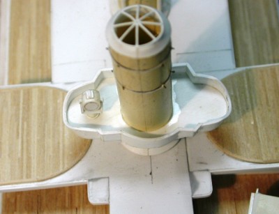

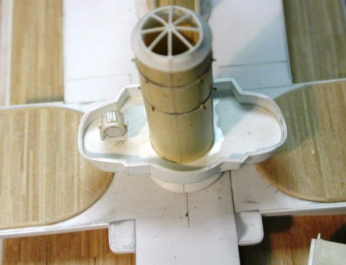

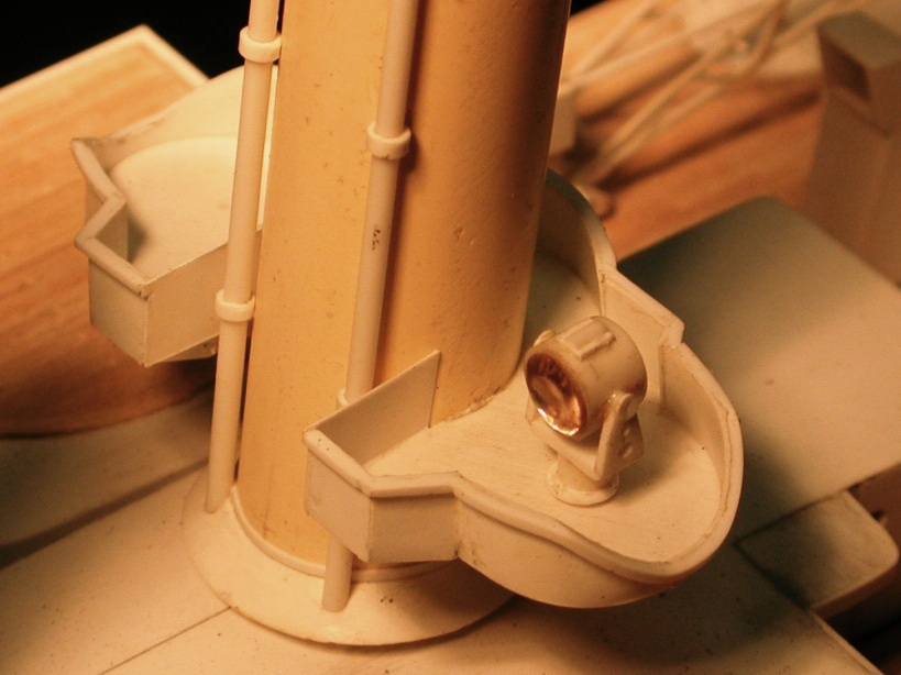

I've been working on the raised searchlight platform that surrounds the after funnel and the 36" searchlights. Here's the progress so far:
Construction is basically a matter of cutting the floor to the proper shape and then cutting and fitting the straight and curved side pieces. The photo below shows the support structure supprting the plattform.
Not a great deal to look at, but it represents more than a few hours of work.
Last edited by Steve Sobieralski on Sat Aug 16, 2025 10:51 pm, edited 2 times in total.
