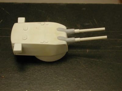

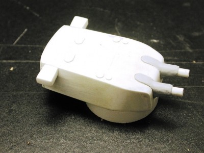

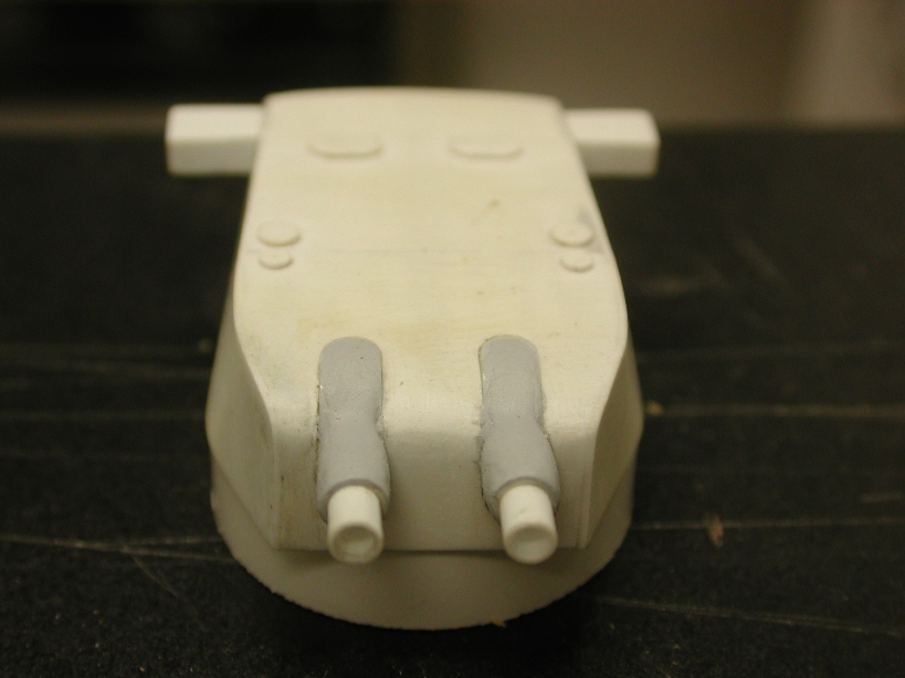

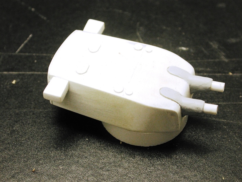

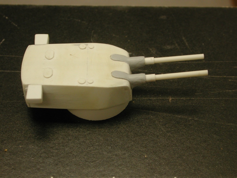

Building the model had actually already commenced with the construction of one of the main gun turrets. The intent was to make a master which will be used to form a mold and cast four turrets in resin. I have never done any casting before so this should an interesting learning experience.
My usual construction method utilizes Evergreen sheet styrene plastic of various thicknesses along with their wide variety of other rectangular, angular and tubular shapes. The pieces of plastic are typically joined by bringing them in contact with each other and then applying Ambroid ProWeld liquid cement with a small paint brush. Capillary action pulls the glue from the brush to the joint between the pieces and a welded bond results. At times I also utilize a gel-type cement, made by the German company Faller, which comes in a plastic squeeze bottle with an applicator tip of very small diameter stainless steel tubing, allowing excellent control of the amount applied.

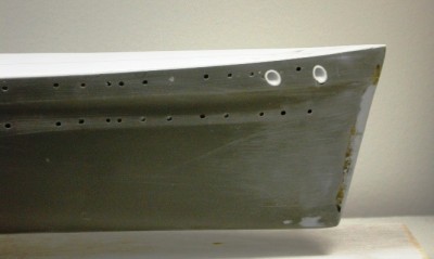

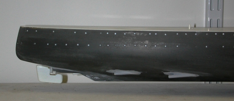

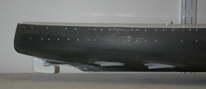

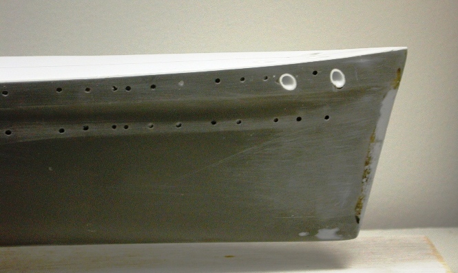

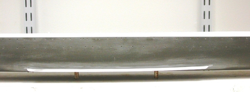

The fiberglass hull, as supplied with the semi-kit, had a smooth skin with no plating detail or portholes, only raised hawse pipe lips. The overall shape, however, matched the plans and the bow knuckle was nicely done. The first step, even though the hull was over ten years old, was to wash it thoroughly to remove any latent mold release agent that might be present.
The next task was to mark out the location of the portholes. I did this by taping a copy of the outboard hull profile to the hull and marking the centers of the portholes with the sharp point of a drafting compass. Once this was done on both sides, I drilled out the portholes using a pinvise and, several hand cramps later (there were a lot of portholes in a County hull), this was complete.
Before adding the deck I epoxied in a piece of bass wood along the interior hull centerline to serve as blocking for screws to secure the hull to a stand. Rectangular plastic deck beams were cemented at about 2� intervals across the hull and along the inside of the hull perimeter. .030� sheet plastic decking was then glued on to the beams, allowed to dry and then trimmed at the hull edge. The hull was thereby permanently sealed (no chance of any RC gear going in there now).
Using the plans as a guide, I next drilled three holes through the deck and hull for the hawse pipes. Evergreen tubing, sized to fit the holes was then inserted and super-glued in. After the glue set the tubing was trimmed flush with the deck and hull.
I then located and drilled four holes in the stern for the shaft tubes and installed them. The rudder was cut to shape from sheet plastic per the plan, the edges rounded and a rudder shaft tube added.
The bilge keels were made using thin rectangular plastic strips. To obtain the taper (most bilge keels are shaped like the trailing edge of an airplane wing in section with the broad edge attached to the hull) I clamped a pair of scissors in a vise with the blades open to a very slight angle. I then drew the plastic strips through the open scissor blades, gradually shaving off material until one edge of the strip was appropriately thin. They were then cut to size, the ends shaped and super-glued to the hull.

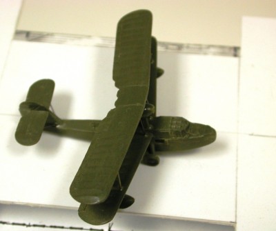

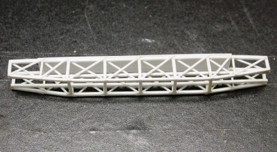

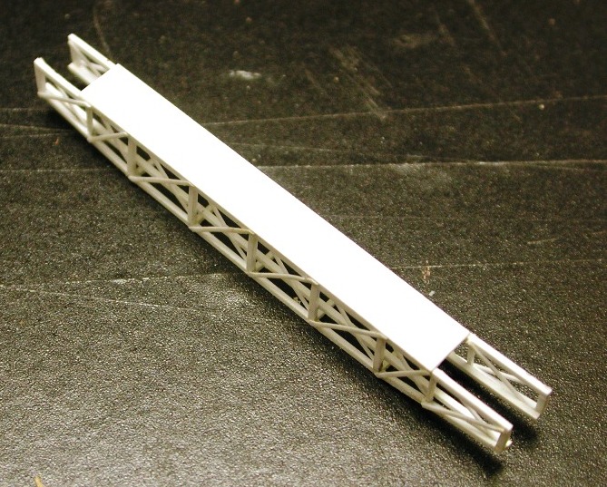

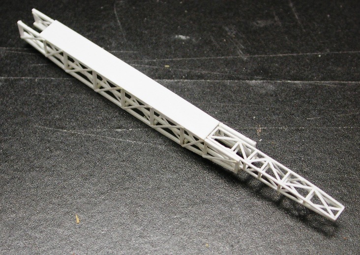

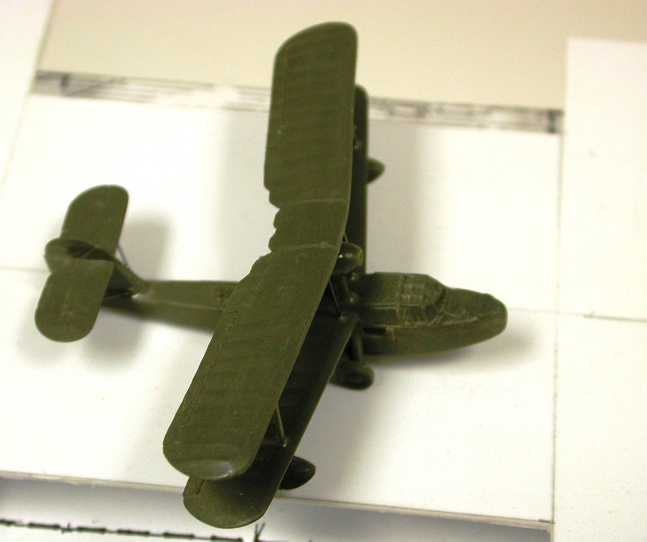

Having gotten at least some of the more tedious of the hull details underway, I wanted to get a start on some topside details. I decided to start with the aircraft catapult atop which eventually sit one of the very nice 1/200 Supermarine Walrus models which I obtained from Ron Crawford several years ago.

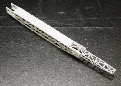

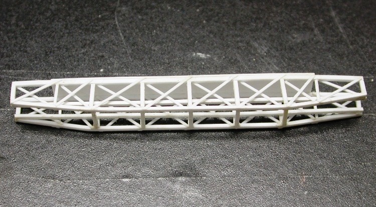

I really enjoy building trussed structures for ships, such as catapults and cranes. The basic technique is very similar to building a balsa airplane kit- lay the main members down on the plan, cut intermediate members to fit and glue. It is also an effective lesson in practical engineering as it is quite amazing how rigid and strong these little structures become once all the triangulating struts are in place.
The catapult carried aboard Dorsetshire consisted of a central section which rotated on a turntable that sat atop the torpedo workshop. Two other sections that extended for aircraft launch telescoped into both ends of the central section. All was fairly well detailed on the plans and I soon had the basic structure of the central section and one of the telescoping ends complete.
I was somewhat disturbed, however, by the fact that there were some obvious discrepancies when I compared what I had constructed per the plans with the photo of the catapult below. Then I realized the problem, I had forgotten that the Dorsetshire had been equipped with a heavier catapult to handle the Walrus in 1937 and I was building the original catapult built for the much light Fairey biplanes with which she was originally equipped.
Well, fortunately not too much time and material wasted and (hopefully) a lesson learned.

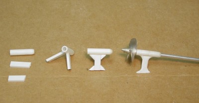

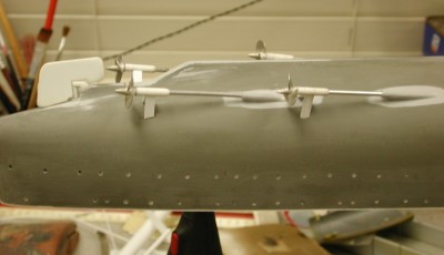

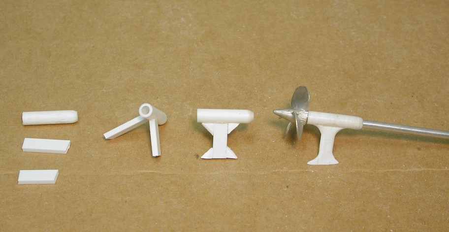

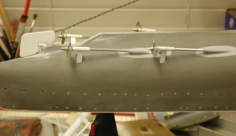

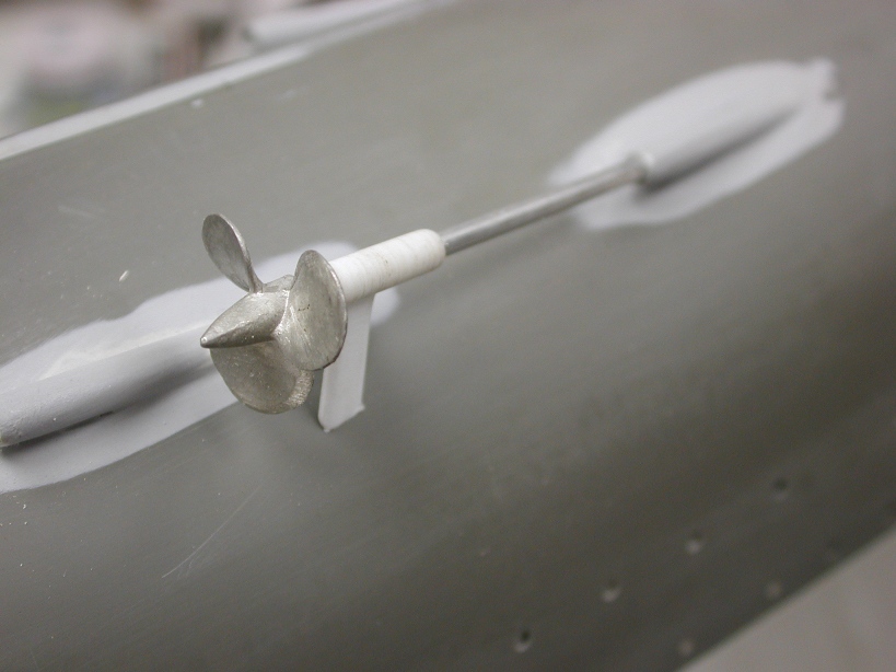

For me, the making and fitting of propeller shafts and brackets is one of the more challenging tasks in scratch building a ship model. The exact configurations and locations of the various components are often not very well defined by your average set of plans, and it is usually a matter of cutting and fitting until the proper positions and alignments are obtained. Fortunately, for a static model it is only necessary that these areas basically look right, on a working model, of course, alignments and clearances are very critical.
Using cardboard templates cut to the hull contours to locate the positions of the propeller shafts, I cut and fit the struts for each of the four shaft brackets. The photos below show the shafts with the bracket struts roughly cut for length and angle of attachment to the hull. The propeller shafts are aluminum tubing which is more rigid than the same diameter plastic tubing would be. The propellers are made by Classic Warships as replacements for the plastic items in the Revell 1/72 German S-Boat kit. However, they were originally the propellers for CW�s 1/192 Sims class destroyer kit and they match the diameter of the propellers shown on the Dorsetshire plans. The rudder fitment is also shown. The grey material is Gunze Sanyo �Mr Surfacer�, which I use quite a bit for fairing and to fill minor gaps.
The next photo shows the steps in making the shaft brackets. The bracket tube is plastic sized to match the diameter of the propeller hub and with one end slightly tapered. The struts are then glued to the tube and cut to length and angle to meet the hull. Then small triangular fillets are roughly cut and cemented to the struts were they meet the bracket tube and the hull. Everything is then sanded and filled to shape. I find that a Flex I File is very useful for shaping the curves at the fillet pieces.

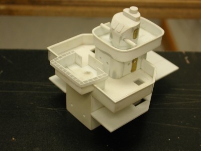

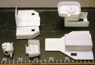

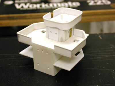

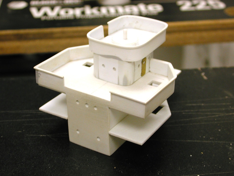

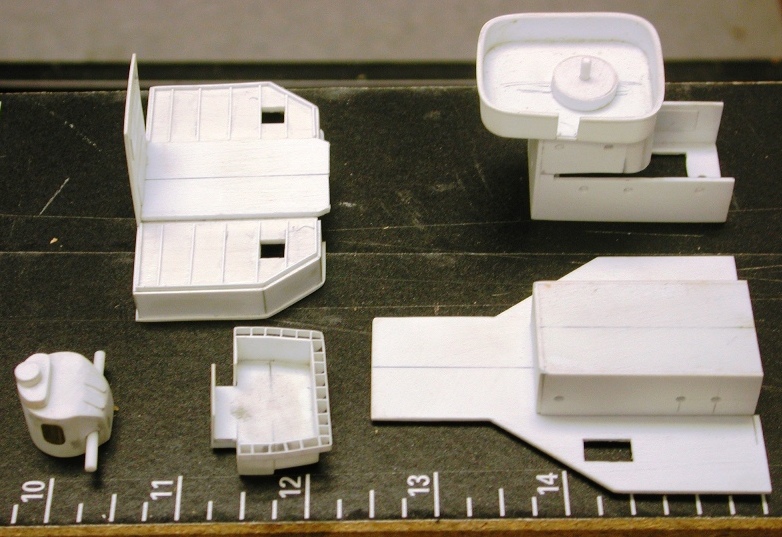

I also have started work on some of the superstructure sub-assemblies, beginning with the bridge. The first photo shows the various subcomponents, including the main battery director and the compass platform with the wind deflector baffles in place. Deck beams have been added to the underside of the upper bridge and rectangular holes cut for inclined ladders. The second photo shows the basic structure assembled and the third shows the director and compass platform in place.
[attachment=0]bridge2.JPG[/attachment
