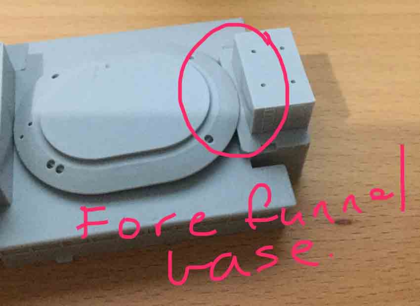

The only problem with the fit in regards to the for funnel sitting on the aft funnel deck house is with the funnel base. This isn't a problem as the aft end of the base can be flattened as it actually sat underneath the walkway that is moulded onto the aft funnel deck house. You could provide an etch walkway and modellers could remove the moulded on one.

You can check out the Trumpy 1/350 Hood to see what I mean regarding the fit of the base of the funnel on the deck house

Here is the base. I took out my AOTS book of the Hood and did some measuring. The Fore funnel is the correct size. Short by .5mm. The aft funnel base is the correct size.

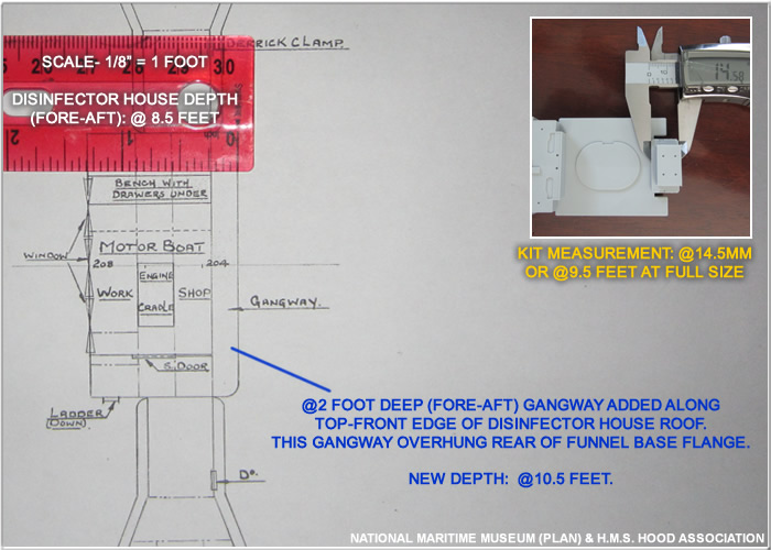

Now that we know the fore funnel dimensions are most correct, lets look at the "deck house" base (M1) of the rear funnel.
We know that it will not accommodate a correct size funnel without filing down the rear of the bottom flange piece (C15). Easy fix for most folks. Those who want it to be precise will probably want to take it a step farther by replicating that it didn't just end, it actually passed under a small walkway. So, lets also take a look at that walkway.
Below is a photo of an official plan. The plan was copied from an original held at Woolwich Arsenal. As you can see, the original front-to-back depth of the Disinfector House (the rectangular structure immediately behind the rear funnel) was @8.5 feet. Ultimately a smaller structure, the Motorboat Workshop, and two searchlight platforms were added in this area. This necessitated the addition of a narrow gangway to the front of the structure. This gangway was about 2 feet deep (Fore-aft) and spanned the entire width of the Disinfector House roof. This was the bit that overhung the funnel base flange.
Per my measurements, the updated depth, fore-aft, of the Disinfector House (including gangway) was about 10.5 feet.
A quick measurement of the model shows this same area as being 14.5mm or 9.6 feet if converted.
Hopefully this will help Pontos with the design of the small gangway.

I was just posting a similar reply in the thread about the funnel error when something occurred to me: both John Roberts and Maurice Northcott drew the two funnel base flanges as being differently shaped from one another. Both men depicted the rear funnel base flange as being rounded at the front, angled at the sides and flat at the rear.
Of course, the official Hood plans aren't 100% precise. They are VERY close of course, but sometimes, things were slightly differently shaped or oriented aboard the actual ship (case in point, the Torpedo Control Platform and rear/centre 4" gun splinter shields. I combine this with the fact that both men are very detail oriented and would not "guess" on the shape of a structure. They would have based their drawings on what was known at that time...and as both men consulted the very same plans that I have, it occurs to me that they might have come across something else (unknown to me) which made them divert from the plans a bit.
So, I shall not second guess my Jedi Masters...this padawan will be asking one or both why they drew the flange as they did.
Of course, this doesn't change the fact that there was still a gangway added to the Disinfector House nor does it change any of the measurements I just provided. It just may affect the shape of part C15. Lets see what they say.

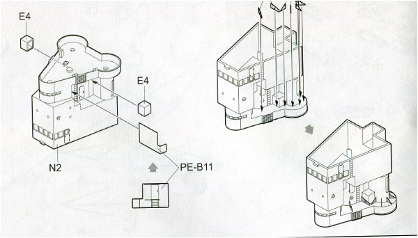

Part N2 has many errors and will definitely require a number of updates. Some of the work will be very easy for the average modeller to handle, but some may need new parts. We'll put some images together and post them here as soon as possible.
For now though, here is a brief list of what to expect:
1. There are too many windows around the top rear of the actual ACP...the kit has "8" little windows, but there were actually only 7. There was a device that hung in front of the centre/rear window and Trumpeter's source drawings appear to have mistook it for a frame
2. This same area of the structure is also not long enough on the port side...it should extend forward a bit more.
3. There was no "double step" between the ACP (top rear) and the large squarish area below. This can especially be seen from starboard). The piece of photoetch (PE-B11) for this area is totally wrong. The other side (port) is also incorrect (though the piece of photoetch used there - PE-B12 - is more accurate than the one from starboard). 4. The large vent on the forward bulkhead of N2 is a bit too small and shaped incorrectly.
5. The splinter shield atop N2 needs to be removed or reduced in some places- first, cut out the squares near the middle (both sides). Second, reduce the height of the splinter shields around the searchlights (and use a small segment of photo etch rail). This is actually easy work, but parts will be needed...signal lockers and mini railings.
6. There is a large angled roof support beam missing (it could be seen, albeit just barely, between the centre of the structure and the ACP area). This may be very difficult to recreate due to its location.
Other, minor things
1. The various liquid tanks attached to the structure could use some better detail (straps, better angled supports). THis is something most modellers could easily do themselves though.
2. The whole structure had rounded edges (modellers can take care of this with some sanding/filing...very minimal work).

Here are the photos we promised you:
The above image is an overview of main changes.
The above image shows the biggest error on part N2- the "double step". There was only one step on the actual ship. Also shown are some other details...such as cutting out the flag locker, cutting out the the archways forward and of course removal of the ladder and door.
This image shows the port side. This side is more accurate than the starboard side, but still needs work. The flag locker needs to be cut out, the step raised and the ACP extended forward. The ladder and door are correct. Of course, the modeler should also hollow out the searchlight doors.
Shown here are the windows to the ACP at the top rear of the structure. There are too many windows...there should only be seven. The kjt also needs a fog/navigation light..
This is a 1938 shot that shows the engine room vent and water tanks. They remained the same until the end. As you can see, the kit's vent is too short, incorrectly configured and under-detailed. The actual vent was taller, had a flat top (with hinged opening), angled grilles (top corners) and a "flange" around the midsection (near the lower part of the grille). Note that the vent and tanks are roughly the same height. Also note the mounting straps, angled underside supports, etc., on the water tanks.
This is a 1940/41 shot showing the forward bulkhead of the ACP (part N2). Note the details, shape of vent, etc.
Another view from 1938. The vent and tanks can be clearly seen.
