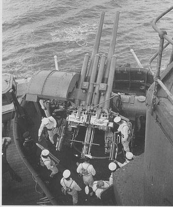

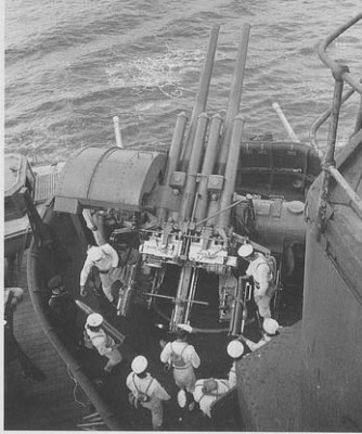

Splinter shields for the 25mm AA were in use at the end of the war. Steel splinter shields for surrounding the emplacement positions was less common, and varied by ship and position.
Yes, the degaussing cable was removed at some point due to ineffectiveness, but there is no clear record when. I tend to believe it wasn;t removed until Takao ended up at Singapore, but I could be wrong. Certainly several ships undergoing extensive refits, along with new construction, did not receive external cables as early as 1943.
Attached are two frames from a Birtish film taken postwar. You can see the shield for the 25mmAA in the 2nd.

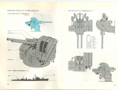

Do you have any illustration of Japanese 5"/40 type 89 mount which indicates the function of the small compartment to the right side of the barrel that has a vertical slot like opening in the back? I am guessing the slot in that compartment is where shells sent up through the hoist emerges to be picked up by the loaders.
- Posts: 9085
I have a drawing from the Gran Prix Shuppan book on IJN DDs. Not sure if it's helpful, though.

The little compartment on the right hand side of the mount is labeled in Japanese, which unfortunately is beyond me. In the photo, the slot in that compartment I referred to where I guessed new rounds of ammunition sent up from the hoist would come out is just to the right of sailor standing next to the loading tray of the right hand side gun.
I also have found no reference to where fuse setting machine located is near the open 5" mount, although ATOS illustrates such a machine in isolation.
